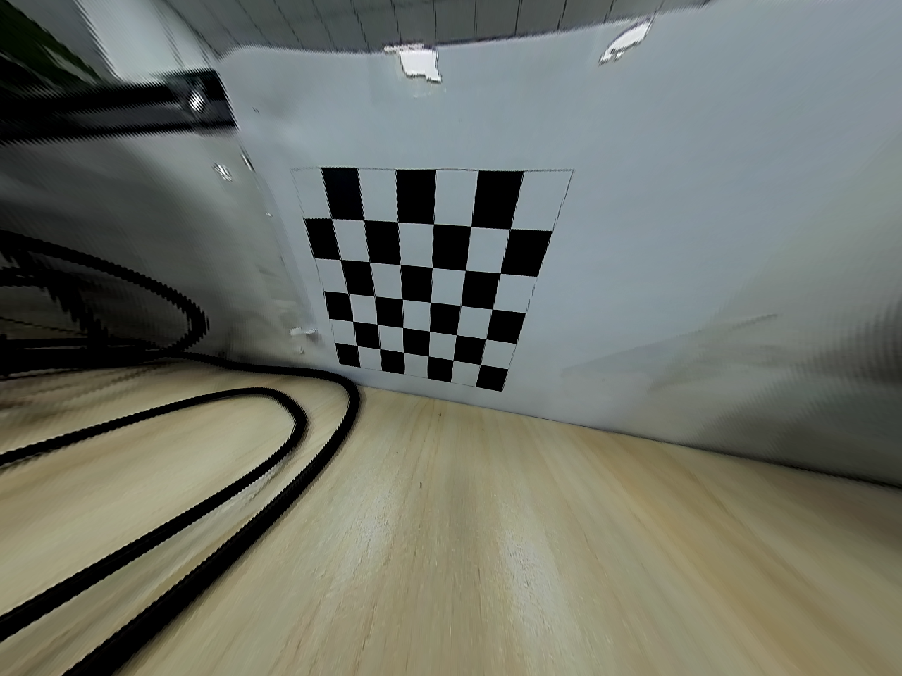

I would like to get some support on LDC tuning. How can I get better distortion correction using LDC LUT.
Input image size is 1280x960, output image size is the same. I want to do distortion correction using LDC LUT.
I have given a distortion function from lens vendors, HFOV>190°, VFOV>135° , focal length = 0.89 mm
, pixel size of sensor = 3μm. I generated mesh lut file using the script below.function ldc
gen_lut('/home/vvn/Documents/ldc_spec.txt', 3/1000, 1.78, 1280, 960, 640, 480, 4, 2);

Origin image:
And then, I imported mesh lut file into dcc tool and used dcc tool to generate ldc table.
Dcc setting:
But I found output image is too bad.
Output image:
Appreciate your guidance here.
