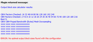

  • Hi Gang,
    1. As you suggested I tried our LUT in DCC tool for I/O resolution 1920x1080. When I set tunning method to semi automatic, I am getting following error.
    Also in sim_error_log file of DCC I am getting following errors
    But I am able to see correct output in tunning output window of DCC tool.
    Why this errors are coming and what it means?

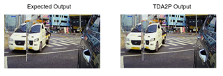

    2. When I run this LUT on board, getting some distortion in output image which was not observed in DCC tool output. Is there any reason for this distortion?
    Pooja
  • Hi Pooja,
    1. It means none of the listed block width/height combinations would work without an error on H/W.
    I am not sure if it is because of your discontinuous mapping (the vertical boundary between the 2 appearance of the same white car) or the zoom-in factor is too large on the right size of that vertical boundary (LDC running out of internal memory while reading its input image block).
    For example, for a 8x8 output image block, the needed input image block is 128x128 with a 16:1 zoom-in factor.
    Could you please share your tuning tool project so that I can check your LUT and I/O images?
    You may send it via email if you cannot upload on E2E.
    2. Tuning tool does simulate the H/W error of running out of internal memory (it just reports an error message and give a good output image).
    The distortion (too small to see clearly in your image) on H/W should be coming from LDC running out of internal memory.
    Gang

  • Hi Pooja,
    The mapping you defined in your mesh LUT is not continuous.
    Most of the 1080P output image is unchanged from input image (copy from input to output directly).
    Only a rectangular area from (X=439, Y=139) on top-left is changed from input image.
    On the top/left/bottom sides of that output rectangle, the spatial mapping is discontinuous, i.e., 2 neighboring output pixels are very far apart in input image.
    This kind of discontinuity will cause LDC to run out of its internal memory, because the discontinuous boundary goes inside some LDC output blocks.
    In general, we shall not use discontinuous mapping with LDC.
    1. Is this discontinuous mapping an experiment or your actual desired mapping?
    Because the output image looks very weird with this discontinuous mapping (the white car is repeated), I suspect it might be just an experiment and you don't need to worry about the artifacts from running out of LDC internal memory (i.e., you may move on to work on your actual desired mapping that is continuous).
    2. If you want to fix the artifacts for this discontinuous mapping, then you may try the following:
    - re-define your output rectangle area to align with your output block size.
    E.g., if your output block size is 32x20, then move your rectangle to be aligned with the block size, e.g., from (X=439, Y=139) to (X=440, Y=140).
    In this way, LDC output blocks are aligned with changed area and won't require huge input block size because of the discontinuity.
    That is, the changed rectangle must be covered exactly by output blocks (no boundary crossing).
    - generate a new mesh LUT
    - use tuning tool with the new mesh LUT to test
    Please note that if you want to change your output block size again, you may have to repeat the above 2 steps so that the changed rectangle is still covered exactly by the output blocks.
    Gang
