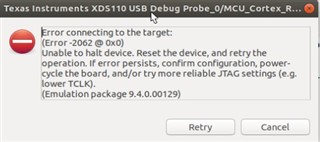

My customer reports a issue in booting mcu2_1 from SBL. I try with below steps and fail too.
      1. build can_profile_app_tirtos_mcu2_1_release
      2. boot through launch.js script with sciserver_testapp loaded on mcu1_0, then load can_profile_app_tirtos_mcu2_1_release.xer5f to mcu2_1 in CCS
      3. run mcu1_0 and mcu2_1, log is printed on MCU_UART and MAIN_UART, indicating both mcu1_0 and mcu2_1 work well
      4. use MulticoreImageGen to generate combined image of mcu1_0 and mcu2_1 as below
             ./MulticoreImageGen LE 55 app 4 sciserver_testapp_tirtos_mcu1_0_release.rprc 7 can_profile_app_tirtos_mcu2_1_release.rprc
      5. copy SBL TIFS and above app to SD card and boot from this SD card
      6. log from MCU UART displays SBL and TIFS information, but no more log about sciserver_testapp. And there is no log from MAIN UART
      7. at this time, try to connect to mcu1_0 or mcu2_1, but fail as shown below
Please help to check the steps and analyze the possible reasons. Thanks.

    Yes, I have tried with can_profile_app_tirtos_mcu2_1_release.appimage, it can be booted normally. But, if using can_profile_app_tirtos_mcu2_1_release.rprc to generate app by MulticoreImageGen, it can NOT be booted normally.
    Meanwhile, while booting with can_profile_app_tirtos_mcu2_1_release.appimage, I got below log from MCU UART. It seems code for 3 cores were included in can_profile_app_tirtos_mcu2_1_release.appimage. Please help to clarify. Thanks.

    The result of my experiments seems it is impossible. And there is description in TRM says "The only restriction is that CPU0 must be in a higher power/reset state than CPU1. For instance, CPU1 cannot be out of reset if CPU0 is not." and "When operating in split mode, CPU0 must be in a higher power/reset state than CPU1."
    So please help to confirm whether my customer's target use case is possible. And please help to descript in more details on how to understand "CPU0 must be in a higher power/reset state than CPU1".
    Below are result of my experiments and my speculation. Please help to share your comments. Thanks.
          1. copy can_profile_app_tirtos_mcu2_1_release.appimage(with SBL and TIFS) to SD card, mcu2_1 can be booted normally. But log from MCU UART shows 3 cores are booted, there are mcu1_0(coreid=4), mcu2_0(coreid=6) and mcu2_1(coreid=7). appimage format boots both mcu2_0 and mcu2_1, it is not "load image to mcu2_1 without loading image to mcu2_0"
          2. use sciserver_testapp_tirtos_mcu1_0_release.rprc and can_profile_app_tirtos_mcu2_1_release.rprc to generate multi core image, the command used is "./MulticoreImageGen LE 55 app 4 sciserver_testapp_tirtos_mcu1_0_release.rprc 7 can_profile_app_tirtos_mcu2_1_release.rprc", then copy the generated multi core image(with SBL and TIFS) to SD card, mcu2_1 can not be booted normally

    Yes, that's correct understanding. CPU1 cannot be out of reset if CPI0 is not..
