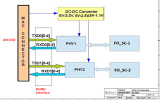

Hello Sir,
I was using dual "BCM54616S" Broadcom 10/100/1000 Phy chip with the copper interface with AM335x based controller.
Trying to migrate from Broadcom Copper PHY chip to a TI DP83869 Phy chip 100BASE-FX Fiber. For the same, I have made changes in U-Boot, Linux Kernel and DTB
We had issues in U-BOOT. The issues in U-Boot solved, when changed the Mask (DP83869_STRAP_OP_MODE_MASK) defined as follows. Now TFTP works well in U-BOOT
- #define DP83869_STRAP_OP_MODE_MASK             GENMASK(2, 0)
+ #define DP83869_STRAP_OP_MODE_MASK             GENMASK(11, 9)
- dp83869->mode = (u16) (val & DP83869_STRAP_OP_MODE_MASK);
+ dp83869->mode = (u16) ((val & DP83869_STRAP_OP_MODE_MASK) >> 9);
The mode set in strap is 'DP83869_RGMII_100_BASE'. When the proper mode got saved to variable 'dp83869->mode' , the issue solved.
Currently we are facing issue in Linux Kernel (Kernel Version : 4.14.67).  Network is not up with the new driver module (DP83869). Following error is coming in Boot-up log.
Configuring network interfaces... [    9.118604] net eth0: initializing cpsw ver
sion 1.12 (0)
[    9.127120] libphy: PHY 4a101000.mdio:02 not found
[    9.131950] net eth0: phy "4a101000.mdio:02" not found on slave 0, err -19
[    9.148662] IPv6: ADDRCONF(NETDEV_UP): eth0: link is not ready
PHY Address set in strap:
Eth0 : 10
Eth1 : 11
This is a similar issue as in following Question
e2e.ti.com/.../linux-am335x-ethernet-not-getting-up
I could find the following patch  to resolve this issue. But unfortunately our mode is 'DUAL EMAC'
github.com/.../0001-cpsw-search-for-phy.patch
When applies the above patch, kernel panic is happening. Following is the boot-up log. I think the issue is happening when trying to configure second interface.
Configuring network interfaces... [   22.024828] net eth0: initializing cpsw ver
sion 1.12 (0)
[   22.073167] TI DP83869 4a101000.mdio:0a: attached PHY driver [TI DP83869] (mi
i_bus:phy_addr=4a101000.mdio:0a, irq=POLL)
[   22.084071] Unable to handle kernel NULL pointer dereference at virtual addre
ss 00000000
[   22.092202] pgd = c0004000
[   22.104651] IPv6: ADDRCONF(NETDEV_UP): eth0: link is not ready
[   22.111977] [00000000] *pgd=00000000
[   22.132476] Internal error: Oops: 80000007 [#1] PREEMPT ARM
[   22.138107] Modules linked in:
Appreciate if anyone can share patch/ solution to address this issue in AM335X DUAL MAC Mode.

  • Hi Sir,
    Thank you for your reply.
    The PHY Address read from Strap is happening properly in U-BOOT and TFTP module is working fine in U-BOOT. But in Kernel, link is not up with DP83869 PHY.
    Attaching Boot up Log, Hardware Tree, Driver Module  for reference.
