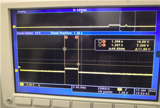

I find J7200_EVM initialization takes 40ms with 8.1 SDK run on OSPI,which is greater than 20ms. The test method and result show as blew:
Modify sbl_main.c as blew, add WKUP_GPIO0_5 with output mode and set output low before init DDR and set output high after DDR initialization. The time taken to capture pin changes with an oscilloscope is the time spent on DDR initialization.

Thanks for all the detailed information. I will check internally on this & get back to you by next week.
