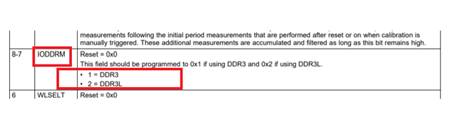

2) which value should take the IODDRM bit in the PGCR1 DDR3 memory controler when external device is a DDR3L chip supplied with 1V5 such as explained in 1)
3) is there a relation between the ibis model category to be used ("D3FP3" or "D3FP3L") and the IODDRM value that must be set when configuring the controler?

    Q 2) which value should take the IODDRM bit in the PGCR1 DDR3 memory controler when external device is a DDR3L chip supplied with 1V5 such as explained in 1)
    Ans:  According to DDR3 or DDR3L,
    In register, DDR3_PGCR1, value of IODDRM (bit 7:8) should be set as 1 for "DDR3"
    and the value of IODDRM (bit 7:8) should be set as 2 for "DDR3L".

    Q 3) is there a relation between the ibis model category to be used ("D3FP3" or "D3FP3L") and the IODDRM value that must be set when configuring the controller?
    Ans : Yes, while configuring the controller, the "IODDRM " value should be set.

    Q2/Q3) according to Kyle answer, it becomes clear that DDR3L models being forbidden we must use DDR3 models and therefore set IODDRM to DDR3. Agree ?

    Q2/Q3:  Agree.  The SoC only supports 1.5V operation.  In general most DDR3L components are backwards compatible with 1.5V operation.  You should confirm that for the memory you choose.
