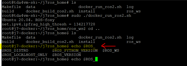

  • I donot have any environment variable named  ROS_IP or ROS_MASTER_URI. See the image below. When i do echo $ROS and hit tab. I donot get ROS_IP or ROS_MASTER_URI in the list.
    however after running udhcpc -i wlp1s0 . Now the IP  address of wlp1s0 interface is same as shown by the router's configuration page. Look at the image below
    After fiddling around for some time i managed to see something on the Rviz running on the host. But only one feed available and that too is stuck.. Frame change is veryyyyyyyyyyyyyyyyyyyyyyyyyyyyyyyyyyyyyyyyyyyyyyyyyyyyyy slow. There is no one else connected to this router only the eval board and host machine.
