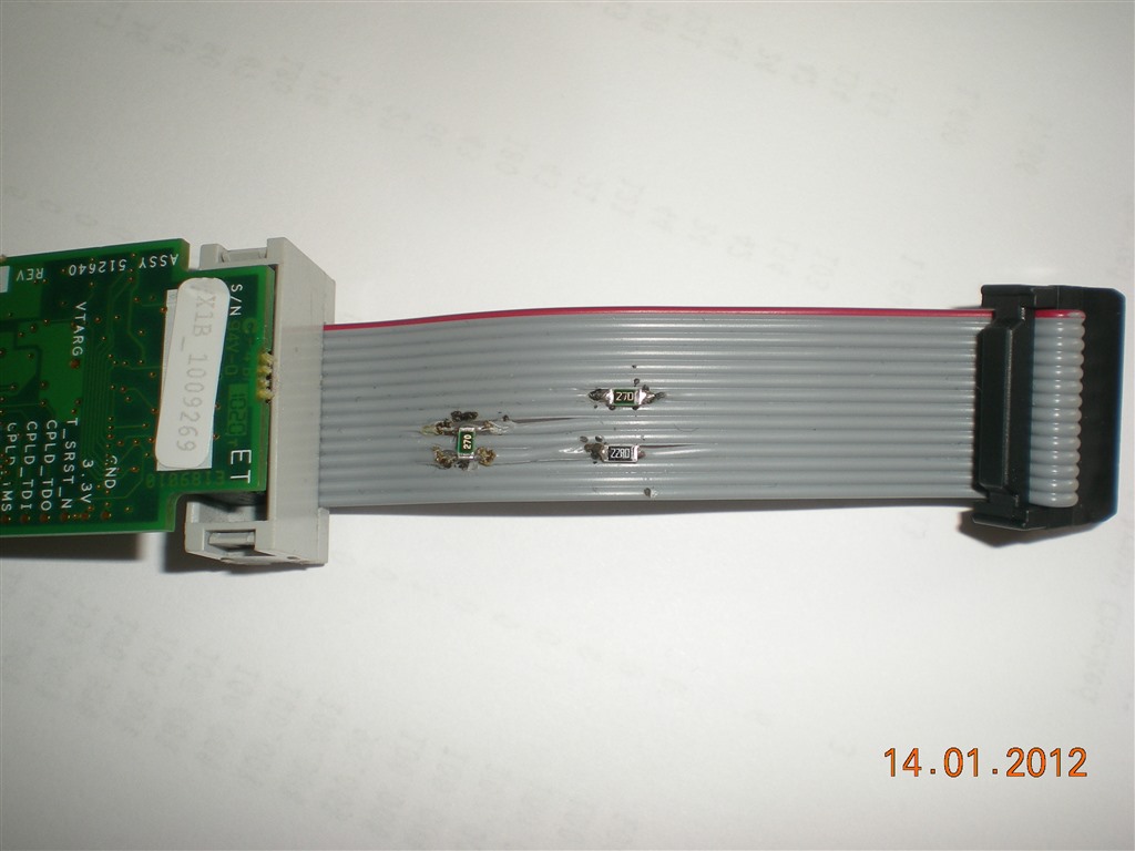

  • Sorted after months of frequents trials...
    Although it had worked first time it stopped in later trials
    The problem was missing series terminating resistors on JTAG bus
    Here is what I did to get around

  • Here are some resources I would recommend to someone having connection issue
    http://processors.wiki.ti.com/index.php/XDS_Target_Connection_Guide
    SPRAA49 - TMS320VC5501 Hardware Designer’s Resource Guide
