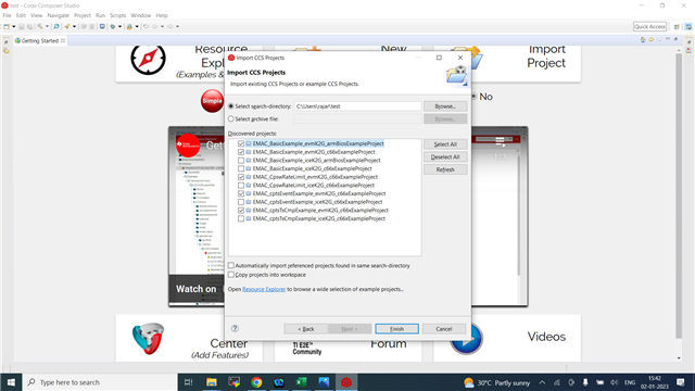

    Now, Import the CCS project into CCS and go on
    1. To Import the project, Go to File -> Import -> "CCS projects" in "C/C++" -> Browse "Select Search-directory". make sure to uncheck the "Copy Projects into Workspace" (This is to avoid compilation errors only If TI-RTOS SDK was installed in a different location than "C:\ti\").
    we have the following DSP example projects
      1. EMAC_BasicExample_evmK2G_c66xExampleProject
      2. EMAC_BasicExample_iceK2G_c66xExampleProject
      3. EMAC_CpswRateLimit_evmK2G_c66xExampleProject
      4. EMAC_CpswRateLimit_iceK2G_c66xExampleProject
      5. EMAC_cptsEventExample_evmK2G_c66xExampleProject
      6. EMAC_cptsTsCmpExample_iceK2G_c66xExampleProject (Note: ICE - Industrial Communications Engine, is an extended module with bulk features added compared to evmK2G).
      7. Do not open ARM and DSP examples at the same time, CCS will throw the "Project out-of-sync" error dialog.

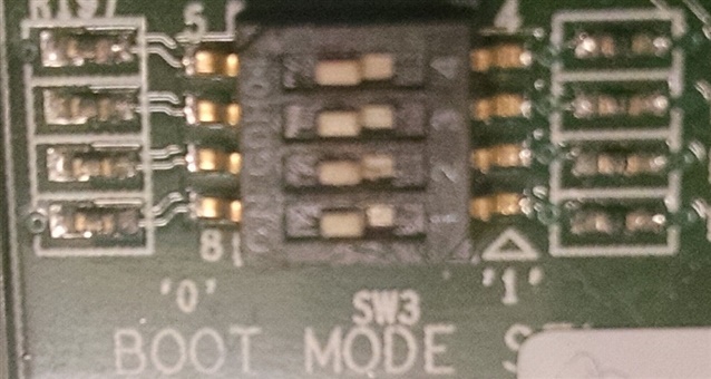

    3. EVMK2G hardware settings,
      1. Boot Mode switch settings
        SW3[4:1] BOOT MODE
        0000 (0x0) Sleep/No Boot
        0001 (0x1) PCIe boot
        0010 (0x2) Ethernet Boot
        0011 (0x3)
        I2C PLL Boot
        0100 (0x4) SPI No PLL Boot
        0101 (0x5) SPI PLL-1 Boot
        0110 (0x6) USB Boot
        0111 (0x7) MMC/SD Boot
        1000 (0x8) UART Boot
        1001 (0x9) QSPI 96 Boot
        1010 (0xa) eMMC Boot
        1011 (0xb) NAND Boot
        1100 (0xc) I2C No PLL Boot
        1101 (0xd) SPI PLL-2 Boot
        1110 (0xe) SPI PLL-3 Boot
        1111 (0xf)
        QSPI 48 Boot
      2. No Boot Mode switch settings :
