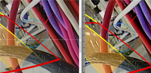

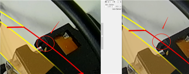

I find  the red line in a image has aliasing effect after converting RGBX to YUV422  through M2M.
This  aliasing  effect is increased significantly . Is there any way to optimize the aliasing  effect?
Thanks.
the aliasing effect of red line

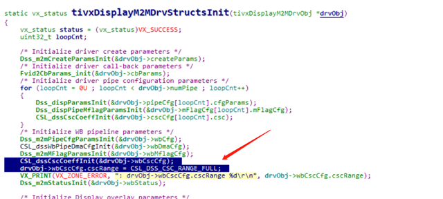

    I dont see any interface in OpenVX node to change CSC coefficients. You would have to go inside the driver and change.
    Since your input format is in RGB and output is in YUV, the CSC in the WB pipeline would be used to do format conversion.
    So in the file tiovx\kernels_j7\hwa\display_m2m\vx_display_m2m_target.c, in the API tivxDisplayM2MDrvStructsInit, below initialization code sets the CSC in WB pipeline in limited range coefficients.
    CSL_dssCscCoeffInit(&drvObj->wbCscCfg);
    After calling this API, can you please add below statement to change CSC coefficients to get full range output and see if it gives better result?
    drvObj->wbCscCfg.cscRange = CSL_DSS_CSC_RANGE_FULL;
    Brijesh

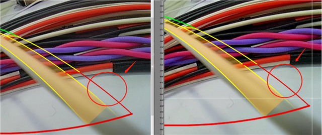

    I have a try,  but it has no effect. It still has aliasing.
    I think it will lose some chroma information after after converting RGBX to YUV422(not YUV444),Is this effect inevitable?
    Whether my thought is correct ? Is there any way to avoid this effect?
    codeeffect comparison
    thank you!
    Can you please save one output image from DSS M2M and share it?
    Yes, if this is because of chroma conversion, there isn't much we can do.

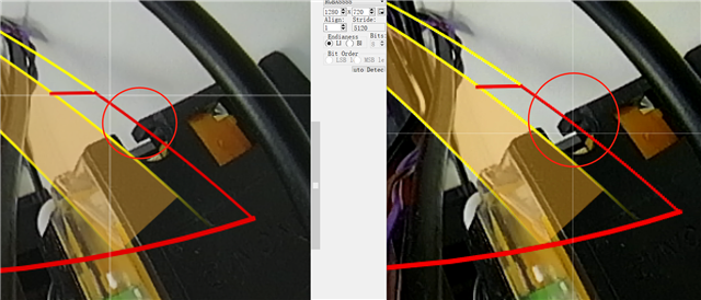

    ok, i see. For chroma downsampling, driver uses scalar and scalar supports multi tap filter. I think by default it uses 5-tap filter for downscaling. Can you please try changing filter to 3-tap? You could change it in pdk_jacinto_08_05_00_36/packages/ti/csl/src/ip/dss/V4/priv/csl_dssWbPipe.c, in API CSL_dssWbPipeSetConfig.

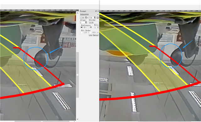

  • Dear  Brijesh
    I have a try , but it has no effect.  Would you please check it?
    image diff
    image_RGBXandUYVY20230313.zip
    thanks

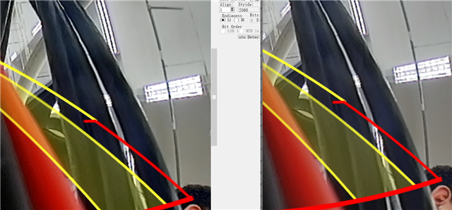

    Can you please confirm that after this change you have rebuild PDK driver and then checked the output?
    If you have, can you try changing scaling coefficients? The below code selects the Vertical Scaling coefficients for chroma, can you please hard code input and output height and try to get different scaling coefficients in the file ti-processor-sdk-rtos-j721e-evm-08_05_00_11\pdk_jacinto_08_05_00_36\packages\ti\csl\src\ip\dss\V4\priv\csl_dssWbPipe.c ?
    vChromaCoeff = CSL_dssWbPipeGetScalerCoeff(chromaInHeight,
    chromaOutHeight,
    verticalTaps);
    Brijesh

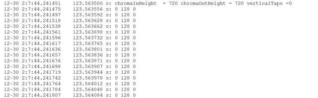

  • HI, Brijesh
    If I want to print infomation , how to print infomation in  csl_dssWbPipe.c ?
    thanks
  • Hi cao yongren,
    You could extern printf in this file and then can use printf API.
    Brijesh

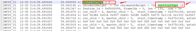

  • HI, Brijesh
    I have confirmed what you said. I  printf the infomation and confirm the chanage code is build.
    But the image I saved looks no effect. Could you please  check whether the effect locally like this?
    The code change and print info is below.
    Thank you.
    print info
    iamge

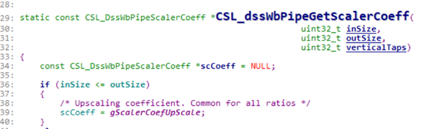

  • Hi , Brijesh
    The inSize value equals the outSize value, so the gScalerCoefUpScale returned. Need I to modify it to gScalerCoefDownScale3TapM14 to try?
    Not there, but when you are calling this API, there is a input and output size, can you please try setting them same, like below?
    vChromaCoeff = CSL_dssWbPipeGetScalerCoeff(1280,
    1280,
    verticalTaps);
    Brijesh
  • Hi ,
    Now  the inSize and outSize are the same according to the printf log, Both of them are 720 that is the height of image  convert to YUV422.
    So I mean CSL_dssWbPipeGetScalerCoeff return gScalerCoefUpScale(Beacuse  inSize <= outSize ), and vChromaCoeff will get  gScalerCoefUpScale not gScalerCoefDownScale3TapM14 and gScalerCoefDownScale3TapM14 is not be effect.
    Thandks

  • Hi ,
    I  change vChromaCoeff to gScalerCoefDownScale3TapM14 in CSL_dssWbPipeSetConfig function.
    and confirm the param is effect througt printf log. But the image seems no  improvement.
    Then which coefficients to try ?
    Could you please explain what impact the vChromaCoeff parameter has in the RGBX to UYVY format convertion?
    Thanks you.

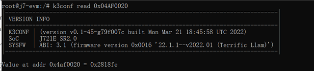

  • Hi Cao,
    Can you please revert all the change back to what is available in the SDK, run the usecase and save all WB registers and share it to me?
    Please save 150 registers from 0x04AF0000 offset and share them to debug it further?
    Brijesh
  • HI,
    How to save 150 registers from 0x04AF0000 offset ?
    thanks
    You could connect to any R5F using CCS + JTAG and can dump the registers from CCS memory window..
    or you could use memdump utility or k3conf utility from Linux prompt for dumping any register value.
    Brijesh

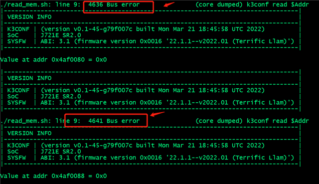

  • HI,
    I donot have Ti CCS + JTAG environment.
    I find  k3conf utility from Linux prompt. but k2conf only read 1 register value once time.
    How to dump 150 registers  using k2conf utility once time?
    Or could you please determine several registers?
    thanks
  • HI, Brijesh
    I use k2conf save 150 registers value  from 0x04AF0000  throught shell.
    Could you please check  whether it is helpful?
    thanks

    Yeah, the current dump of registers are at the offset of 8. Can you please dump at the offset of 4?
    Brijesh
    There is a bus error when dump registers at the offset of 4 .
    Only ok at the offset of 8.
  • ok, it may be due A72.
    Can you please save registers upto offset 0x4af0248?
    Also are you sure that register are read after running DSS M2M? Because the register at the offset 0x4af0020 should not be 0 if DSS M2M is running. This is attribute register where we set output format and also enable scalar to conversion... So it should not be 0.
    Brijesh
  • HI,
    The registers after running DSS M2M are below.
    | VERSION INFO                                                                   |
    | K3CONF | (version v0.1-45-g79f007c built Mon Mar 21 18:45:58 UTC 2022)         |
    | SoC    | J721E SR2.0                                                           |
    | SYSFW  | ABI: 3.1 (firmware version 0x0016 '22.1.1--v2022.01 (Terrific Llam)') |

    Value at addr 0x4af0000 = 0x0
    | VERSION INFO                                                                   |
    | SoC    | J721E SR2.0                                                           |
    Value at addr 0x4af0008 = 0x0
    | VERSION INFO                                                                   |
    | SoC    | J721E SR2.0                                                           |
    Value at addr 0x4af0010 = 0x0
    | VERSION INFO                                                                   |
    | SoC    | J721E SR2.0                                                           |
    Value at addr 0x4af0018 = 0x0
    | VERSION INFO                                                                   |
    | SoC    | J721E SR2.0                                                           |
    Value at addr 0x4af0020 = 0x2818fe

  • hi,
    This register dump is still update 0x4af0090 offset. As i asked earlier, please dump registers upto offset 0x4af0248 and then share it.
    Brijesh
    The registers upto offset 0x4af0248  after running DSS M2M are below.
    | VERSION INFO                                                                   |
    | SoC    | J721E SR2.0                                                           |
    | VERSION INFO                                                                   |
    | SoC    | J721E SR2.0                                                           |
    | VERSION INFO                                                                   |
    | SoC    | J721E SR2.0                                                           |
    | VERSION INFO                                                                   |
    | SoC    | J721E SR2.0                                                           |
    | VERSION INFO                                                                   |
    | SoC    | J721E SR2.0                                                           |
    Value at addr 0x4af0028 = 0xbc3a0000
    | VERSION INFO                                                                   |
    | SoC    | J721E SR2.0                                                           |
    Value at addr 0x4af0030 = 0x0
    | VERSION INFO                                                                   |
    | SoC    | J721E SR2.0                                                           |
    Value at addr 0x4af0038 = 0x1000
    | VERSION INFO                                                                   |
    | SoC    | J721E SR2.0                                                           |
    Value at addr 0x4af0040 = 0x96004d
    | VERSION INFO                                                                   |
    | SoC    | J721E SR2.0                                                           |
    Value at addr 0x4af0048 = 0x7eb0792
    | VERSION INFO                                                                   |
    | SoC    | J721E SR2.0                                                           |
    Value at addr 0x4af0050 = 0x83
    | VERSION INFO                                                                   |
    | SoC    | J721E SR2.0                                                           |
    Value at addr 0x4af0058 = 0x0
    | VERSION INFO                                                                   |
    | SoC    | J721E SR2.0                                                           |
    Value at addr 0x4af0060 = 0x400000
    | VERSION INFO                                                                   |
    | SoC    | J721E SR2.0                                                           |
    Value at addr 0x4af0068 = 0x200000
    | VERSION INFO                                                                   |
    | SoC    | J721E SR2.0                                                           |
    Value at addr 0x4af0070 = 0x200
    | VERSION INFO                                                                   |
    | SoC    | J721E SR2.0                                                           |
    Value at addr 0x4af0078 = 0x1c0
    | VERSION INFO                                                                   |
    | SoC    | J721E SR2.0                                                           |
    Value at addr 0x4af0080 = 0x180
    | VERSION INFO                                                                   |
    | SoC    | J721E SR2.0                                                           |
    Value at addr 0x4af0088 = 0x140
    | VERSION INFO                                                                   |
    | SoC    | J721E SR2.0                                                           |
    Value at addr 0x4af0090 = 0x200
    | VERSION INFO                                                                   |
    | SoC    | J721E SR2.0                                                           |
    Value at addr 0x4af0098 = 0x1c0
    | VERSION INFO                                                                   |
    | SoC    | J721E SR2.0                                                           |
    Value at addr 0x4af00a0 = 0x180
    | VERSION INFO                                                                   |
    | SoC    | J721E SR2.0                                                           |
    Value at addr 0x4af00a8 = 0x140
    | VERSION INFO                                                                   |
    | SoC    | J721E SR2.0                                                           |
    Value at addr 0x4af00b0 = 0x100
    | VERSION INFO                                                                   |
    | SoC    | J721E SR2.0                                                           |
    Value at addr 0x4af00b8 = 0x0
    | VERSION INFO                                                                   |
    | SoC    | J721E SR2.0                                                           |
    Value at addr 0x4af00c0 = 0x10000
    | VERSION INFO                                                                   |
    | SoC    | J721E SR2.0                                                           |
    Value at addr 0x4af00c8 = 0x20000
    | VERSION INFO                                                                   |
    | SoC    | J721E SR2.0                                                           |
    Value at addr 0x4af00d0 = 0x30000
    | VERSION INFO                                                                   |
    | SoC    | J721E SR2.0                                                           |
    Value at addr 0x4af00d8 = 0x0
    | VERSION INFO                                                                   |
    | SoC    | J721E SR2.0                                                           |
    Value at addr 0x4af00e0 = 0x0
    | VERSION INFO                                                                   |
    | SoC    | J721E SR2.0                                                           |
    Value at addr 0x4af00e8 = 0x0
    | VERSION INFO                                                                   |
    | SoC    | J721E SR2.0                                                           |
    Value at addr 0x4af00f0 = 0x0
    | VERSION INFO                                                                   |
    | SoC    | J721E SR2.0                                                           |
    Value at addr 0x4af00f8 = 0x0
    | VERSION INFO                                                                   |
    | SoC    | J721E SR2.0                                                           |
    Value at addr 0x4af0100 = 0x10000
    | VERSION INFO                                                                   |
    | SoC    | J721E SR2.0                                                           |
    Value at addr 0x4af0108 = 0x20000
    | VERSION INFO                                                                   |
    | SoC    | J721E SR2.0                                                           |
    Value at addr 0x4af0110 = 0x30000
    | VERSION INFO                                                                   |
    | SoC    | J721E SR2.0                                                           |
    Value at addr 0x4af0118 = 0x0
    | VERSION INFO                                                                   |
    | SoC    | J721E SR2.0                                                           |
    Value at addr 0x4af0120 = 0x0

  • Hi cao,
    Can you please
    - revert all the changes that we did and bring the code to SDK8.5 level for the DSS driver?
    - now when the usecase is running, can you please check and confirm that  VERTICALTAPS (bit-21) is set in WB_ATTRIBUTE register (0x04AF0020)?
    - In addition in the file ti-processor-sdk-rtos-j721e-evm-08_06_00_12\pdk_jacinto_08_06_00_31\packages\ti\csl\src\ip\dss\V4\priv\csl_dssWbPipe.c, in the API CSL_dssWbPipeGetChromaRes, can you please make below change and try it out?
    if (TRUE == Fvid2_isDataFmtYuv422(dataFormat))
    *chromaWidth = width / 2U;
    *chromaHeight = height;
    Brijesh
  • Hi,Brijesh
    - Now WB_ATTRIBUTE register (0x04AF0020) is 0x2818fe  => B0010 1000 0001 1000 1111 1110‬ , so  VERTICALTAPS (bit-21)  is set.
    -Now we are bringing the code to SDK8.6 level.   So,  can the change of  csl_dssWbPipe.c be tried on SDK8.6 ?

  • Hi,Brijesh
    -Now we have brought the code to SDK8.6 level. make below change and try, but the image I saved has no  improvement.
    -The registers upto offset 0x4af0248  and  0x04AF002 after running DSS M2M are below.
    | VERSION INFO                                                                   |
    | SoC    | J721E SR2.0                                                           |
    | SYSFW  | ABI: 3.1 (firmware version 0x0008 '8.6.3--v08.06.03 (Chill Capybar)') |
    | VERSION INFO                                                                   |
    | SoC    | J721E SR2.0                                                           |
    | VERSION INFO                                                                   |
    | SoC    | J721E SR2.0                                                           |
    | VERSION INFO                                                                   |
    | SoC    | J721E SR2.0                                                           |
    | VERSION INFO                                                                   |
    | SoC    | J721E SR2.0                                                           |
    Value at addr 0x4af0028 = 0xb8386000
    | VERSION INFO                                                                   |
    | SoC    | J721E SR2.0                                                           |
    | VERSION INFO                                                                   |
    | SoC    | J721E SR2.0                                                           |
    | VERSION INFO                                                                   |
    | SoC    | J721E SR2.0                                                           |
    | VERSION INFO                                                                   |
    | SoC    | J721E SR2.0                                                           |
    | VERSION INFO                                                                   |
    | SoC    | J721E SR2.0                                                           |
    | VERSION INFO                                                                   |
    | SoC    | J721E SR2.0                                                           |
    | VERSION INFO                                                                   |
    | SoC    | J721E SR2.0                                                           |
    | VERSION INFO                                                                   |
    | SoC    | J721E SR2.0                                                           |
    | VERSION INFO                                                                   |
    | SoC    | J721E SR2.0                                                           |
    | VERSION INFO                                                                   |
    | SoC    | J721E SR2.0                                                           |
    | VERSION INFO                                                                   |
    | SoC    | J721E SR2.0                                                           |
    | VERSION INFO                                                                   |
    | SoC    | J721E SR2.0                                                           |
    | VERSION INFO                                                                   |
    | SoC    | J721E SR2.0                                                           |
    | VERSION INFO                                                                   |
    | SoC    | J721E SR2.0                                                           |
    | VERSION INFO                                                                   |
    | SoC    | J721E SR2.0                                                           |
    | VERSION INFO                                                                   |
    | SoC    | J721E SR2.0                                                           |
    | VERSION INFO                                                                   |
    | SoC    | J721E SR2.0                                                           |
    | VERSION INFO                                                                   |
    | SoC    | J721E SR2.0                                                           |
    | VERSION INFO                                                                   |
    | SoC    | J721E SR2.0                                                           |
    | VERSION INFO                                                                   |
    | SoC    | J721E SR2.0                                                           |
    | VERSION INFO                                                                   |
    | SoC    | J721E SR2.0                                                           |
    | VERSION INFO                                                                   |
    | SoC    | J721E SR2.0                                                           |
    | VERSION INFO                                                                   |
    | SoC    | J721E SR2.0                                                           |
    | VERSION INFO                                                                   |
    | SoC    | J721E SR2.0                                                           |
    | VERSION INFO                                                                   |
    | SoC    | J721E SR2.0                                                           |
    | VERSION INFO                                                                   |
    | SoC    | J721E SR2.0                                                           |
    | VERSION INFO                                                                   |
    | SoC    | J721E SR2.0                                                           |

    Value at addr 0x4af0228 = 0x0
    | VERSION INFO                                                                   |
    | SoC    | J721E SR2.0                                                           |
    Value at addr 0x4af0230 = 0x0
    | VERSION INFO                                                                   |
    | SoC    | J721E SR2.0                                                           |
    Value at addr 0x4af0238 = 0x0
    | VERSION INFO                                                                   |
    | SoC    | J721E SR2.0                                                           |
    Value at addr 0x4af0240 = 0x0
    | VERSION INFO                                                                   |
    | SoC    | J721E SR2.0                                                           |
    Value at addr 0x4af0248 = 0x0
    | VERSION INFO                                                                   |
    | SoC    | J721E SR2.0                                                           |

    diff --git a/pdk_jacinto/packages/ti/csl/src/ip/dss/V4/priv/csl_dssWbPipe.c b/pdk_jacinto/packages/ti/csl/src/ip/dss/V4/priv/csl_dssWbPipe.c
    index a34ea0676c..403a07c5e3 100755
    --- a/pdk_jacinto/packages/ti/csl/src/ip/dss/V4/priv/csl_dssWbPipe.c
    +++ b/pdk_jacinto/packages/ti/csl/src/ip/dss/V4/priv/csl_dssWbPipe.c
    @@ -1457,8 +1457,8 @@ static void CSL_dssWbPipeGetChromaRes(uint32_t dataFormat,
    -            *chromaWidth  = width;
    -            *chromaHeight = height / 2U;
    +            *chromaWidth  = width / 2u;
    +            *chromaHeight = height;
             if (TRUE == Fvid2_isDataFmtYuv420(dataFormat))

    Yes, I rebuilded the PDK and SDK . What should the vaule of the offset 0x4af0090 ?

    I think i know the problem, can you please replace CSL_dssWbPipeGetChromaRes API inti-processor-sdk-rtos-j721e-evm-08_06_00_12\pdk_jacinto_08_06_00_31\packages\ti\csl\src\ip\dss\V4\priv\csl_dssWbPipe.c file with below code and rebuild PDK and SDK and check the output?
                                          uint32_t width,
                                          uint32_t height,
                                          uint32_t *chromaWidth,
                                          uint32_t *chromaHeight)
        if (TRUE == Fvid2_isDataFmtRgb(dataFormat))
        else if (TRUE == Fvid2_isDataFmtYuv(dataFormat))
            else if (TRUE == Fvid2_isDataFmtYuv420(dataFormat))
            else
        else
            *chromaWidth  = 0U;
            *chromaHeight = 0U;
    Brijesh
  • HI Brijesh
    I replaced the above  code and  rebuild the PDK and SDK. The image saved has no effect. The registers after running DSS M2M are below.
    The value at the offset 0x4af0090 is 0x120

    | SoC    | J721E SR2.0                                                           |
    Value at addr 0x4af01c8 = 0x10000
    | VERSION INFO                                                                   |
    | SoC    | J721E SR2.0                                                           |
    Value at addr 0x4af01d0 = 0x20000
    | VERSION INFO                                                                   |
    | SoC    | J721E SR2.0                                                           |
    Value at addr 0x4af01d8 = 0x30000
    | VERSION INFO                                                                   |
    | SoC    | J721E SR2.0                                                           |
    Value at addr 0x4af01e0 = 0x0
    | VERSION INFO                                                                   |
    | SoC    | J721E SR2.0                                                           |
    Value at addr 0x4af01e8 = 0x0
    | VERSION INFO                                                                   |
    | SoC    | J721E SR2.0                                                           |
    Value at addr 0x4af01f0 = 0x0
    | VERSION INFO                                                                   |
    | SoC    | J721E SR2.0                                                           |
    Value at addr 0x4af01f8 = 0x0
    | VERSION INFO                                                                   |
    | SoC    | J721E SR2.0                                                           |
    Value at addr 0x4af0200 = 0x0
    | VERSION INFO                                                                   |
    | SoC    | J721E SR2.0                                                           |
    Value at addr 0x4af0208 = 0x2cf04ff
    | VERSION INFO                                                                   |
    | SoC    | J721E SR2.0                                                           |
    Value at addr 0x4af0210 = 0x2cf04ff
    | VERSION INFO                                                                   |
    | SoC    | J721E SR2.0                                                           |
    Value at addr 0x4af0218 = 0x0
    | VERSION INFO                                                                   |
    | SoC    | J721E SR2.0                                                           |
    Value at addr 0x4af0220 = 0x0
    | VERSION INFO                                                                   |
    | SoC    | J721E SR2.0                                                           |
    | VERSION INFO                                                                   |
    | SoC    | J721E SR2.0                                                           |
    | VERSION INFO                                                                   |
    | SoC    | J721E SR2.0                                                           |
    | VERSION INFO                                                                   |
    | SoC    | J721E SR2.0                                                           |
    | VERSION INFO                                                                   |
    | SoC    | J721E SR2.0                                                           |
    | VERSION INFO                                                                   |
    | SoC    | J721E SR2.0                                                           |
    Value at addr 0x4af0020 = 0x2818ff
