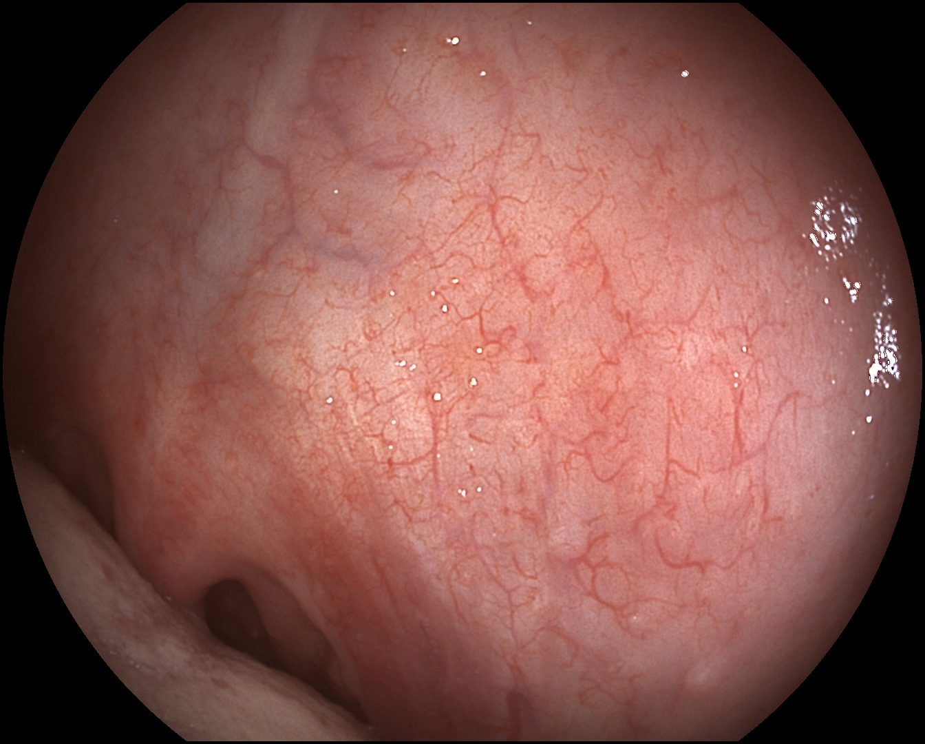

And please see the attachment, fpga.bin is the video source on the FPGA side (BGR format: 1344X1080X3) and arm.bin is the captured overlay data via the WB module (BGRX format: 1920X1200X4).
https://e2echina.ti.com/cfs-file/__key/communityserver-discussions-components-files/120/arm.bin
https://e2echina.ti.com/cfs-file/__key/communityserver-discussions-components-files/120/fpga.bin
By analyzing the pixels at the corresponding location, the video data is the same, and figures 1 and 2 are visualizations of fpga.bin and arm.bin respectively, which are no different from the visual effects. But the difference is clear when the data on the arm side is sent to the display:
Figure 1
Figure 2
4) Based on the above analysis, customers are currently skeptical that the problem is due to processing of RGB data by the encoder in the DRM display framework (as shown in the first attachment). Dose GPU rendering do some processing of RGB pixel dots? Is it possible to turn off the processing via a register-like configuration and send the bypass directly?

    Sorry, could not get the exact issue. Are you seeing pixel data being changed? By how much?
    Yes, GPU can change pixels, but then DSS can also change, depending on the input and output format.. So need to understand complete flow.
    Also have you taken dump after every step in the flow to figure out which module is introducing the difference in pixel values?
