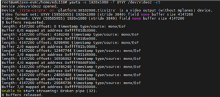

We have an imx390 sensor with an internal isp. Connect to imx390-- >ds90ub953-- >ds90ub954--> am62a processor, I used name_overlays= k3-am62a7-fpdlink-sk-funition. dtbo k3-J721e-fpdlink-imx390-rcm-0-dtbo, but I couldn't debug it. Is there any changes I need to make?
media-ctl -p as follow:

  • Now I have changed a raw imx390 sensor, but I still can't get the picture
  • I changed a couple of things in the device tree
  • Now I've got a raw imx390 sensor
    but the outflow failed

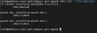

    Can you provide "v4l2-ctl --list-devices" and "media-ctl -p" output?
    Jianzhong
  • now csi-bridge do not connect to ticsi2rx ,  have no video2,   i  do not  know  why

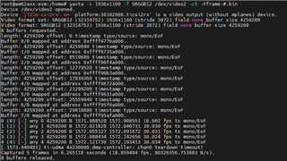

  • Now I have debug the raw imx390 sensor successful,could get the frame

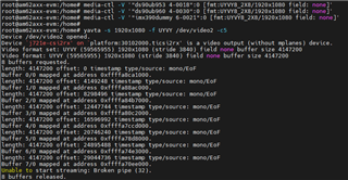

    return to the internal isp imx390 sensor,it does not require a driver,The sensor is configured automatically by the build-in ISP in the camera
  • Can you deal with it as soon as possible? It's been delayed for two weeks
    Thanks for the update. This is good to know.
    This is a different sensor than the one supported by the SDK. The IMX390 driver in our SDK only supports raw image format, but your sensor has built-in ISP and most likely outputs YUV/RGB images. There may be other differences. Would you mind sharing more information about this sensor? A web link of the sensor would be helpful.

  • Thank you for sharing the log. I noticed that entity 29 (imx390dummy) has different format from entity 24 (ub953) and entity 15 (ub960). Can you try to set the same format for all of three and then run yavta?
    media-ctl -V '"ds90ub953 4-0018":0 [fmt:UYVY8_2X8/1920x1080 field: none]'
    media-ctl -V '"ds90ub960 4-0030":0 [fmt:UYVY8_2X8/1920x1080 field: none]'
    media-ctl -V '"imx390dummy 6-0021":0 [fmt:UYVY8_2X8/1920x1080 field: none]'
  • What does "media-ctl -p" show now?

  • Ok. Thanks. Looks like imx390dummy format was not set properly. It still has "SRGGB12".
    You need to add the right format to the imx390dummy driver, for example:
    static void imx390_dummy_init_formats(struct v4l2_subdev_state *state)
    	struct v4l2_mbus_framefmt *format;
    	format = v4l2_state_get_stream_format(state, 0, 0);
    	//format->code = MEDIA_BUS_FMT_SRGGB12_1X12;
    	format->code = MEDIA_BUS_FMT_UYVY8_2X8;
    	//format->width = 1936;
    	//format->height = 1100;
    	format->width = 1920;
    	format->height = 1080;
    	format->field = V4L2_FIELD_NONE;
    	format->colorspace = V4L2_COLORSPACE_SMPTE170M;
  • Tthanks for your support!I have get the frame!
