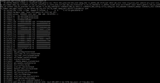

But when we launch TDA4 via SBL, with multiimage in OPTIMIZED mode, conection fails using same configurations.
Ping is not reached and after a while (arounfd 15s) CoreDump happens:
Then, we can not transfer SCP (neither other protocol via ethernet) files when run via SBL but yes when we run via SPL.

    May I know what "./configure_network.sh " is doing?
    From the log it seems link is up very early, but this script is executing very late from the below logs.
    [   31.355132] am65-cpsw-nuss 46000000.ethernet eth0: Link is Up - 100Mbps/Full - flow control rx/tx
    PING 192.168.50.1 (192.168.50.1): 56 data bytes
    [ 85.064596] ------------[ cut here ]------------
    [ 85.069213] NETDEV WATCHDOG: eth0 (am65-cpsw-nuss): transmit queue 0 timed out
    Is there any application sending the data to CPSW2G before running the script?
