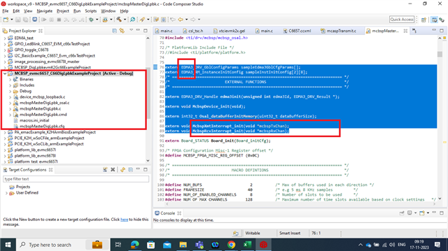

I would like to get a sample program that uses the EDMA in c6657 processor
in with source and destination connected to the MCBSP
using ping pong method.
Thank You
    We have a separate example for "EDMA PING PONG" test and "MCBSP loop back with EDMA3".
    Please follow the steps given here  :- [FAQ] TMS320C6678: How to create a EDMA PING-PONG test-code using the CSL ( Chip support Library ) package and test on C6678 EVM ? - Processors forum - Processors - TI E2E support forums
    Though it is writen for C6678, the same steps are applicable for C6657 too: Provided you use the appropriate SDK package for C6657.
    That is PROCESSOR-SDK-RTOS-C665x 06_03_00_106
    http://software-dl.ti.com/processor-sdk-rtos/esd/C665x/latest/index_FDS.html
    Step1:-
    Generate the PDK examples by following this FAQ:- https://e2e.ti.com/support/processors-group/processors/f/processors-forum/1040872/faq-tms320c6657-how-to-generate-the-ccs-pdk-examples-for-c6657
    Step2:-
    Location of the project - C:\ti\pdk_c665x_2_0_16\packages\MyExampleProjects\MCBSP_evmc6657_C66DigLpbkExampleProject
    Shankari G

    Hi
    I have tested this example and it worked fine, without the ping-pong
    when I defined MCBSP_LOOP_PING_PONG to start working as a ping-pong
    the example does not function properly
    there must be a few changes needed in order for this example to function
    properly in ping-pong mode.
    I have added the changes needed in the attached file
