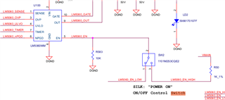

  • Hi Takuma,
    I see a wire in the back of the board. Is it the modification you are referring to ? I attached this image:

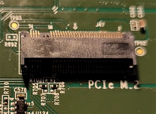

  • Hi Victor,
    The hardware modification is different from the hardware mod in the image. The relevant hardware mod would be below:
    There are two resistors near the M.2 slot. Please make sure these resistors are connected to R705 and R706, and not rotated to connect R707 and R708. There are additional two resistors that are covered up by the SOM board, R196 and R197, which should also be checked to make sure they are in "clock gen" configuration instead of "soc" configuration in above image.
    As for the hardware mod in your image, it looks like a short between EN pin on LM5060 and the ON/OFF switch:
    If the board is turning on, then I assume this is fine. Although, if there are these kinds of hardware mods, I assume it is a very old board.
    If you have a different, newer common processor board (CPB), then could you try the experiment out with the newer board? For example, the board I am using for testing is PROC079E3D, where E3D is the revision number.

  • Hi Takuma,
    Please find attached a pic showing resistors R705 and R706. I think they are correct.
    For resistors R196 and R197, can you let me know where they are located ?
