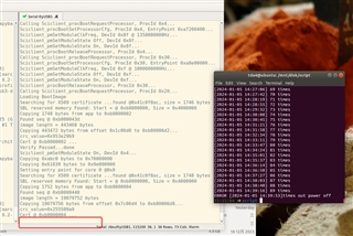

  • Hi Diwakar,
        The SBL freeze occurs when retrieving the TIFS version, specifically during the invocation of the SBL_SciClientInit->Sciclient_service interface. The lack of LOG printing by the SBL is due to certain LOGs not being enabled at that time.
    thanks.
  • HI Ni
    You mean
    it is getting stuck here ? Am i right ?
    Can you share the R5 and TIFS l;ogs as well ?
    follow this FAQ to enable the sysfw traces.
    e2e.ti.com/.../faq-system-firmware-calls-have-failed-or-crashed-what-do-i-do
    Also how much is the failure rate ?
    Diwakar
  • Hi Diwakar,
    1. Yes, the freezing occurs at two locations, Sciclient_procBootAuthAndStart and the Sciclient_service position shown in your image. However, the final invocation should be the Sciclient_service interface.
    2. The logs from R5 indicate a freeze at the signature verification interface Sciclient_procBootAuthAndStart.
    3、The freezing occurs with a frequency of 1 in 200 attempts.
    4、Obtaining logs from TIFS is currently challenging. We will provide them later. Can you replicate the issue in your testing environment?
    The issue is easy to reproduce. Kindly expedite your efforts to reproduce the problem and provide a performance testing report as soon as possible.
    This issue is urgent. Can you help remotely to address it?
    thanks.

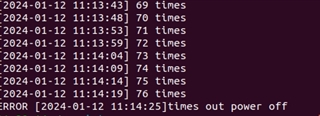

    Our current reproduction method is as follows:
    1、After each boot to the Linux kernel, when the kernel prints the string 'Booting Linux on,' we power off. After a 1-second interval, we power on again and repeat the test.
    2、Lateapp1 and lateapp2 also need to be verified and booted on their respective cores.
    thanks.

  • Hi Diwakar,
    Following the method you provided, I conducted verification without signature verification and starting the Linux kernel, and have successfully replicated the system hang issue. The log is as follows:
    Please help analyze and resolve this issue. I have the following questions that require your response:
    1. Have you encountered and replicated this issue? If so, please provide a solution. If not, please provide the stress testing report.
    2. Why does the problem not occur when the trace configuration shown in the attached image is added? Please assist in analyzing the reason.
    Please help resolve this issue as soon as possible.
    thanks.

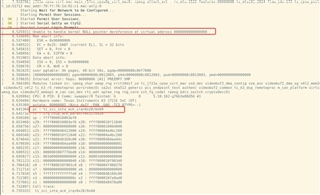

  • Hi Diwakar,
    1、 We resolved the intermittent signature verification failure issue by enabling .trace_dst_enables and .trace_src_enables in DMSC. However, we encountered the following error reported during Linux kernel startup, with a reproducibility rate of 50%.
    2、We have identified the 'ti_j721e_cpsw_virt_mac' service, and when DMSC log is enabled, there is a 50% chance of encountering a null pointer issue. Based on this observation, do you have any suggestions?
    thanks.
