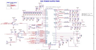

I am using AM62A Starter KIT EVM, while giving power form Type C, I found out Power is reaching at PMIC and it is generating 1V1 and 1V8 but not generating Core supply. and also PMIC_enable at U36 is always Low.What could be the issue?

Are you able to measure 3.3V on TP46 VCC_3V3_MAIN

The PMIC_ENABLE should be always high to turn on the PMIC. What is the voltage you are getting at TP41?

It is in milli volts
What could be the reason for this and How can I resolve this issue.

Is this the TP46 VCC_3V3_MAIN or PMIC_ENABLE?
Have you been using the board before the issue was observed.

Is there a jumper connected on J9?
Sreenivasa
Yes we were using this boards
After this issue I conneccted the J9 also, Problem was NOT Solved

Could you please provide some background when the failure happened.
Did this issue happen during subsequent power cycling or while doing some probing etc.

For some reason, LPM enable is set on the processor. Have you tried any low power mode when EVM was working before?
Where did you buy this EVM?
Senthil
Hello Sethil,
Yes, We did low power mode through Linux Processor SDK 9.1 by sending the system to Partial I/O Mode.
