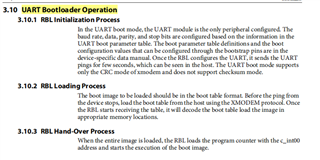

    You have to convert the .out into .bin using the Boot-tools provided in thePROCESSOR-SDK-RTOS-C665x 06_03_00_106
    http://software-dl.ti.com/processor-sdk-rtos/esd/C665x/latest/index_FDS.html
    But there is no specific format for Xmodem.
    Please note that the"XMODEM" is the option which has to be selected when using the "teraterm" utility in windows.
    In the teraterm options, when selecting the protocol, select Xmodem(CRC) ( I guess, that is what is mentioned in the DSP bootloader guide )
    Please refer this e2e thread for the step by step procedure to convert the .out to .bin
    https://e2e.ti.com/support/processors-group/processors/f/processors-forum/235540/c6657-uart-boot/851198#851198

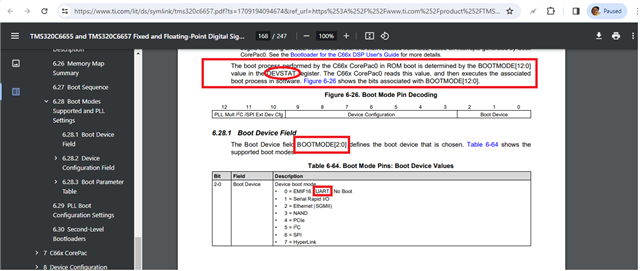

    2. During the power on process of the development board, besides configuring the boot mode to UART BOOT MODE( up needed pin voltage), are there any other operations involved?
    For uart boot mode, you have to configure the boot mode registers according to https://www.ti.com/lit/ug/sprugy5c/sprugy5c.pdf.
    No other operations needed.
    6.28.1 Boot Device Field
    The Boot Device field BOOTMODE[2:0] defines the boot device that is chosen. Table 6-64 shows the supported boot modes.
    BOOTMODE[2:0]  --- 0 - for uart

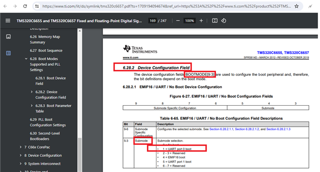

    6.28.2 Device Configuration Field
    The device configuration fields BOOTMODE[9:3] are used to configure the boot peripheral and, therefore, the bit definitions depend on the boot mode.

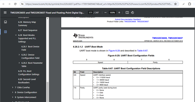

    6.28.2.1.2 UART Boot Mode
    UART boot mode is shown in Figure 6-29 and described in Table 6-67 ----- For speed and parity configurations.
    And I also checked through JATG that the content of the BOOT PARAMETER Table has been set to the corresponding UART BOOT PAYTER parameters.
    Please do check the other configuration settings like speed and parity etc... as I mentioned above...

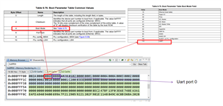

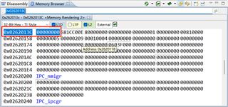

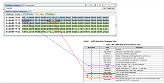

          I have followed you advice, and tested on my development board. Unfortunately, I still can't use uart to boot my board correctly.

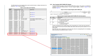

          I see you provided the addrsee of Boot Parameter table in this post ( Where is the boot parameter table in c6657 L2 - Processors forum - Processors - TI E2E support forums) . So .I checked BOOT PARAMETER TABLE, all value I verified  is correct.
    I checked BootMode--Uart,  Uart boot configuretion: Protocol、Data bits 、Stope bits、Parity、DataRate(115200)、etc
    In C6657 data sheet, I see the BOOTCOMPLETE register. so I checked this register value, it is 0x00000000, this means ROM booting process still going.
          Another question
        In this post (C6657 UART boot - Processors forum - Processors - TI E2E support forums) replaied by . He said "5. Power on the board. You will see letter C get typed few time in the console. This is the ping."
        I didn't get a "C" letter in my console. Does this mean the RBL  configured the UART peripheral failed or not.
       Is there any way way can I used to checked why my device boot failed? I would greatly appreciate it if you could provide corresponding methods and suggestions.
      Thank you very much.

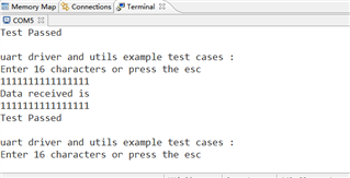

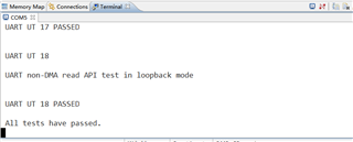

  • Hi, Shankari G
    I followed your suggestion, tested the standard UART example on my custom PCB. The result is that all test have passed.

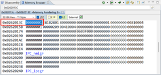

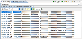

    Would you please post the value of DEVSTAT register?
    i.e., the value at 0x02620020  ???
    The boot mode bits 0-2 should have value, "0" as per my first pic in my previous post.
    Please refer page no: 205, section 8.3.1 https://www.ti.com/lit/ds/symlink/tms320c6657.pdf
    13-1 BOOTMODE[12:0] Determines the bootmode configured for the device. For more information on bootmode, see Section 6.28 and see the Bootloader for the C66x DSP User's Guide
    In the DEVSTAT register,
         Bits[13- 1] maps to BOOTMODE [12:0] ------> i.e., Bits 1,2,3 of DEVSTAT register should have value, "0" for UART mapping to bits 0,1,2 of BOOTMODE
         Bit [0] - is for Little endian / Big Endian
                      ( Check your endian settings too -  the bootstrap value latched through the external pin )
    Shankari G
  • Hi, Shankari G
    Here is the DEVSTAT register value when i connect my custom PCB
    When I expand the value in your DEVSTAT register...
    0x00000011  - Hex value to Binary expansion...
                1 - 0001
                           - 0th bit, value = 1 - Little endian
                           - 1, 2,3 bits, value = 0 - UART - Device Boot mode
                1 - 0001
                          - 4,5,6 bits - value = 1 - Submode selection. - 1 = UART port 0 boot
                         - 7th bit - Value = 0 -- UART parity used during boot. • 0 = None ( 7,8 and 9 bits of DEVSTAT ) --> Check in your code that the parity is NONE
                0 - 0000
                         - 8th bit - value =0 - UART parity used during boot. • 0 = None ( 7,8 and 9 bits of DEVSTAT )  --> Check in your code that the parity is NONE
                        - 9th and 10th bit - value =0 - UART interface speed. • 0 = 115200 baud ( 9 and 10 bits of DEVSTAT )  --> Check in your code that the speed is  115200 baud rate.
                 0 - 0000
    NEXT STEP :-
    ---> Focus on the Clock derived to the UART peripheral during the boot time.
    Page no:85, https://www.ti.com/lit/ds/symlink/tms320c6657.pdf
    SYSCLK7: 1/6-rate clock for slow peripherals (GPIO, UART, Timer, I 2C, SPI, EMIF16, McBSP, and so forth.) and sources the SYSCLKOUT output pin.
    -----> Check the SYSCLK7 while running the UART example and compare it while booting through UART.
    ------> Check at what clock frequency UART is driven in your custom board....
    Shankari G

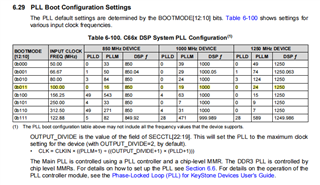

  • Hi, Shankari G
    Great news to tell you. It seems like The UART BOOT MODE start succeed in my custom board.
    We successfully get a leter 'C' and trans bin file.
    Your guide ask me to 'Focus on the Clock derived to the UART peripheral during the boot time.' helps me a lot.
    We found that the INPUT CLOCK FREQ(MHz) we provide for dsp is 100(MHz). But we configured the bootmode as[0b000] .  Actually, this bootmode pin just need 50MHz for dsp. Then, I configured bootmode[12:10] as 0b011, Ican get a leter 'C' on my console .

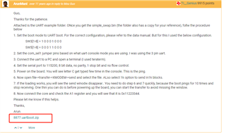

  • Hey Buddy,
    Clock-frequency:-
    That's a great news. Congrats. You are welcome...
    To boot from UART, do not try to boot-and-run the "UART-demo" app.
    Try some simple hello world example ( .out )  and do the conversions....
    Create a simple helloworld example using CCS.
    If you couldn't, please let me know, I shall post you a video on how to do the same...
    Shankari G

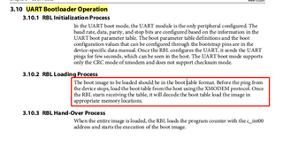

  • Hi, Shankari G
    One more question I want to ask.
    In the the 'DSP Bootloader User Guid', it just descriped the RBL loading process ' Once the RBL starts receiving the table, it will decode the boot table load the image in appropriate memory locations.'
    These days I have read so many user guide file, but I still didn't get any infomation about when I use TeraTerm send bin file to dsp  where the image stored in dsp memory, and the start address to execute my image.(As far as I know, other boot mode used magic address to run  user image).

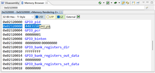

  • HI,
    Attached a video below.
    It has the following.
    1. A sample program creation for C6657 using CCS 9.3
    2. A sample linker.cmd
    3. Some GPIO register settings to confirm your UART boot.
    After your UART boot, connect to CCS,
    Go to memory browser window and feed the GPIO register address as "0x2320000 " .
    Please note that the value is "00000100" in GPIO_bank_registers_out_data.
    #define GPIO_BASE (0x2320000)
    #define GPIO_DIR_OFFSET (0x10)
    #define GPIO_SETDATA_OFFSET (0x18)
    #define GPIO_CLEARDATA_OFFSET (0x1C)
    void testfunc();
    void testfunc()
        while (1)
            asm("   IDLE");
    void main(void)
        volatile uint32_t *reg_val;
         reg_val = (volatile uint32_t *)(GPIO_BASE + GPIO_DIR_OFFSET);
         // configure as output pin -- write 0 to the Direction register
         *reg_val &= ~ (1 << 8);
         reg_val = (volatile uint32_t *) (GPIO_BASE + GPIO_SETDATA_OFFSET);
         // Write value 1 in the set data register, so that Out data register will be 1
         *reg_val |= (1 << 8);
        testfunc();
     // After the UART boot, connect to CCS, open the memory browser window and give address 0x02320000
    // The value of 0x02320014 will be set as 00000100.
    // By this way... you can set some register values........and you can confirm that,  your UART boot is successful.... :- )

    I tried you provided led Demo, compiled successfully, use Tera Term trans bin file successfully, and then connect to ccs, I checked the address 0x02320014. I was not 00000100...
    I remembered there is a register is '(BOOTCOMPLETE) Register ', so I checked this register value. It is 0. So that, the uart boot is not compelete.
    I'm very confused now.
    Do you have any more suggestions.
    Thanks.

    I have download  provided bin file in : (+) C6657 UART boot - Processors forum - Processors - TI E2E support forums
    And then connect to ccs. I checked the (BOOTCOMPLETE) Register  value = 0x00000001, which means uart boot successed.
    So, I guess maybe the reson why I can't boot successfully is the bin file I converted is  incorrect.
