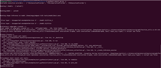

  • Hello Pratik
    Any updates on this. I have uploaded the bin and some files produced during compilation in the zip, you can also find the model inside.
    yolo.zip
    thanks
  • Hi Ramaseshan,
    I thought that the model has 3 operators that are not supported by TIDL. See the figure below:
    -- Joy
  • Hello Joy Yang
    I had put them on deny list and tried out the compilation, but I am facing a exception issue which I have mentioned in the starting, can you take a glance, and kindly try to look at our model, if there is an issue
    Thanks in advance
  • Also I could find more number of subgraph created, can you guide as to solve that too, is there any tool to replace layers graphically?
    Thank you
  • Hello
    We have replaced unsupported ops of tidl with supported tidl layers, but still the compilation stops and crashes.
    I have included the model link and logs for your reference.
    Thanks!

     Graph Domain TO version : 11In TIDL_onnxRtImportInit subgraph_name=output0
    Layer 0, subgraph id output0, name=output0
    Layer 1, subgraph id output0, name=images
    In TIDL_runtimesOptimizeNet: LayerIndex = 179, dataIndex = 187
    WARNING: Batch Norm Layer /model.22/Sub's coeff cannot be found(or not match) in coef file, Random bias will be generated! Only for evaluation usage! Results are all random!
    WARNING: Batch Norm Layer /model.22/Div_1's coeff cannot be found(or not match) in coef file, Random bias will be generated! Only for evaluation usage! Results are all random!
    Error: Layer 126, /model.22/Sub_1:/model.22/Sub_1_output_0 is missing inputs in the network and cannot be topologically sorted
      Input 0: /model.22/Add_1_output_0, dataId=124
      Input 1: /model.22/Sub_output_0, dataId=254
     ************** Frame index 1 : Running float import *************
    In TIDL_runtimesPostProcessNet
    In TIDL_runtimesPostProcessNet 1
    In TIDL_runtimesPostProcessNet 2
    In TIDL_runtimesPostProcessNet 3
    INFORMATION: [TIDL_ResizeLayer] /model.10/Resize Any resize ratio which is power of 2 and greater than 4 will be placed by combination of 4x4 resize layer and 2x2 resize layer. For example a 8x8 resize will be replaced by 4x4 resize followed by 2x2 resize.
    INFORMATION: [TIDL_ResizeLayer] /model.13/Resize Any resize ratio which is power of 2 and greater than 4 will be placed by combination of 4x4 resize layer and 2x2 resize layer. For example a 8x8 resize will be replaced by 4x4 resize followed by 2x2 resize.
    **          2 WARNINGS          0 ERRORS          **
    In TIDL_runtimesPostProcessNet 4
    ************ in TIDL_subgraphRtCreate ************
     The soft limit is 2048
    The hard limit is 2048
    MEM: Init ... !!!
    MEM: Init ... Done !!!
     0.0s:  VX_ZONE_INIT:Enabled
     0.4s:  VX_ZONE_ERROR:Enabled
     0.5s:  VX_ZONE_WARNING:Enabled
     0.1382s:  VX_ZONE_INIT:[tivxInit:185] Initialization Done !!!
    ************ TIDL_subgraphRtCreate done ************
     Warning : Couldn't find corresponding ioBuf tensor for onnx tensor with matching name
    2024-03-22 12:05:15.362450533 [W:onnxruntime:, execution_frame.cc:835 VerifyOutputSizes] Expected shape from model of {1,5,8400} does not match actual shape of {} for output output0
    *******   In TIDL_subgraphRtInvoke  ********
    Segmentation fault (core dumped)
    Model link: 1145.model.zip

  • Per the discussion at: https://github.com/TexasInstruments/edgeai-modeloptimization/issues/2
    Attached a sample yolov8 lite model and training script changes.
    Also includes TIDL compilation options used in edgeai-benchmark in the config yaml file corresponding to thsi config: https://github.com/TexasInstruments/edgeai-benchmark/blob/main/configs/detection_v2.py#L169

    One last doubt in my custom yolov8 model I had 3maxpool layers with kernal shape 5. So I replaced it with 3 maxpool layers with kernal shape 3. But in your example I could see 6 maxpool layers with 3 kernal shape. Can you please assist me regarding this. Also kindly look out my custom model zip I attached in this thread up
    thank you
  • kernel_size 3 is what is supported for Maxpool currently in TIDL.
    This was trained and by using the option --model-surgery 2 to the train.py script that I shared and the model optimization tool takes care of the layer changes such as changing activation layers from SiLU to ReLU and breaking down large Maxpool to 3x3.
    Other wise you can compare both the onnx graphs and understand the exact changes.
  • Hello
    How many 3x3 max pool layers is required to replace one 5x5 maxpool layer?
  • Hi
    Two 3x3 max pool is required to replace one 5x5 maxpool. See more details at https://github.com/TexasInstruments/edgeai-yolov5.
    --Joy
