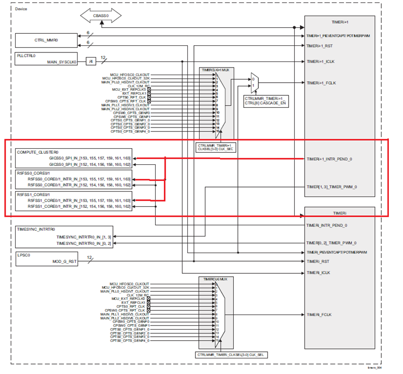

Actually, what settings do I need to make in order for CA53 to route timer interrupts to CR5?
I can't really understand it by looking at TRM, so please tell me the API etc.

    When you set a timer interrupt in MAIN domain (say CA53 or CR5) then the generated interrupt will go to all the cores of MAIN domain. It does not matter which core is used for timer initialization and setting , once the interrupt is generated it goes to all cores in MAIN domain. The core for which the interrupt is registered triggers the callback function and others will just ignore it.
    Please see the Figure 12-2472. TIMER Integration of the TRMPlease refer to below image for details.
    What registers or APIs should I check to see if interrupt routing is configured correctly?
    To see the API related to Timers, please refer KERNEL_DPL_TIMER_PAGE.
