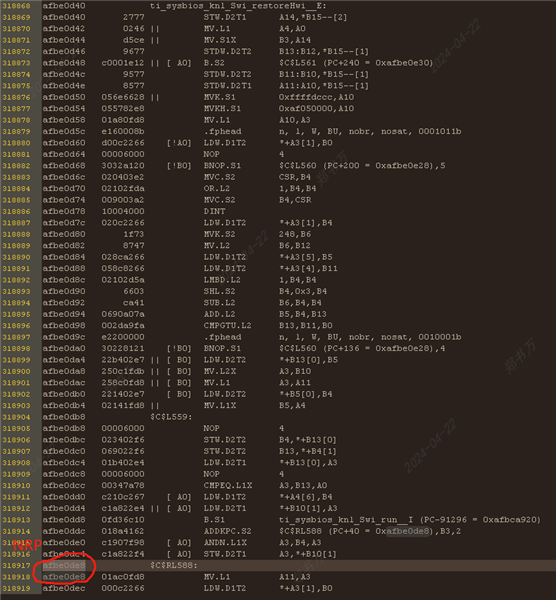

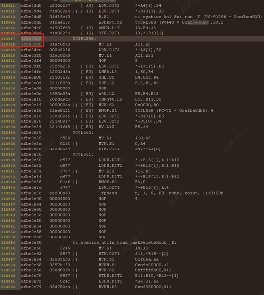

2. Through the NRP register record, the instruction show as follows:"MV.L1 A11,A3 "

The reason opcode exception
The OPX exception should fire when we encounter a 32-bit word that is fetched as an instruction to execute, but when we decode the instruction, we find it is not a valid instruction. This usually happens if program memory has been overwritten with data or a branch target goes off into the weeds somehow into a data section.

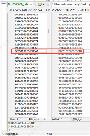

1. Exported memory of text segment when excaption occur; then after device rebooted, exported again, compared above text segment , not found any error.
2. Also,exported L2,L1P,found the NRP memroy,not found any error:

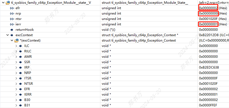

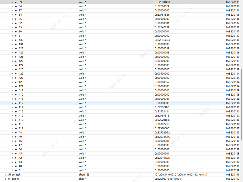

Hi, TI Experts, TDA4VM aboted again, show as follows:
1. Checked with CCS, found that C661 has crashed, with the crash caused by an Instruction Fetch Exception (IERR=0x1,NRP=0x0,B3=0xB2E40200).
2. When comparing the memory of exception and normal case,found both memory were same
A. when device exception,through CCS, saved the memory of C661
B. When device normall,through CCS, saved the memory of C661
3. The NRP=0x0 and B3=0xB2E40200, can‘t find why the PC address are changed to 0x0.
