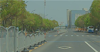

Is there chromatic aberration in some parts of the image, such as the stop line being partly white and partly blue, due to CFA issues? Is there any solution? Thank you very much!!! As follows:
I am not sure if I understand the question.
What is a "stop line"?

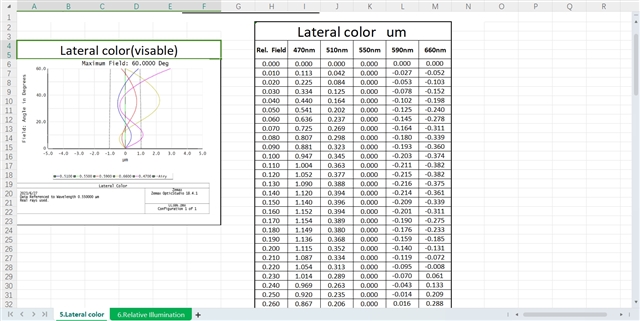

Chromatic aberration does not happen at image center.
So, you may check if the issue happens just around image corners or also at image center.
In general, line artifacts could be due to over sharpening, demosaicing, or WDR back lighting.
Thanks Adam!
I now understand the issue.
While that white line is far away, it may appear as green or yellow occasionally.
It seems related to color aliasing, white balance and demosaicing rather than chromatic aberration.
Is it possible to share some raw/yuv images so that we can reproduce the issue?
Please fix the white balance issue (road payment looks green) first if possible.

This looks like can be improved by CAC
Please try CAC tuning.
