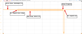

we have an issue with GPIO output state not being preserved while in Deep Sleep mode.
This is related to previous questions on the topic:
 - https://e2e.ti.com/support/processors-group/processors/f/processors-forum/1360238/am625-peripherals-goes-into-reset-state-when-processor-goes-into-deepsleep-mode/5189677#5189677
 - https://e2e.ti.com/support/processors-group/processors/f/processors-forum/1207903/am625-sdk-08-06-00-42-kernel-5-10-gpio-state-on-deep-sleep/4571452#4571452
Our current need and expectation is that any GPIO configured as output is going to keep its state when the system goes into suspend and afterward resume without any glitches.
We are running the latest TI SDK SW 09.02.01.09 on a custom HW.
We are currently measuring GPIO GPMC0_AD2 (as an example), this pin has a 2.2kOhm pull-down on the board (-> it's a strap option).
What is happening is that the Linux software is driving this pin as high, and the pin goes to low as soon as the board gets into suspend (not sure if this is because the pin gets configured as input, because of the pull-down, of if this is actively driven as output). The expectation and the need is that the pin stays to a stable state and that this state is high in suspend.
We did check the pad configuration and everything seems as expected:
# devmem2 0xF4044 w
/dev/mem opened.
Memory mapped at address 0xffff838c2000.
Read at address 0x000F4044 (0xffff838c2044): 0x00050007
Any suggestion?

  • Hi ,
    Just realized that above test with a user LED might not be as relevant, considering the fact that LED subsystem might turn LEDs off in low-power mode. Requesting to kindly ignore my above response and consider below test and findings instead.
    I retested the SOC GPIO behavior with a EXP_GPIO0_42 present on 'User Expansion Connector (J3)' with all the latest SW images as mentioned in above response on AM62-SK board across deepsleep cycle.
    Configured EXP_GPIO0_42 as GPIO with pull-up enabled using devmem and could see GPIO toggle on oscilloscope with a simple commands below.
    root@am62xx-evm:~# gpioset gpiochip0 42=1
    root@am62xx-evm:~# gpioset gpiochip0 42=0
    For the test, I set GPIO0_42 high and try to keep device in deepsleep. I expect GPIO0_42 to remain high for a complete deepsleep cycle persisting it's last configured state throughout .
    I observe the similar behavior where GPIO0_42 goes low/down for the time of the device deeplseep and goes high again as soon as device wakes up from a deepsleep. This is not expected.

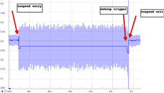

  • Hi Parth,
    Do you have a measured voltage for low? From my tests so far, it will drop slightly (3.3V -> 3.27V). Have you seen the same behavior on MCU GPIO pins?
    Anshu
  • Hi ,
    Thank you for response.
    Yes, I have measured the voltage at GPIO0_42 and I see voltage drops to '0V' for the time device is in deepsleep.
    I did not test MCU GPIO. This is not much relevant for us. We want all the GPIOs (Main/MCU) to persist it's state for a complete suspend-to-ram cycle.

    For Main Domain GPIO0_42:
    Active Power Entering Deep Sleep At Deep Sleep Exiting Deep Sleep after Wakeup Trigger Active Power after Wakeup
    3.3V 3.27V 3.27V less than 10mV (?)
    3.3V
    The voltage drop during the wakeup sequence is unexpected.
    I discussed internally about the PADCONFIG behavior. If bit24 is set to zero, then the IO states will carry over from Active state into Deep Sleep. If bit24 is set to one, then the IO states will use what was defined in bits 25-30. This might be a variable to review.
    I don't have a solution at this moment, but will continue working on it.

  • Hi fd,
    Here is the most recent experiment.
    For a GPIO without an external pull resistor, we were able to reduce the voltage drop by changing the PADCONFIG register for the GPIO. We set Bit16=0, Bit17=1 of the PADCONFIG register so the internal, non-DeepSleep resistor is pulled high. There were no other changes to the bit fields.
    Here is the O-Scope measurement.
    We tested this using the default SDK 9.2 image and used RTCWake with a 10 second interval. The only change is to the device tree to add the pinmuxing for the GPIO.
    Anshu
