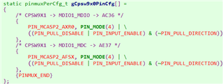

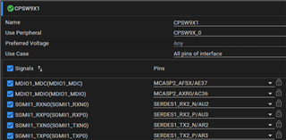

In addition, after I configured the pin through the sysconfig tool, I could not find the corresponding pin pin configuration in the generated file(J784S4_pinmux_data.c/devicetree.dtsi).
Only MDC/MDIO pin configurations are available
my pinMux config:
How can I use SGMII1? Is there any sample code?

    SGMII Pins are from SerDes not from CPSW.

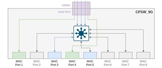

    SGMII1 corresponding to MAC Port-1 of CPSW9G.

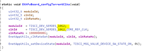

    If RTOS based EthFw, you need to change the MAC Port Configuration, SerDes configuration, PHY Driver adding to PDK.
    Please refer to below E2E for RTOS based SGMII support.

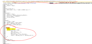

    If Linux Native Driver, you need to update device tree overlay for CPSW9G with SGMII and configure the SerDes for SGMII.
    Please refer to below E2E for Linux based SGMII support.
    https://e2e.ti.com/support/processors-group/processors/f/processors-forum/1216735/tda4vh-q1-four-sgmii-port-setting-in-linux-native-driver

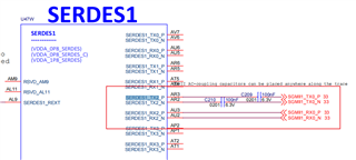

    1. The connection diagram and hardware schematic are as follows:
    CPSW9G--SERDES1--SGMII1(PIN:AR3/AR2/AU3/AU2)---PHY(RTL9010)----1000m Transfer box---PC
    Q1: Is the configuration of SERDES1 and SGMII1 in CPSW9G done in the Linux SDK or in the RTOS SDK? From the link, it can be seen that the final steps are all related to configuring MCU2-0.
    Q2:How to set the clock for SERDES1 (SGMII1) and configure SERDES1 (SGMII1)?
    Q3: Does SGMII1 correspond to MAC PORT1? Is the corresponding portNum within the software the software's PORT0?

    Current practice: After fixing the following, the driver configuration of phy_rtl9010 can be read. PHY 1 is alive for RTL9010.

    You have to set SerDes1 clock, In case of MCU2_0 we are setting clocks for SerDes2, please change the SerDes number to SerDes1 from TI SDK.
    Change below to 10G1 for SerDes1. Default it was for SerDes2 as per TI EVM.
    If in case of Linux SerDes1 node is available in main.dtsi, need to reference this node and configure SerDes1 for SGMII.
    Yes, SGMII1 correspond to MAC PORT1. Which is external Port-1.
    Software Port0 means Host Port. Port1 will be MAC Port1.
    Q4: How to ping SGMII1 for tda4vh through the PC end?
    Default MAC PORT1 is mapped to A72 Linux client as MAC only Port in Ethernet Firmware.
    If you connect DHCP network, eth2/eth3 on A72 gets IP address, You can ping that IP from PC on the same network.
    In Native Linux Driver it will be one of Network interface as per configuration.
    Q5: Where do eth2 and eth3 in ifconfig of TDA4VH correspond to?
    eth2 and eth3 are virtual Port configuration of A72 client as your running MCU2_0 with Ethernet Firmware.
    One will corresponds to virtual switch interface (from this you can connect to any of switch ports connected network), another one will be virtual MAC Port interface it will acts as MAC Only Port.
    From MAC only Port you can communicate to only the Port-1 connected network.
    For more details about switch Port and MAC Port, Please refer to Ethernet Firmware User Guide.

    hi,
    Q1:According to your suggestion, after changing the parameter to 10G1, the MCU2-0 process hung up.And eth2 and eth3 no longer exist.
    Changecode:
    static void EthFwBoard_configTorrentClks(void)
    uint32_t moduleId;
    uint32_t clkId;
    uint32_t clkRateHz;
    moduleId = TISCI_DEV_SERDES_10G1;
    clkId = TISCI_DEV_SERDES_10G1_CORE_REF_CLK;
    clkRateHz = 100000000U;
    EnetAppUtils_clkRateSet(moduleId, clkId, clkRateHz);
    EnetAppUtils_setDeviceState(moduleId, TISCI_MSG_VALUE_DEVICE_SW_STATE_ON, 0U);

  • hi,
    If you are using custom board, you need to make changes as per your board. Ethernet Port configuration, PHY Address, interface mode..etc.
    I am currently using a customer board,The configuration connection is as follows:
    Q1:How to configure SERDES1-- SGMII1 to SGMII mode, which configurations need to be modified, or provide a demo example?
    Q2:Ethernet Port configuration,Which configurations need to be modified or provide demo examples?
    Q3:PHY Address, interface mode,Which configurations need to be modified or provide demo examples?
    Best Regards

    clk config:
    uint32_t moduleId;
    uint32_t clkId;
    uint32_t clkRateHz;

  • I have already annotated the original one(SERDES2).
    now code below:
    uint32_t moduleId;
    uint32_t clkId;
    uint32_t clkRateHz;

    hardware connection:
    Is the above configuration okay?

    @@ -542,8 +566,8 @@ static void EthFwBoard_configTorrentClks(void)
    uint32_t clkId;
    uint32_t clkRateHz;
    - moduleId = TISCI_DEV_SERDES_10G2;
    - clkId = TISCI_DEV_SERDES_10G2_CORE_REF_CLK;
    + moduleId = TISCI_DEV_SERDES_10G1;
    + clkId = TISCI_DEV_SERDES_10G1_CORE_REF_CLK;

    Can you please check have you configuring the SerDes1 from Linux or U-boot? If so, can you disable the SerDes node from device tree.
              Where can I modify this part? Can you provide a path or method.
    Are you running Linux on A72? If so, by default SerDes1 is configured for PCIe.
    Please refer to below.
    Please make status as "disabled" as show in below under "&serdes1" and "&serdes_wiz1" and rebuild "linux-dtbs" from Linux SDK.
    status = "disabled";
    Command for building device tree.
    # make linux-dtbs
    After building the Linux-dtbs, copy k3-j784s4-evm.dtb generated in above dts path to the your "rootfs/boot/dtb/ti" folder in filesystem.
    +    clkRateHz = 100000000U;
    +    EnetAppUtils_clkRateSet(moduleId, clkId, clkRateHz);
    +    EnetAppUtils_setDeviceState(moduleId, TISCI_MSG_VALUE_DEVICE_SW_STATE_ON, 0U);

    Q2: How can I ping my PC through MAC_PORT1 now?
    In Linux A72, you can see two network interfaces for Virtual Switch interface one and other for virtual MAC Only Port.
    Default Port-1 is configured for MAC Only Port and mapped to A72 client as virtual MAC only Port from "gEthApp_virtPortCfg" & "gEthApp_allocCfg".
    You can assign the IP to the those interface in same domain & remote PC connected to MAC-Port1 also assign IP in same domain.
    Can ping from PC to TDA4 IP, Ping should success for virtual MAC interface IP.
