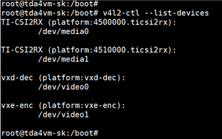

I am debugging ds90ub960&ds90ub953 serdes camera:
I add k3-j721e-sk-fusion.dtbo and  k3-fpdlink-imx390-rcm-0-0.dtbo to name_overlays in  uEnv.txt.
But after power-on, there is no newly created video2 node in /dev directory ( /dev/video2 not exist).
Can you help why  /dev/video2 is not created?
Thanks.
  • Hi Chenglei Yang,
    If you run `dmesg | grep imx390` or `lsmod | grep imx390`, does anything appear?
    i.e. Was the imx390 device probed?
    Jared

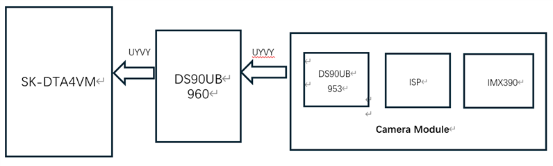

    our camera fmt is UYVY8_1X16.
    How to change ds90ub953&ds90ub960 fmt from SRGGB12_1X12 to UYVY8_1X16  ?????

  • Hi, :
      Our application is:
    I had refered to the related thread:
     https://e2e.ti.com/support/processors-group/processors/f/processors-forum/1162037/tda4vm-some-errors-when-using-imx390-from-otobrite-on-linux
    So far,  I can change format to "UYVY8_2X8/1920x1080"  by command "media-ctl -V". The reason is that the newest version dos not include the "UYVY8_2X8" option.
    Now, the format is OK, graph relation is OK,too.  But I can not get a frame by command  "yavta -c -Fcapture -s 1920x1080 -f UYVY /dev/video3".
    I still need your help eagerly.
