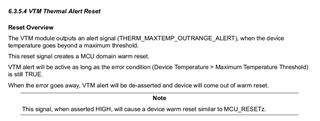

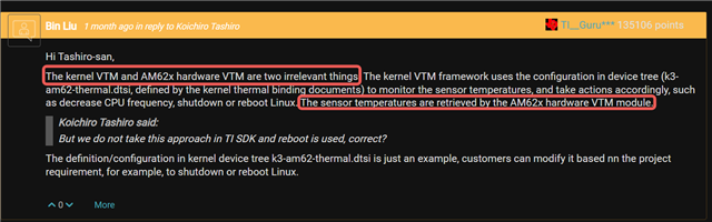

Hello,Sreenivasa
I understand the configuration you mentioned, but DTS is configured with a thermal shutdown mechanism on Linux. I would like to know the thermal shutdown mechanism on the VTM hardware module. As discussed below:
I don't seem to have found any temperature zones for VTM hardware module monitoring.
Hello Xue Fadong,
You can go through the section 6.3.5.4 of AM62A TRM to get more details on how the VTM module can issue an SoC reset.
Nihar Potturu.

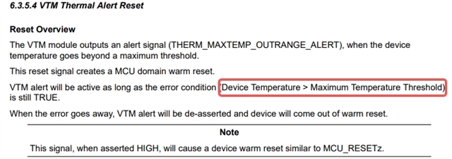

Hello,Nihar Potturu
Thank you for your response!
I am unable to retrieve the reset based on which temperature zone from that document. What specific temperature zone does device temperature refer to? There are three temperature zones on SOC.

Please refer below.
The VTM also has a hardware alert signal that indicates a fault when any of the below sensors detect the device is nearing the maximum temperature allowed.
In AM62A, the numbering is:
Temp Sensor 0: c7x
Temp Sensor 1: A53
Temp Sensor 2: DDR controller
This alert can be used to reset the device or part of the device to reduce the temperature. This alert is not a standard interrupt and so it does not include the usual set, clear, and enable features. It does include an overall enable MMR bit
Table 14-7450. MMR_VBUSP_CFG2, MMR_VBUSP_CFG2 Registers, Base
VTM_MISC_CTRL
along with enables per sensor
14.2.2.2 VTM Registers
Table 14-7449. MMR_VBUSP_CFG1, MMR_VBUSP_CFG1 Registers, Base
The VTM module outputs an alert signal (THERM_MAXTEMP_OUTRANGE_ALERT), when the device
temperature goes beyond a maximum threshold.
This reset signal creates a MCU domain warm reset.
VTM alert will be active as long as the error condition (Device Temperature > Maximum Temperature Threshold)
is still TRUE.
When the error goes away, VTM alert will be de-asserted and device will come out of warm reset.
Note
This signal, when asserted HIGH, will cause a device warm reset similar to MCU_RESETz.
