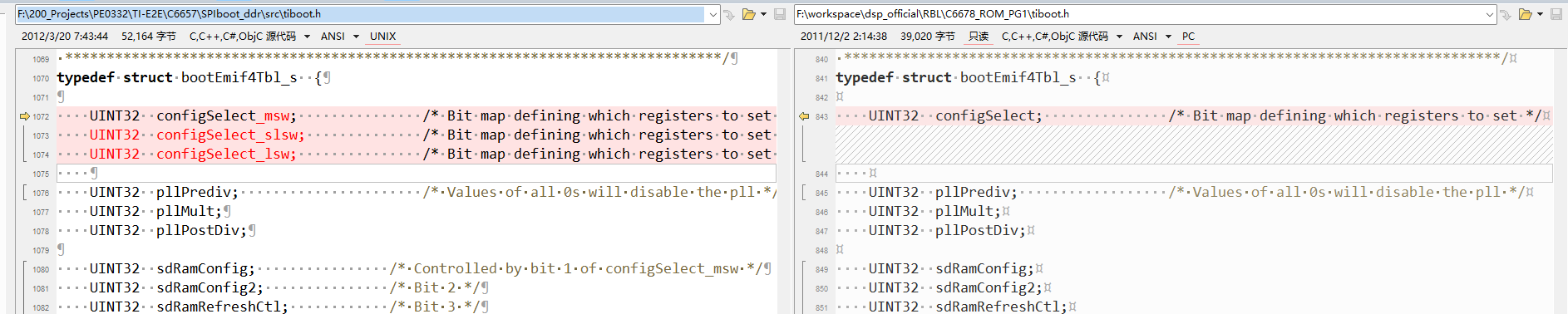

    Since I didn't find C6678's C6678_directROM_boot_examples.zip, I used 0435.C6657_directROM_Boot_example.zip that you provided to me.
    But there are some question:
    1. The bootEmif4Tbl_s defined in the example is different from RBL(C6678), is that a problem for C6678's RBL to bootloader the example's image?
     The value of "emif4Cfg" in the spiboot.c in C6657's example is not suitable with C6678, did you find the C6678_directROM_boot_examples.zip ? I think that would be much better.

    2. The emif4Table defined in  C6678's RBL souce code, which is located to the ".ddr3Table" in C6678_ROM_PG1\main\mainemif4cfg.c, BUT I can't find where is the ".ddr3Table" defined in the RBL, and  what is the dest address of it.
    #pragma DATA_SECTION (emif4Table, ".ddr3Table")
    #pragma DATA_ALIGN (emif4Table, 4)
    BOOT_EMIF4_TBL_T emif4Table;
