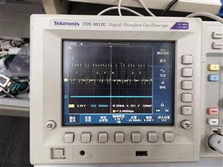

  1. The CLK is not regular or stable, which will cause the data to write or read is NOT correct. (channel 0 is CLK, 1 is SDI, 2 is CS, 3 is SDO)
    1. If CLK is set more than 7M HZ, then the clock output seems not correct as below snapshot. And MCSPI_transfer can NOT write/read correct data in all time.
    2. If CLK is set less than 7M HZ, the clock output is also not regular(duty cycle is variable), in this situation, MCSPI_transfer sometimes can read/write correct data, but it still will read/write error data.
FYI, below snapshot is clock waveform that captured from Oscilloscope.

  • Add snapshot for the mcspi_loopback_am64x-sk_r5fss0-0_nortos_ti-arm-clang running on TI Demo Board.
    The duty cycle of CLK(channel 1, 25M Hz) is perfect(50%).
  • The left SPI EEPROM snapshot is captured from TI Demo Board, the right SPI FRAM snapshot is captured from our Demo Board,
    The difference is that SPI CLK is pulled down by our Demo Board, and SPI CLK is pulled up by TI Demo Board.
    I am not sure if it has impact to duty of CLK.

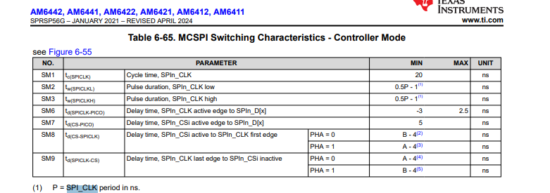

    .inputClkFreq       = 50000000U,                // hard coded as 50M. I tried change it manually here, for example, to 200M, but it seems no effect
    I believe the maximum frequency that can be set is 50 MHz. This can be seen from the attached datasheet information:
    Here is my explanation:
    Minimum is 20 ns which is 50 MHz and you can go further than 20 ns but that means your frequency basically will be <= 50 MHz, so you cannot set it to 200 MHz for sure.

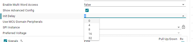

  • Hello Vaibhav,
    I tried Init Delay with 4/8/16/32, it is still failed if CLK > 7M Hz.

    I see the clock output in the scope trace above.
    Can you please capture 2..3 cycles in a scope capture and share.
    Sreenivasa
  • Hi Sreenivasa,
    See below snapshot, I am not very sure if it is what you want. It has 2 CS cycles, failed as it worked at 8M Hz

    We may have no chance to add a series resistor 22 R near the SOC as our hardware engineer pointed out.
    We tried another way, remove the 22 R resistor on 6422 board and run same test. It passed the test with 50M Hz CLK.
    Another point, 2 clock waveforms were captured on 6421 board.
    One is 6.25M Hz as below snapshot.
    Another is 25M Hz as below snapshot

  • Hello All,
    A good news, the issue was found and fixed. It passed loop back test with 50M Hz.
    It is a PCB layout issue as below snapshot, C625 does not connect to GND in PCB layout which lead power supply is not stable.
    Thank you all for great support!
