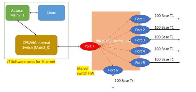

Hi TI Team,
We are using PSDK7.3
Below is the our SW architecture, Where data from External switch (port 7) is copied to Port 7 of internal Switch.
Usecase:
Ingress Port mirroring is enabled in external switch for ports 1 and 2,
Ingress monitoring destination port is PORT 7 of external switch.
CPSW9G Port 7 will receive the data and pass to Main2_1 core.

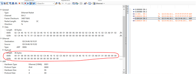

Port1 is sending ARP request (broadcast) on network.
Port7 and Port 2 will receive the data.
Port7 successfully forwarding this request to Main2_1.
Port2 replied with unicast packet, This will go to Port1 and also Port 7( because of port mirroring feature).
Issue:

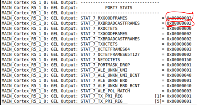

CPSW-9G is not passing this unicast packet to Main2_1.
We verified the statistics in CPSW-9G, it confirms it received it, but not Main2_1.
In Main2_1, we have the ISR function where we are incrementing the counter for each frame.
it confirms only broadcast received and not unicast.
Please help us to debug further.

    Port mirroring will egress the packet from destination mirrored port.
    Here, packets ingress from Port-1, Port-2 are egresses from Port-7.
    Please refer to FAQ for more details.
    https://e2e.ti.com/support/processors-group/processors/f/processors-forum/1283294/faq-tda4vm-how-do-i-configure-enable-port-mirroring-in-cpswng

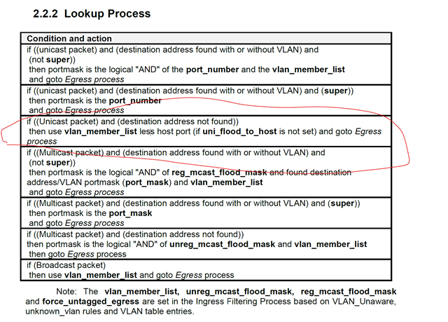

    Also, Uni-cast packet will be forwarded to single Port as ALE has Port number not a Port Mask. So, packets can only send to one Port from ALE.
    If Uni-cast MAC is intended for Host Port then only Host Port will receive.

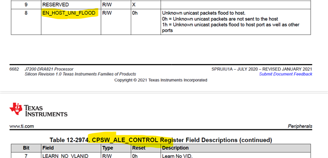

    We can flood unknown unicast packets to Host Port.
    But, it is not recommended as if we enable, all unknow unicast packets will be forwarded to Host Port.
    Sudheer
  • Hi Sudheer,
    May i know where to enable this ?
    We will just check whether it will meet our requirements or not.
    Venu H
    You can try by enabling EN_HOST_UNI_FLOOD from CPSW ALE Control register.

    Point 1 didn't work,
    Will update the patch and share the data ASAP.

    Please find the FAQ for collecting CPSW stastics.
    https://e2e.ti.com/support/processors-group/processors/f/processors-forum/1220277/faq-tda4vm-how-to-get-cpsw-ethernet-statistics-on-tda4-dra8-devices
    Enable dump of ALE and Classifier as well.
    Sudheer

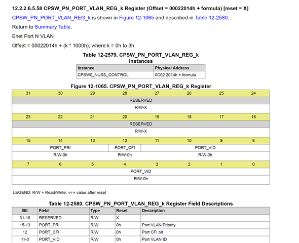

    TI will share details of CPSW registers to check for Default Ports VLAN.
    Aptiv need to try using this and create an ALE & Policer entry for Port-7 VLAN and forward to MCU2_1.
    FAQ for ALE & Policer configuration for remote client (A72 (MPU1_0), instead of MPU1_0 you need to use for MCU2_1.
    https://e2e.ti.com/support/processors-group/processors/f/processors-forum/1011237/faq-tda4vm-how-to-configure-cpsw-5g-9g-ale
    CPSW register details for Port VLAN. Below k range from 0 to 7 corresponding to Port-1 to Port-7.

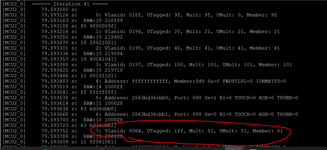

    We added VLAN configuration as below,
    static int32_t EthApp_addMcu21StaticCfg(Enet_Handle hEnet,
    uint32_t coreId,
    uint32_t flowId)
    CpswAle_SetPolicerEntryInArgs polInArgs;
    CpswAle_SetPolicerEntryOutArgs polOutArgs;
    Enet_IoctlPrms prms;
    int32_t status;
    CpswAle_VlanEntryInfo inArgs;
    uint32_t outArgs;
    /* Add VLAN entry */
    memset(&inArgs, 0U, sizeof (CpswAle_VlanEntryInfo));
    inArgs.vlanIdInfo.vlanId = 100;
    inArgs.vlanIdInfo.tagType = ENET_VLAN_TAG_TYPE_INNER;
    inArgs.vlanMemberList = (1 << CPSW_ALE_MACPORT_TO_ALEPORT(ENET_MAC_PORT_7)) | CPSW_ALE_HOST_PORT_MASK;
    inArgs.unregMcastFloodMask = (1 << CPSW_ALE_MACPORT_TO_ALEPORT(ENET_MAC_PORT_7)) | CPSW_ALE_HOST_PORT_MASK;
    inArgs.regMcastFloodMask = (1 << CPSW_ALE_MACPORT_TO_ALEPORT(ENET_MAC_PORT_7)) | CPSW_ALE_HOST_PORT_MASK;
    inArgs.forceUntaggedEgressMask = 0x1ff;
    inArgs.noLearnMask = 0U;
    inArgs.vidIngressCheck = true;
    inArgs.limitIPNxtHdr = false;
    inArgs.disallowIPFrag = false;
    ENET_IOCTL_SET_INOUT_ARGS(&prms, &inArgs, &outArgs);
    status = Enet_ioctl(hEnet, gEthAppObj.coreId, CPSW_ALE_IOCTL_ADD_VLAN, &prms);
    if (status != ENET_SOK)
    appLogPrintf("%s() failed ADD_VLAN ioctl failed: %d\n", __func__, status);
    polInArgs.policerMatch.policerMatchEnMask = 0U;
    /* Add policer entry for port 7 match */
    polInArgs.policerMatch.policerMatchEnMask = CPSW_ALE_POLICER_MATCH_PORT;
    polInArgs.policerMatch.portNum = CPSW_ALE_MACPORT_TO_ALEPORT(ENET_MAC_PORT_7);
    polInArgs.policerMatch.portIsTrunk = false;
    polInArgs.threadIdEn = true;
    polInArgs.threadId = flowId;
    polInArgs.peakRateInBitsPerSec = 0U;
    polInArgs.commitRateInBitsPerSec = 0U;
    ENET_IOCTL_SET_INOUT_ARGS(&prms, &polInArgs, &polOutArgs);
    status = Enet_ioctl(hEnet, gEthAppObj.coreId, CPSW_ALE_IOCTL_SET_POLICER, &prms);
    appLogPrintf("Failed to register PORT 7 policer: %d\n", status);
    if (status == ENET_SOK)
    ENET_IOCTL_SET_NO_ARGS(&prms);
    status = Enet_ioctl(hEnet, gEthAppObj.coreId, CPSW_ALE_IOCTL_DUMP_TABLE, &prms);
    status = Enet_ioctl(hEnet, gEthAppObj.coreId, CPSW_ALE_IOCTL_DUMP_POLICER_ENTRIES, &prms);
    return status;
    We can see corresponding VLAN entry in ALE dump.
    But still the issue is same, any other things we have to taken care ?
    Venu H

    ALE and Classifier are fine, Along with these you need to make following changes.
    1. You need update Port-7's VLAN address as 100.
    2. Also, you need to enable, flood un-known unicast to Host Port.
    Please refer to below ALE lookup process for un-known uni-cast packets.

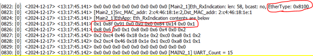

  • Hi Sudheer,
        We will check above update, but we changed the code to allow all Rx all for MCU2_1 then looks like working fine for now. please check and correct us if any modification or fine tune required and we tested this any frame VLAN or Non VLAN or any random frames getting received in MCU2_1.

    we are observing some issue with Ethertype and Payload.
    Ethertype is always reporting 0x8100 and extra 12 bytes are added in the payload.
    Can you please help to analyse this ?
    Venu H
    As I have informed above, "setting Rx filter all" is not recommended.
    If packet size is smaller then CPSW H/W append the dummy bytes to make packet size minimum of 64B.
    Ether Type 0x8100 might be because of packet is VLAN tagged
    Sudheer
  • Hi Sudheer,
    But if you see the above screenshot, Length reported from CPSW is 58 bytes, i mean only 12 bytes are added extra.
    But we didn't added VLAN tagging explicitly. May i know which function we need to check for VLAN tagging is done or not ?
    I could not find Eth_RxIndication API as captured in below. Might be added by your self. Please check how you are printing the information.

    Current issue we are seeing related to EtherType and payload.
    In Eth_irq.c file, we have interrupt processing Eth_RxIrqHdlr_0, it will call Eth_processRxPkt(),
    In turn it will call EthIf_RxIndication(), here i am printing the Data we received.
    Can you please create a new thread related to this.
