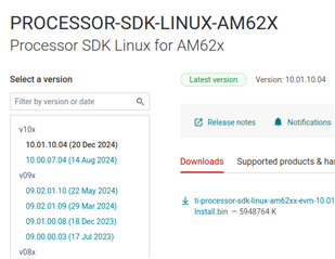

Please use the U-Boot and kernel from SDK10.0 on your board to see if you still have the kernel panic problem.

The U-Boot doesn't sound like coming from the Processor SDK. The U-Boot provided in SDK v9.x is based on tag 2023.04, while the U-Boot provided in the SDK v10.x is based on tag 2024.04.
Please use the U-Boot package provided in the Processor SDK to see if the kernel panic still happens.
Switched to 2023.04 and still have the same problem:
