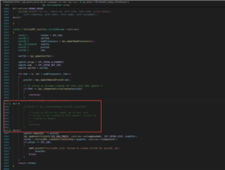

when I disable like this:
The error message disappeared, But the linux still boot up!.
I use the default DM, and there is no error.
I use the vision_app mcu1_0. And there have resouce_table in main.c
Why for this?
Best Regards
Eason

  • Hi,Nilhil
    Thanks for your reply.
    I was so excited that you asked me a few key questions! Thank you so much!
    Let me explain my idea:
    In your boot flow, the SBL loads the DM firmware with Boot app on mcu1_0, so u-boot is not loading the same anymore right?
    SBL load mcu1_0 app (vision app mcu1_0), this is DM firmware. But in u-boot is not load the same firmweare. you rae right.
    Is there a plan to communicate to other cores why IPC in the future?
    Yes! I need IPC.
    This is the problem I'm encountering now!
    In linux device tree, I must be enable follow nodes for linux kernel can creat virtio for mcu1_0 then linux can communicate with mcu1_0 through virtio:
    But when I enable these nodes,   linux kernel boot abnormality. but also can not creat virtio for mcu1_0.
     the log is:

    If i disable the nodes, linux boot  normally, But can not use ipc.
    So how can I solve this problem?
    Best Regards
    Eason
  • Hi,Nikhil
    Do you have any suggestion for this?
    Best Regards
    Eason
  • Hi, Nilhil
    I know why, from my debug in kernel. This is because kernel load mcu1_0 resource_table error,  Memory overflow.
    But I don't know why kernel load mcu1_0 resource_table error.
    Can I create a resource_table that is exactly the same as mcu1_0 in the kernel driver, and then assign the value when the kernel loads the mcu1_0 resource_tabel?
    Best Regards
    Eason
  • Hi Eason,
    IPC initializations would be happening within the MCU1_0 vision_apps firmware.
    Can you let me know what are the soft links for firmwares in /lib/firmwares in SD Card?

  • 【continue....】:
    Using the above method, Ipc_isRemoteReady(IPC_MPU1_0) cannot be used to determine whether Linux is ready, because the Linux kernel uses the C6X resource table when loading the resource table (mcu1_0 also borrows the c6x resource table), so in the IPC driver, I modified the relevant functions, and Linux has been started by default:
    If I don't do this, I can't use VirtioIPC_createVirtioCorePair to create it for linux. However, I found during the actual debugging process that after I modified the above driver, when I used VirtioIPC_init, the program carsh
  • If I don't modify the driver, I won't be able to initialize using VirtioIPC_init for linux, causing RPMessage_announce(IPC_MPU1_0, rpmsg_tx_endpt, "rpmsg_chrdev") to fail
    Ipc_isRemoteReady
    This API is definitely needed to ensure the R5F core announces the end point to linux after linux is running on A72 core.
