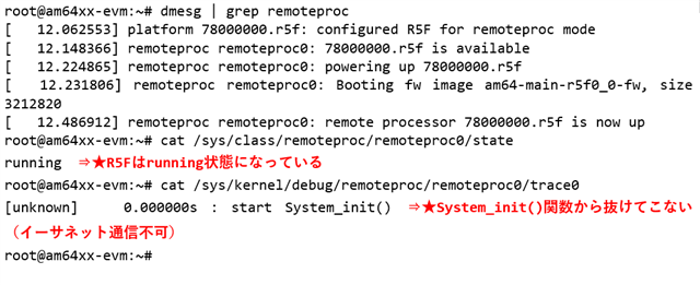

My customer is trying ethernet on the EVM with the following configuration:
  • A53: Linux
  • R5F0-0: RTOS (A53 remoteproc intializes core)
Could you give steps on how they can implement this? They tried combining some of the sample code provided, but could not get it working.
I have asked them to refer to the thread below, but because they are on Linux sdk v.10, they could not get the steps working.
https://e2e.ti.com/support/processors-group/processors/f/processors-forum/1290012/am6442-running-enet_icssg_layer2-example-on-r5f-in-combination-with-linux
Could you give step-by-step to help customer get it running?
The steps they have tried on their own are as follows: (General idea is adding Enet(ICSS) function to ipc example)
  1. Import ipc_rpmsg_echo_linux example
  2. Add Enet(ICSS) EEPROM and I2C
    1. In Sysconfig, add peripherals and match them to enet_lwip_icssg sample
  3. Build and debug
    1. They copied the outputted file to SD card's /lib/firmware and booted SD card
They've also added the devicetree file. https://e2e.ti.com/cfs-file/__key/communityserver-discussions-components-files/791/4857.k3_2D00_am642_2D00_evm.dts

  • Hello Tsunoda-san,
    The E2E you have referred to above is the correct place to start. I will list down the steps in more detail below for the customer to use it with SDK v10:
    MCU+ SDK example modifications:
    1. All the modifications needed in the example are listed on this page: https://dev.ti.com/tirex/explore/node?node=A__AScRgxl3hmonfFqU7DrFFw__AM64-ACADEMY__WI1KRXP__LATEST
    Note: Since the auto-generated linker file is not used by enet_lwip_icssg example, the changes made in Update linker file page will have to be applied manually.
    2. Rebuild the example to get the .out file, copy this file to the /lib/firmware/ti-ipc of the root partition.
    Processor SDK modifications:
    1. Device tree changes - Set 'status = "disabled";' for all ICSSG related nodes in the device tree.
    It would be easiest to replace all the content of the icssg nodes with status = "disabled". Consequently, the respective pinmux settings of all nodes will have to be removed as well. See my reply here.
    2. Resource configuration changes - Update the <ti-u-boot-folder>/board/ti/rm-cfg.yaml file to assign the PKTDMA channels for PRU Ethernet to R5F instead of the Linux A53 cores
    Update the rm-cfg file using the resource partitioning tool, follow the detailed steps present here. Copy the generated file and replace the existing one with this.
    Note: The steps in the link above are for R5F0_1 core, make sure to add the resources to MAIN_0_R5_1 (means R5F subsystem 0 core 0).
    3. Compile and build the modified k3-am642-evm.dts file to generate corresponding .dtb file with "make linux-dtbs". Replace it in /boot folder of the SD card root partition.
    4. Build u-boot and sysfw to generate the tiboot3.bin file with "make u-boot sysfw-image". Replace the tiboot3 in the SD card boot partition with our generated file.
    Booting remote core from linux:
    Follow the steps from here to boot remote core R5F0-0 from Linux.
    Do let me know if you face any issues.

  • Hi Nitika,
    They have followed your steps but are still having issues. Let me go step-by-step of everything they have done based on what you have mentioned. (Written in blue)
    • Generate the resource table as listed below in documentation
    • Add linux IPC to remote core project by adding IPC and enabling "Linux A53 IPC RP Message"
      Disable other cores because they will not be using them to communicate via RPMSG.
      Disable "A53SS0 Core 0" as well because they are using Linux for this core.
      After configuration, the screen changed:
      To enable remote core debug, the checked "Enable Memory Log" in "Debug Log".
      They also enabled "Info Log".
      Changes made like below.
    • Update the linker.cmd file as instructed in documentation like below:
      However, since MEMORY CONFIGURATOR is not used and the linker.cmd file needs to be edited manually, they used the one we provided before:
    • After building the project in CCS, the put the .out file in the indicated location.
    • Changed the .dts file a little (check below)
    • Place the symbol link in the filepath for remoteproc
      $ cd /lib/firmware
      $ ln -sf /lib/firmware/ti-ipc/enet_lwip_icssg_am64x-evm_r5fss0-0_freertos_ti-arm-clang.out am64-main-r5f0_0-fw
    • Reboot linux
    • Find remoteproc and check boot status. (R5F0_0 is remoteproc0)
      $ head /sys/class/remoteproc/remoteproc*/name
      ==> /sys/class/remoteproc/remoteproc0/name <==
      78000000.r5f
      ==> /sys/class/remoteproc/remoteproc1/name <==
      5000000.m4fss
      ==> /sys/class/remoteproc/remoteproc2/name <==
      78200000.r5f
      ==> /sys/class/remoteproc/remoteproc3/name <==
      78400000.r5f
      $ head /sys/class/remoteproc/remoteproc*/state
      ==> /sys/class/remoteproc/remoteproc0/state <==
      running
      ==> /sys/class/remoteproc/remoteproc1/state <==
      offline
      ==> /sys/class/remoteproc/remoteproc2/state <==
      offline
      ==> /sys/class/remoteproc/remoteproc3/state <==
      offline
    • Check logs from R5F core, but nothing is output
    • After debugging and adding log outputs, they realized that SOC_moduleSetClockFrequencyWithParent does not return SystemP_SUCCESS
    • Here are all the logs:

    I just got a follow-up from my customer. The new example files are failing at the same step as mentioned in a previous reply. Do you know what could be the cause for this?
    I have asked them to send the R5F side files as well with the changes you mentioned in your reply 2 weeks ago.
    Mari

  • Hello Mari,
    Have we triple-checked that the customer is actually using the updated Linux devicetree file, applying the updated u-boot changes, and is loading the updated R5F binaries? That is the most common kind of issue I see in cases like this, where the customer rebuilds the files, copies them to the SD card, but does not finish updating the links, replacing files, etc.
    Nick
  • Hi Mari, I just tested shared MCU+SDK *.out from customer in my setup and it is working. FW is loading OK as shown below:
    root@am64xx-evm:~# dmesg | grep remoteproc
    [ 9.919805] k3-m4-rproc 5000000.m4fss: configured M4 for remoteproc mode
    [ 9.972764] remoteproc remoteproc0: 5000000.m4fss is available
    [ 10.027220] platform 78000000.r5f: configured R5F for remoteproc mode
    [ 10.060743] remoteproc remoteproc1: 78000000.r5f is available
    [ 10.309686] remoteproc remoteproc1: powering up 78000000.r5f
    [ 10.318555] remoteproc remoteproc1: Booting fw image am64-main-r5f0_0-fw, size 3110148
    [ 10.403811] remoteproc remoteproc1: remote processor 78000000.r5f is now up
    root@am64xx-evm:~# cat /sys/class/remoteproc/remoteproc1/state
    running
    So, the issue is probably in their Linux side or in FW's symbolic link.
    Can they send me their DTS, DTSI, or rm-cfg.yaml instead of just diff files? Or, alternatively, can they compare shared files in FAQ (or here) with theirs?
    Also, echoing Nick, if they can double check they replaced correctly the files before building Linux, update correctly the SD card, and new "am64-main-r5f0_0-fw" symbolic link is correct, it would be great
    thank you,
    Paula
  • Hi Paula,
    Thanks for checking.
    I got these files as well. I have sent them to you via email.
    This is their log after they boot the R5F core through remoteproc. It seems like the core starts, but cannot get out of system_init().
    They have checked their symbolic links and made sure that the files have been replaced with the newest date reflected.
    Mari Tsunoda

    Were you able to determine the cause of the system_init() failing?
    Mari
  • Hi Mari, no yet. I was able to reproduce it but not yet able to debug it
    Thank you,
    Paula
  • Hi Mari, in order to get the demo to work correctly with Linux SDK and MCU+SDK 10.1 I have to further modify DTS from /board-support/ti-linux_xxxx/arch/arm64/boot/dts/k3-am642-evm.dts as well as /board-support/ti-u-boot-xxxxx/arch/arm/dts/k3-am642-evm.dts

    root@am64xx-evm:~# cat /sys/kernel/debug/remoteproc/remoteproc0/trace0
    [unknown] 0.000000s : Before System_init
    [unknown] 0.000000s : start System_init()
    [r5f0-0] 0.003887s :  end System_init()
    [r5f0-0] 0.003916s :  start Board_init()
    [r5f0-0] 0.003934s :  end Board_init()
    [r5f0-0] 0.004196s : ==========================
    [r5f0-0] 0.006959s : ENET LWIP App
    [r5f0-0] 0.009680s : ==========================
    [r5f0-0] 0.012622s : Enabling clocks!
    [r5f0-0] 0.015315s : EnetAppUtils_reduceCoreMacAllocation: Reduced Mac Address Allocation for CoreId:1 From 4 To 1
    [r5f0-0] 0.024545s :
    [r5f0-0] 0.130878s : Mdio_open: MDIO Manual_Mode enabled
    Open MAC port 1134413s :
    [r5f0-0] 0.137210s : EnetPhy_bindDriver: PHY 15: OUI:080028 Model:0f Ver:01 <-> 'DP83869' : OK
    Open MAC port 2144499s :
    [r5f0-0] 0.147196s : EnetPhy_bindDriver: PHY 3: OUI:080028 Model:0f Ver:01 <-> 'DP83869' : OK
    PHY 3 is alive.154375s :
    [r5f0-0] 0.158652s : PHY 15 is alive
    [r5f0-0] 0.165085s : Starting lwIP, local interface IP is dhcp-enabled
    [r5f0-0] 0.170113s : [LWIPIF_LWIP] NETIF INIT SUCCESS
    [r5f0-0] 0.173619s : Host MAC address-0 : 34:08:e1:80:b5:e8
    [r5f0-0] 0.178340s : [LWIPIF_LWIP] Enet has been started successfully
    [r5f0-0] 0.183508s : [0]status_callback==UP, local interface IP is 0.0.0.0
    [r5f0-0] 0.189216s : UDP server listening on port 5001
    Example DTS files below:
    uboot_dts.zip
    kernel_dts.zip
    https://e2e.ti.com/cfs-file/__key/communityserver-discussions-components-files/791/mod_5F00_k3_2D00_am64_2D00_main_5F00_v1.dtsi
    I will update FAQ later with this fix
    Thank you,
    Paula
  • Hi Paula, (+Nitika, Nick)
    Great news! They were able to get it working on their end! Thank you so much for your support on this.
    I will close this thread for now and will set up another one if they have additional questions.
    Mari
