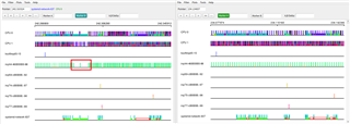

We have designed a custom board based on the J7200XSOMXEVM reference design.
We are developing the software for the custom board with PROCESSOR-SDK-LINUX-RT-J7200 (10.00.07.03).
The custom board uses three Ethernet ports: CPSW2g (MCU-RMII1) and CPSWng (RGMII2, RGMII3).
CPSW2g is used for EtherCAT communication, and CPSWng performs general-purpose IP communication.
During CPSW2g communication, if you disconnect and connect the cable in CPSWng, a frame loss may occur in EtherCAT communication.
When we used ftrace to obtain trace data when frame loss occurred and when it did not, we found the following differences.
*image(left:frame loss occurred, right:frame loss not occurred)
Frame loss does not occur all the time, but occurs once every few times.
I plugged and unplugged the cable five times and attached the trace data when a frame lost occurred on the fifth attempt.
Could this be because CPSW2g and CPSWng use the same driver (am65-cpsw-nuss.c)?
Is there a way to solve this?
It should not be because of same Driver used for CPSW2G and CPSWnG.
Can you check CPSW statistics any errors during cable unplug and plug.

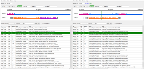

Further investigation revealed that CPSW2g is an EtherCAT main device, and the issue seems to be caused by the frame transmission process not running. However, the reason why the process stops running when the CPSWng cable is unplugged and plugged back in remains unclear.
The results of tracing the preemptirq event are shown below.
*image(left:frame loss not occurred, right:frame loss occurred)
Do these results tell us anything? And if so, how should we proceed with further investigation?
mizutani
Have you observed any Link down for CPSW2G? If so, it can stop the transmission.
Other wise no meaning of stop CPSW2G transmission process.
Can you please share the Linux log with us while above observation.
