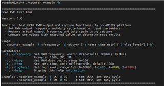

    The test code is as follows:
     * counter_example.c - ECAP PWM Test Tool
     * Function: Test ECAP PWM output and capture functionality on AM62XX platform
     *   - Configure PWM output frequency and duty cycle
     *   - Measure actual output parameters using ECAP capture
     *   - Compare set values with measured values to determine test results
     * Version: 1.0
     * Author: liweiyu@zlg.cn
     * Date: 2025/03/15
    #include <errno.h>
    #include <fcntl.h>
    #include <linux/counter.h>
    #include <stdio.h>
    #include <string.h>
    #include <sys/ioctl.h>
    #include <unistd.h>
    #include <stdlib.h>
    #include <math.h>
    #include <getopt.h>
    #include <sys/stat.h>
     * Constant definitions
    #define NUM_CAPTURES            4
    #define DEFAULT_TEST_TIME_MS    1000
    #define PWM_STABILIZE_TIME_US   100000
    #define DEFAULT_FREQUENCY_HZ    125000000
    #define ERROR_THRESHOLD_PERCENT 5.0
    #define MAX_PATH_LENGTH         256
    #define BUFFER_SIZE_SMALL       20
    #define BUFFER_SIZE_MEDIUM      64
    #define BUFFER_SIZE_LARGE       256
    /* Color code constants */
    #define COLOR_RED     "\033[0;31m"
    #define COLOR_GREEN   "\033[0;32m"
    #define COLOR_YELLOW  "\033[1;33m"
    #define COLOR_BLUE    "\033[0;34m"
    #define COLOR_RESET   "\033[0m"

     * Configure PWM output
     * @param freqHz: Frequency (Hz)
     * @param dutyPercent: Duty cycle (%)
     * @return: Returns 0 on success, negative value on failure
    int configurePwm(double freqHz, double dutyPercent)
        FILE *fp;
        unsigned long long periodNs, dutyNs;
        char freqDisplay[BUFFER_SIZE_SMALL];
        /* Prepare log display */
        formatFrequencyString(freqHz, freqDisplay, sizeof(freqDisplay));
        LOG_INFO("Configuring PWM output: Frequency=%s, Duty Cycle=%.2f%%", freqDisplay, dutyPercent);
        /* Check if PWM device exists */
        struct stat st;
        if (stat(PWM_DEVICE_PATH, &st) != 0) {
            LOG_ERROR("PWM device does not exist: %s", strerror(errno));
            return -1;
        /* Export PWM0 channel if it doesn't exist */
        if (stat(PWM_CHANNEL_PATH, &st) != 0) {
            fp = fopen(PWM_DEVICE_PATH "/export", "w");
            if (fp == NULL) {
                LOG_ERROR("Cannot export PWM0: %s", strerror(errno));
                return -1;
            fprintf(fp, "0");
            fclose(fp);
            /* Wait for device node creation */
            usleep(100000);
        /* Disable PWM */
        fp = fopen(PWM_CHANNEL_PATH "/enable", "w");
        if (fp == NULL) {
            LOG_ERROR("Cannot disable PWM: %s", strerror(errno));
            return -1;
        fprintf(fp, "0");
        fclose(fp);
        /* Calculate period and duty cycle in nanoseconds */
        periodNs = (unsigned long long)(1000000000.0 / freqHz);
        dutyNs = (unsigned long long)(periodNs * dutyPercent / 100.0);
        /* Set period */
        fp = fopen(PWM_CHANNEL_PATH "/period", "w");
        if (fp == NULL) {
            LOG_ERROR("Cannot set PWM period: %s", strerror(errno));
            return -1;
        fprintf(fp, "%llu", periodNs);
        fclose(fp);
        /* Set duty cycle */
        fp = fopen(PWM_CHANNEL_PATH "/duty_cycle", "w");
        if (fp == NULL) {
            LOG_ERROR("Cannot set PWM duty cycle: %s", strerror(errno));
            return -1;
        fprintf(fp, "%llu", dutyNs);

     * Print usage instructions
     * @param progName: Program name
    void printUsage(const char *progName)
        printf("\n=========================================================================================\n");
        printf("ECAP PWM Test Tool\n\n");
        printf("Version: 1.0\n");
        printf("\n");
        printf("Function: Test ECAP PWM output and capture functionality on AM62XX platform\n");
        printf("  - Set PWM output frequency and duty cycle based on input parameters\n");
        printf("  - Measure actual output frequency and duty cycle using capture\n");
        printf("  - Compare set values with measured values to determine test results\n");
        printf("\n");
        printf("Usage:\n");
        printf("  %s -f <frequency> -d <duty%%> [-t <test_time(ms)>] [-l <log_level>] [-h]\n\n", progName);
        printf("Parameters:\n");
        printf("  -f, --frequency  Set PWM frequency, units: Hz(default), K(KHz), M(MHz)\n");
        printf("                   Example: 1000, 1K, 1M\n");
        printf("  -d, --duty       Set PWM duty cycle, range 0-100\n");
        printf("  -t, --time       Set test time, unit milliseconds, default 1000\n");
        printf("  -l, --loglevel   Set log level, range 0-3 (0=DEBUG, 1=INFO, 2=WARN, 3=ERROR)\n");
        printf("  -h, --help       Display this help information\n");
        printf("\n");
        printf("Example: %s -f 1K -d 30     # Set 1KHz, 30%% duty cycle\n", progName);
        printf("         %s -f 1M -d 50     # Set 1MHz, 50%% duty cycle\n", progName);
        printf("=========================================================================================\n\n");

    The executable file generated after cross compilation is as follows:
    8400.counter_example.rar
    The usage method of counter_example is as follows:
    When the frequency of the input PWM is 10Khz and the duty cycle is 30%, the frequency and duty cycle captured by ECAP are correct:
    When the frequency of the input PWM is 100Khz and the duty cycle is 30%, the frequency and duty cycle captured by ECAP are incorrect:
    Carify the observed "inaccuracy" and provide context for our use case:
    1. Clarification on "Inaccuracy"
    The observed inaccuracy refers to Linux’s inability to read ECAP timestamps fast enough before they are overwritten, especially at higher frequencies. This aligns with the discussion in the previous thread.
    Key Evidence from Tests:
    10 KHz Test (Pass):
    • Set Frequency = 10 KHz → Measured Frequency = 10 KHz (0% error).
    • ECAP captures 4 timestamps (Capture 0 to Capture 3) with stable values.
    • Linux successfully read all timestamps without overflow.
    100 KHz Test (Fail):
    • Set Frequency = 100 KHz → Measured Frequency = 33.32 KHz (66.68% error).
    • Timestamp anomalies:
    • Capture 2 (12706097) > Capture 3 (12703970), indicating data overwrite due to delayed reads.
    • Root Cause:
    • At 100 KHz, ECAP updates timestamps every 10 µs, but Linux’s interrupt latency causes missed reads, leading to incorrect period/duty cycle calculations.
    2. Use Case Details
    Measurement Target:
    • We are measuring high-frequency PWM signals in the following scenarios:
      • Motor Control: Monitoring stability of PWM outputs from brushless motor drivers.  ◦
      • Power Management: Validating dynamic voltage regulation in DC-DC converters.
    Worst-Case Pulse Requirements:
    • Fastest Pulses: 1 MHz PWM with ≤10 ns edge accuracy.
    • Critical Parameters: Capturing transient frequency/duty cycle changes during load fluctuations.
    AM62x Role:
    • Real-Time Monitoring: ECAP captures PWM parameters for closed-loop control (e.g., adjusting motor speed).
    • Safety Protection: Trigger system shutdown if frequency/duty cycle exceeds safe thresholds (e.g., ±5%).
    You can use my cross compiled counter_example file to test on the TI evaluation board, and it should also be able to reproduce this issue.
    The test command is as follows:
    ./counter_example -f 1 -d 30
    ./counter_example -f 10 -d 30
    ./counter_example -f 100 -d 30
    ./counter_example -f 1K -d 30
    ./counter_example -f 10K -d 30
    ./counter_example -f 100K -d 30
    ./counter_example -f 1M -d 50
