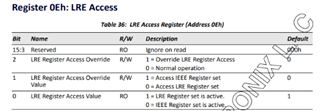

root@j784s4-evm:/opt/edgeai-gst-apps# phytool read eth1/0x00/0x00
0x4200
I believe below is the one register to confirm whether it is IEEE mode or in LRE mode. Is that correct?
root@j784s4-evm:/opt/edgeai-gst-apps# phytool read eth1/0x00/0x0E
0x0001
root@j784s4-evm:/opt/edgeai-gst-apps# phytool read eth1/0x00/0x18
0x71e7

Third case: The code I used for IEE mode, just modified the below one change alone.
Link detected, ping test was working. But to confirm whether it was in LRE mode or not, we read the below register. The LRE register set was not configured. It was in IEEE mode only.
0x0000
I am not sure how we can confirm the LRE mode and how we can achieve communication establishment in LRE mode.
Could you please give thoughts and inputs on this?
    Please check with Broadcom about the PHY configuration and cable connectivity.
    Have you contacted Broadcom about the PHY configuration and connectivity?
    I suspect it may not be same as standard Ethernet cable connectivity, as LRE meant for Longer distance communication.
    Also, MAC side same configuration irrespective of PHY Mode (IEEE/ LRE)
