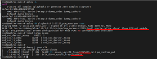

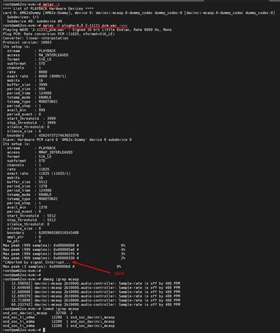

    The situation described above is that it gets stuck after playing, and I need to press Ctrl-C to force stop, but there is no FrameSync/BCLK output during this period.
    The other situation is the more common result: after playing for a short period of time (about 1 second), the error message is directly printed. My judgment is that there is no CLK, so there is no DMA/interrupt so the data cannot be sent, or there is no DMA/interrupt so there is no CLK.
    I don’t know the causal relationship between the two, but the lack of CLK output can be directly observed.
    The following is a screenshot of this result:
    I also wrote a script to monitor the changes of clk and pm while playing. The reference command is as follows:
    grep -i mcasp /sys/kernel/debug/clk/clk_summary
    cat /sys/kernel/debug/pm_genpd/pm_genpd_summary | grep -i audio
    The above is a screenshot of the monitoring result (in this case, I changed PCM to 32 timeslot X 16 bits =4.096MHz)

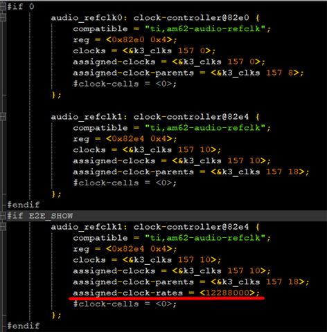

    Below is my modification

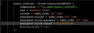

    I adjusted the pin output direction and added AUDIO_EXT_REFCLK1

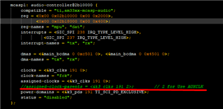

    I found that k3-am62-amin.dtsi already has settings for audio_refclk1, I keep this block and add the setting assigned-clock-rates = <12288000>;
    In this file, I also adjusted the settings of mcasp1
    My audio card definition is as follows:
    mcasp1 as follows:

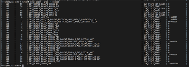

    After recompiling and loading the system to play, the following error is obtained:
    There is a very strange number 12345679 here!
    I guess the invalid setting of AUDIO_EXT_REFCLK1 12.288MHz will cause the aplay error. Please help me find out where the problem is?
    Brian

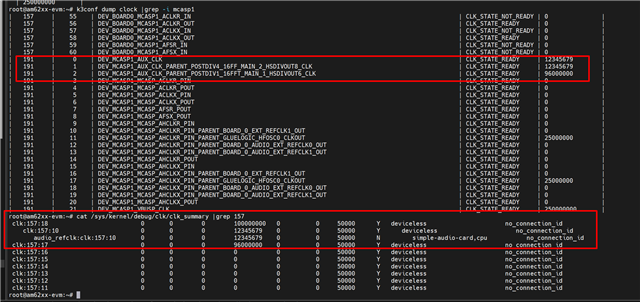

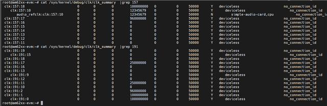

    Here is a screenshot of the execution result:
    clk_summary:

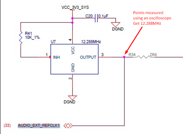

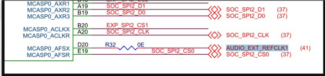

    About AUDIO_EXT_REFCLK1 use D20 pin as follow:
    We double check this pin is OK.
    Please let me know if you need any more information from me.
    Brian

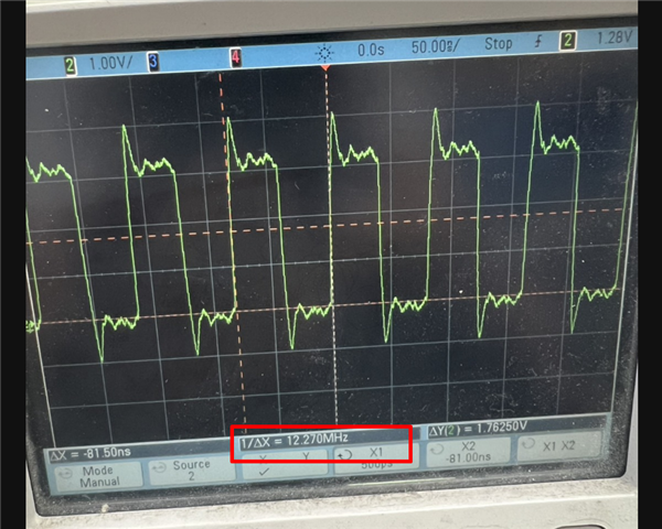

    Whether using D20 or K35, I removed the string as you suggested and the test results are still the same, as shown below:
    The following is the waveform displayed for pin D20, with a frequency close to 12.288MHz.
    evm-tdm-master.zip
    Attached is the test file (using the D20).
    Brian
