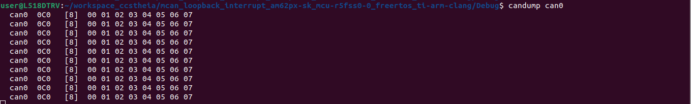

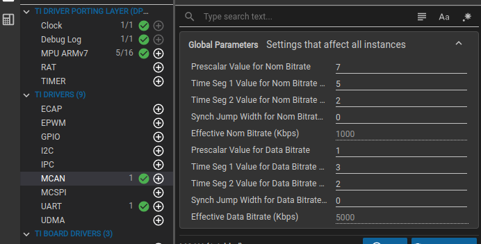

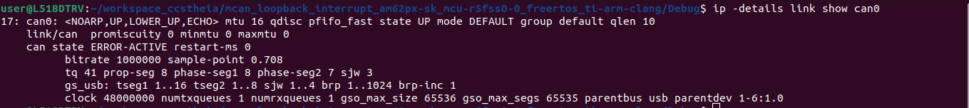

I attempted to send CAN frames from the host using cansend. The interface is set to 5 Mbps, but communication is not working.
Please advise on what could be going wrong or suggest any debugging steps.

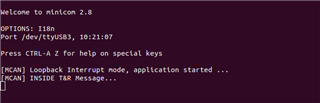

  • Hello Meet,
    Could you elaborate the issue further?
    Sure. So I am trying to flash mcan_loopback_interrupt_am62px-sk_mcu-r5fss0-0_freertos_ti-arm-clang example application in external mode in ospi boot mode. And I have changed the software requirements which is -> App_mcanConfig(FALSE); as per the FAQ. This is the log which I am getting ->
    Could you try to debug the application using CCS and tell me where exactly the code flow is stuck, please share the UART logs from the applications as well if they indicate any issues
    I have not tried debugging the applica
    tion yet. Will try it and get back to you.
    The loopback example also has a Tx part, do you at least see the data being received properly via your USB2CAN, as the shared FAQ mentions, after successful reception of data, the data has to be transmitted ten times from the CAN analyzer/tool for test to end.
    No, the data is not received using USB2CAN module as well. But I can assure you that the USB2CAN is in perfect working condition, since I used it for different experiment.

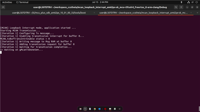

  • Could you try to debug the application using CCS and tell me where exactly the code flow is stuck, please share the UART logs from the applications as well if they indicate any issues
    Hello Meet,
    I have tried debugging the code using DebugP_log() and i found out that the code is stuck at SemaphoreP_pend(&gMcanTxDoneSem, SystemP_WAIT_FOREVER);
    I will provide the whole code, so that you can understand the debugging pattern i used and will also provide the log after flashing the application.

            DebugP_log("[Iteration %u] Waiting for transmission completion...\r\n", i + 1);
            DebugP_log(">> Waiting on gMcanTxDoneSem...\r\n");
            DebugP_log("<< Unblocked from gMcanTxDoneSem\r\n");

        /* CAN FD Mode and Bit Rate Switch Enabled */
        initParams.fdMode          = TRUE;
        initParams.brsEnable       = TRUE;
        /* Initialize MCAN module Global Filter Params */
        MCAN_initGlobalFilterConfigParams(&configParams);
        /* Initialize MCAN module Bit Time Params */
        /* Configuring default 1Mbps and 5Mbps as nominal and data bit-rate resp */
        MCAN_initSetBitTimeParams(&bitTimes);

    Please make sure that the bitrate and the sampling point is properly set in your innomaker software.
    Meet.
  • Hi Meet,
    Initially, I set the bitrate to 5 Mbps based on the information provided in the FAQ. The command I used on my Linux machine to bring up the Innomaker CAN module was:
    sudo ip link set can0 up type can bitrate 5000000.
    However, since it's not working, I plan to verify whether the bitrate and sampling point I’ve configured are correct.
    According to the FAQ -> the bitrate and sampling point are calculated using the following formulas:

    I have a couple of doubts:
    1. How can I find the value of the CAN clock (in Hz)?
    2. In the example.sys file, I found the values for BRP, TSEG1, and TSEG2. I’ve also attached a screenshot for reference. Based on that, should I interpret the values as:
      • BRP = 8
      • TSEG1 = 6
      • TSEG2 = 3
        (Considering the "+1" interpretation by the hardware)?
    Please let me know if my understanding is correct.
    Abhishek
  • HI  Abhishek,
    By default, the frequency of CAN module set is 80MHz, you can refer to this clock tree tool and check how the frequency for MCAN module is derived: SysConfig
    Your interpretation is correct.

  • Hi Meet,
    The transmission is still not completing — the program appears to be stuck at the same line as before.
    Based on my current configuration, the calculated bit-rate is 1 Mbps, and the sampling point is 0.7.
    As a reference, I have attached a screenshot showing that the Innomaker USB2CAN module is also brought up with the same configuration.
    Could you please take a look and advise if there’s anything else I might be missing?

  • Hi Abhishek,
    The example uses the CAN-FD module, It seems that your USB2CAN module doen't support CAN-FD could you please confirm the same?

  • Hello Meet,
    I wanted to let you know that I resolved the issue last Friday. The problem was with the USB2CAN module — it doesn’t support CAN-FD and only transmits data at a rate of 1 Mbps. After adjusting the code accordingly, everything worked perfectly.
    I’ve attached some screenshots for your reference.
    It’s great to see that you were also able to crack it in the end!
    Thanks!
    Abhishek
