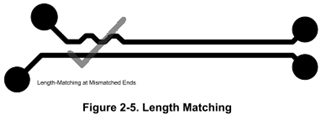

    How to handle skew compensation for DPHY/CSI, PCIe/DDR4?
    (+) TDA4VM: High speed interface layout (spraar7) : How to handle skew compensation for DPHY/CSI, PCIe/DDR4? - Processors forum - Processors - TI E2E support forums
    That is my design - "the other pair's" bulge is comming outside of the picture (due to the via's space constraint)
    2.) Could I finally repeat if I got you right:
    a.) All high speed signals (e.g. PCIe, CSI/DPHY) have no "internal" (within chip package) skew and hence start at the balls with zero skew.
    b.) If I want to address TI's recommendations I've to add the length on the pcb as of spraar7i:
    2a)  Correct - assume package has zero skew
    2b) Correct - minimize impedance discontinuity by adjusting skew mismatches at single/few locations.
