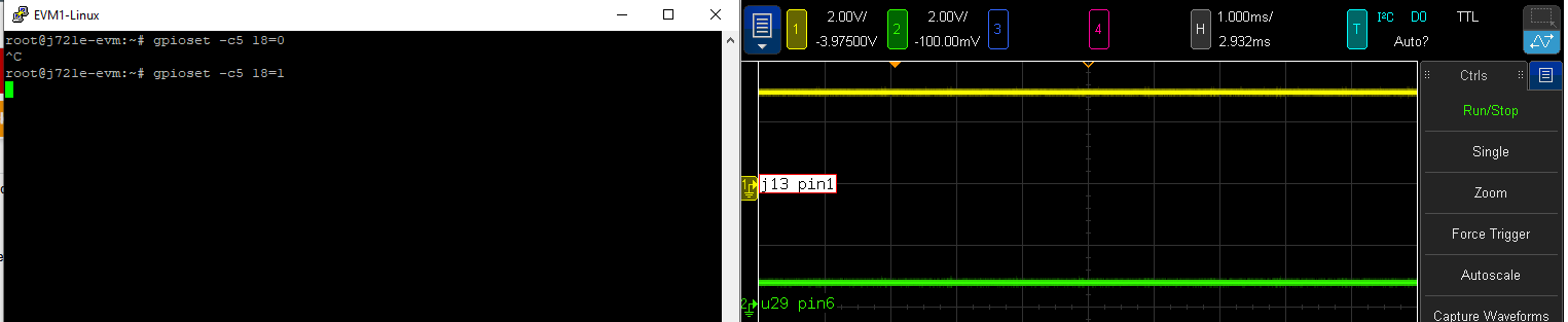

gpioset -c 5 53=1  // Nothing changes on the scope we have connected to GESI Board J5 pin 6

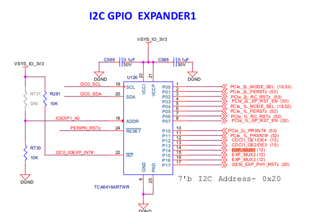

&exp1 {
   // Enables MCAN4-7 if low rather then PWM signals
	p14-hog {
		/* P15 - EXP_MUX1 */
		gpio-hog;
		gpios = <12 GPIO_ACTIVE_HIGH>;
		output-low;
		line-name = "EXP_MUX1";

I still cannot see any of the GPIOS toggle or change values.

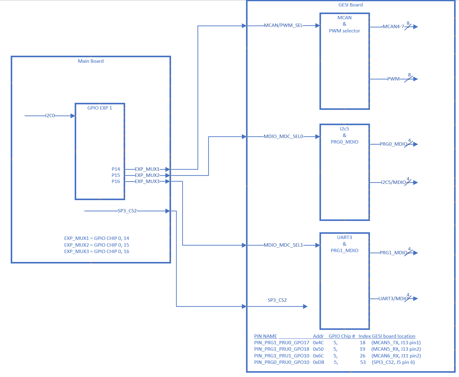

Any help would be appreciated.  Below is a diagram showing our understanding of the EVM and the GPIOS we are trying to use.

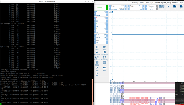

  • Sure, Here they are.
    Read at address  0x0011C0D8 (0xffff955af0d8): 0x08214007
    Read at address  0x00600060 (0xffffb6a4f060): 0xFFFFFFFF
    Read at address  0x00600064 (0xffff98bf5064): 0x00000000
    Read at address  0x00600068 (0xffff7fbc9068): 0x00000000
    Something doesn't look right to me.

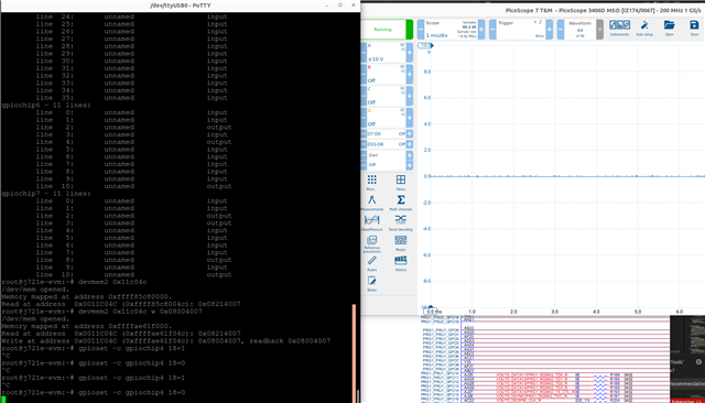

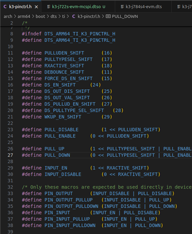

  • As a note. If I change just the Padconfig register using devmem2 w 0x08004007. then I can toggle the GPIO.  I don't know how to get the registers to this value just using devicetree.
    Also, please excuse my ignorance on this, but wouldn't GPIO0_53 be in bank 3? It seems like ther are 15 bits per bank so bit 15 would be in bank register 23 not 45?
  • Hi Randy,
    That is a good find. Clearing bit 21, which is the Padconfig register's TX_DIS bit, is probably what is allowing the GPIO to toggle.
    We do not provide a macro for enabling/disabling this bit, but what the fix would look like would be a new macro in arch/arm64/boot/dts/ti/k3-pinctrl.h that defines a new TX_DIS_SHIFT, a OUTPUT_DISABLE macro, and or'ed with the PIN_OUTPUT and/or PIN_INPUT macros.
    By default, it looks like the TX_DIS bit is a 0 for J721S2 and J784S4, while it is a 1 by default for J721E, J7200, J722S SoCs. I will check internally to see how this bit has been handled in the past, but might be a bug in the SDK.
    Takuma

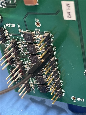

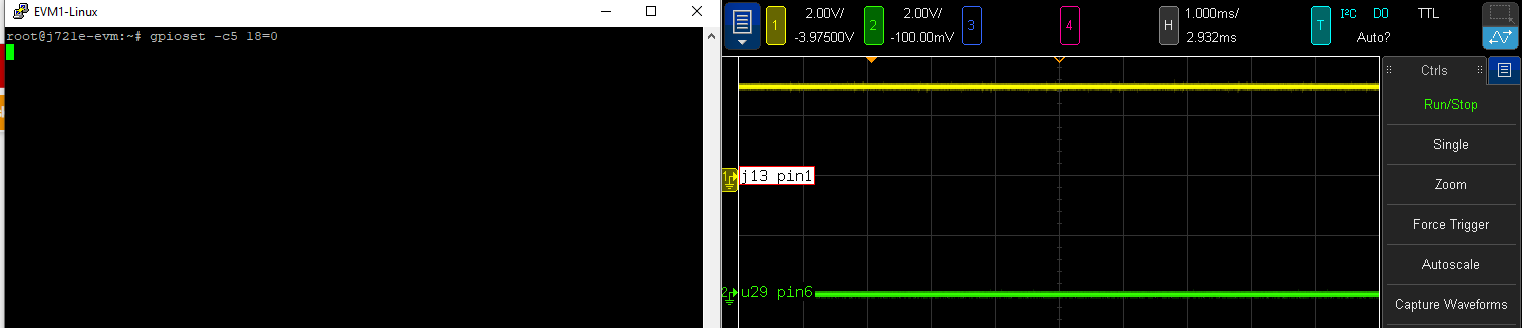

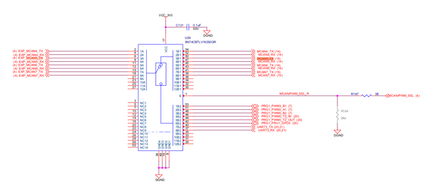

  • Another note: I still cannot toggle GPIO0_18 (MCAN5_TX/GPIO0_18) with the same settings. The input to the mux that the MCAN5_TX/RX goes through is pulled low which should select the MCAN as the output.
    Regardless, I have checked on the input side of the mux as well and that pin in not toggling even with the same settings I used for GPIO0_53.
    Maybe there is another mux point for that signal?
    Yes, for MCAN5_TX there is a mux on the GESI board.
    This is controlled by EXP_MUX1
    Takuma
  • Takuma,
    I believe I have everything set to allow the MCAN5_TX line through, GPIO hog for MUX1 set to low to select MCAN signals. I even measured MCAN5_TX on the INPUT side of the mux and could not see it toggling. I will try some more things to see if this is just another register setting problem.
    &exp1 {
    	p14-hog {
    		gpio-hog;
    		output-low;

  • Hi Randy,
    Ok, understood. Does the padconfig register (0x0011C038) content also look good?
    Takuma
  • It looks like the following:
    Though I need to double check the address to see if that is the correct one for GPIO_18
    devmem2 0x0011c038
    /dev/mem opened.
    Memory mapped at address 0xffffabd5c000.
    Read at address 0x0011C038 (0xffffabd5c038): 0x00010004
    However, GPIO8_18/MCAN5_TX pad config register is at address 0x00011C04C
    And it value is:
    /dev/mem opened.
    Memory mapped at address 0xffff8f383000.
    Read at address 0x0011C04C (0xffff8f38304c): 0x08214007
    I can then change it using devmem2 0x0011C04C w 0x08004007
    However I still can't toggle the GPIO0_18 with these settings.
    I can see that there is a GPIO HOG for MUX1 but I don't know how to read it value. I can measure it on the board and it is 0V (or low) which seems to be the correct value to select the MCAN signals on the MUX chip.
  • Hi Randy,
    My apologies. I looked at J721S2 instead of J721E datasheet for the PADCONFIG address. 0x00011C04C is the correct address.
    Could you try setting bit 18?  So a value of 0x40007. The other bits that are set by default, bit 14 and 27, should not affect the GPIO toggle experiment, so you can keep them set or overwrite them.
    Takuma
  • Takuma,
    I did try writting that value to the pad control register. It didn't seem to make a difference. I can see that the ouput register is changing. I might need to just trace the signal(s) back to the main board and see if there is a connection issue. I don't think there is but I am out of ideas.
    Output register after setting GPIO0_18
    Memory mapped at address 0xffff9bfb5000.
    Read at address 0x00600014 (0xffff9bfb5014): 0x00040000
    Pad Control register
    devmem2 0x00011c04c w 0x00040007
    /dev/mem opened.
    Memory mapped at address 0xffffadd32000.
    Read at address 0x0011C04C (0xffffadd3204c): 0x08004007
    Write at address 0x0011C04C (0xffffadd3204c): 0x00040007, readback 0x00040007
  • Hi Randy,
    I am seeing that GPIO0_18 also has same behavior as GPIO0_53 (aka, after setting padconfig register from 0x8214007 to 0x8004007, writes take effect). SDK 11.0 default image is used. Attaching some scope readings with example logs.
    gpioset -c gpiochip4 18=0
    gpioset -c gpiochip4 18=1
    And I have the probe connected to J13 connector, pin 1.
    Takuma
  • Maybe you can show me where in the SDK is the default image to load.  I could not find a *.wic image to burn onto an SD card either in the pre-build images or on the website.  Therefore I build my own using yocto and following the SDK instructions.
    However, You are using GPIO chip 4 and mine shows up as GPIO Chip 5.
    Doing the same thing you did above and documenting the Oscilloscope output and Linux commands I get differenent results. matter of fact. I can't even see the input to the mux (U29) changing.
    (The forum software won't let me add my images of where I am probing the board?)
    However, If I do the same thing with MCAN5_RX (GPIO_19) I can get it to toggle. So there must be a problem with the pin/pad or path that has gotten damaged with GPIO0_18.
    Thanks for your help. Lets call this one solved, due to individual HW problem with my specific board.
