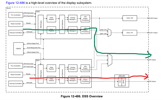

  • Hi Divyansh:
    We discuss with customer below is the pipeline about their display request:
    Memory -> DSS0 -> Overlay 2 ->VP1 -> DPI -> BT.656 interleave output
    Memory-> DSS1 -> Overlay 2  -> VP1 -> DSI
    We think maybe the DPI-BT.656 patch affect all DSS0/DSS1 pipeline. But customer user case is 2 different display resolution and display mode.
    Maybe those DPI patch use affect DSS0 and DSS1 keep the default configure method can resolve customer problem.
    Could you please suggest just enable DPI-BT.656 interleave method at DSS0 modify method? We can try it.

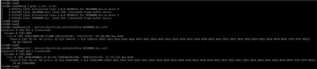

    As I understand, your issue is currently not with the interlaced BT656 patch, but the initial progressive BT656 patch. Is this understanding correct?
    Can you share the output of following:
    dmesg | grep -e dsi -e dss
    kmsprint --device=/dev/dri/by-path/platform-30200000.dss-card
    kmsprint --device=/dev/dri/by-path/platform-30220000.dss-card
    Please also share dts files and DSI overlays you have applied.
    I have verified the BT.656 progressive patch at my end and I am able to use DSI with the patch applied on kernel.
    Please try using DSI separately without patch, I would expect that may not also work, which would indicate DSI interfacing issues on your setup.

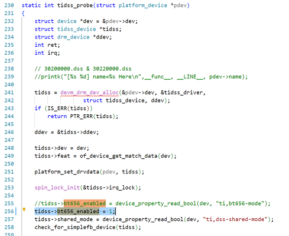

  • hi
      set "tidss->bt656_enabled = 1;" DSI with no signal.
     set "tidss->bt656_enabled = 0;" DSI have signal.
  • Hi:
       The DSI interface display was originally fine, but now with the addition of DPI-BT656 patch, there is no signal at the DSI interface.
       then i set "tidss->bt656_enabled = 0;" DSI have signal.
    Your modification to the patch is incorrect and hence this is expected.
    You are making the change "tidss->bt656_enabled = 1;" in DSS driver.
    DSS0 and DSS1 probe go through the same tidss_probe function call, and you are essentially hardcoding bt.656 enabled for both DSS0 and DSS1 due to which DSI does not work.
    As shared in the original patch, correct way to do this is not by hardcoding, rather go to your DTS files:
    1) Within &dss0, add the following flag:
    ti,bt656-mode;
    2) This flag should not be there in dss1 nodes.
    3) Remove your hardcoded bt mode enabler from dss driver.
    The following line in tidss_drv.c will take care of reading the flag from dts:
    tidss->bt656_enabled = device_property_read_bool(dev, "ti,bt656-mode");
  • Hi Divyansh:
    Based on your suggest just enable DSS0 pipeline BT656 interleave mode, this problem resolved.
    Now DSI/DPI can output different resolution video. I will close this ticket.

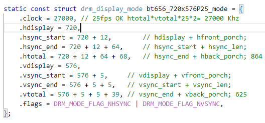

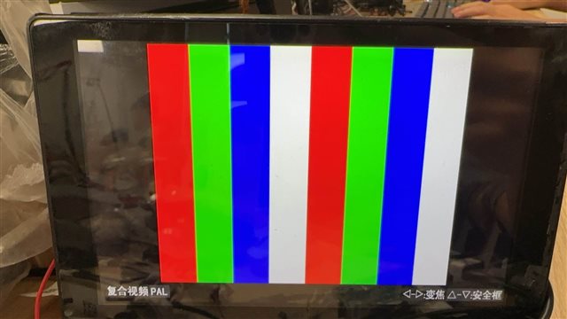

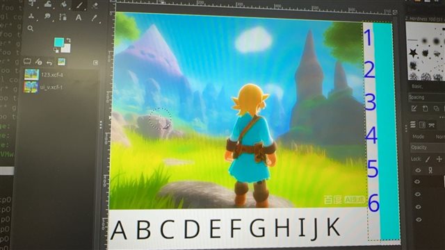

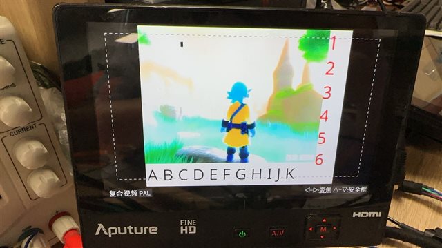

  • my board: AM62P DPI => BT6576  => TP2803 => CVBS panel
    I am using the DPI interface on the AM62P board to output BT656 (to CVBS) images,
     the displayed picture is showed above.
    Do you have the final patch package for BT656 with DPI output.

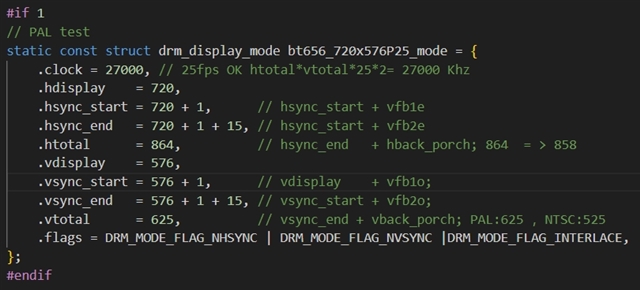

    +#if 1
    +// PAL test
    +static const struct drm_display_mode bt656_720x576P25_mode = {
    +	.clock = 27000,	// 25fps OK htotal*vtotal*25*2= 27000 Khz
    +	.hdisplay    = 720,
    +	.hsync_start = 720 + 2,      // hsync_start + vfb1e
    +	.hsync_end   = 720 + 2 + 22, // hsync_start + vfb2e
    +	.htotal      = 864, 	     // hsync_end   + hback_porch; 864  = > 858
    +	.vdisplay    = 576,
    +	.vsync_start = 576 + 2,      // vdisplay    + vfb1o;
    +	.vsync_end   = 576 + 2 + 23, // vsync_start + vfb2o;
    +	.vtotal      = 625,          // vsync_end + vback_porch; PAL:625 ,NTSC:525
    +	.flags = DRM_MODE_FLAG_NHSYNC | DRM_MODE_FLAG_NVSYNC |DRM_MODE_FLAG_INTERLACE,

    +	tidss->bt656_enabled = device_property_read_bool(dev, "ti,bt656-mode");
     	tidss->shared_mode = device_property_read_bool(dev, "ti,dss-shared-mode");
     	check_for_simplefb_device(tidss);

    +#if USE_SYSFS_DEBUG
    +	ret = sysfs_create_group(&pdev->dev.kobj,&tidss_attribute_group);
    +	if (ret) {
    +		printk(KERN_ERR"sysfs_create_group failed\n");
    +#endif
    +	MSG(" 0 tidss_probe DRM 设备:%s end",pdev->name); //debug++
     	return 0;

    per discussion, we may need your input for below two items to check the issue and code.
    1. what is the parameter of the display, such as, Hight, width, HBP, VBP.... like below.
    2. per discussed, there is one issue even if pattern is displayed, Line and field is out of sync. Please help clarify this point in detail.
    thanks a lot!
    yong

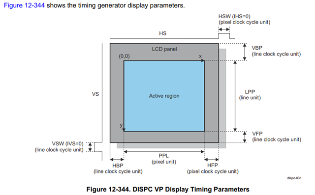

  • // calc from AM62Px Technical Reference Manual.pdf  Page 1919
        dispc_vp_enable(...) {
        vfb1e = mode->hsync_start - mode->hdisplay;    // Vertical field blanking No.1 for Even Field
        vfb2e = mode->hsync_end   - mode->hsync_start; // Vertical field blanking No.2 for Even Field
    	vfb1o = mode->vsync_start - mode->vdisplay;    // Vertical field blanking No.1 for Odd Field
    	vfb2o = mode->vsync_end   - mode->vsync_start; // Vertical field blanking No.2 for Odd Field
    	hb = ((mode->htotal - mode->hdisplay) - 4)*2 - 1;  // (764 -720 -4)*2-1 = 79 = 0x4F
    	dispc_vp_write(dispc, hw_videoport, DISPC_VP_TIMING_H,
    				FLD_VAL(hb & 0x00FF, 7, 0) |
    					FLD_VAL(vfb1e, 19, 8) |
    				FLD_VAL(vfb2e, 31, 20));
    	dispc_vp_write(dispc, hw_videoport, DISPC_VP_TIMING_V,
    				FLD_VAL((hb >> 8), 3, 0) |
    				FLD_VAL(vfb1o, 19, 8) |
    				FLD_VAL(vfb2o, 31, 20));
  • I can show a photo now.
  • Hi, Donghui,
    Do you mean that interlaced BT656 over DPI can work correctly? Thanks.
    Br, Tommy
  • 1)bash  display -depth 8 -size 720x576 image.rgba     //  the number is blue
    2)  The number turns red  when I use  /dev/dri/cardx,  I will check my test code.
  • sync the status.
    1. BT656 interlace mode over DPI: customer has verified 720x576P25 to display one static picture.
    2. next step is to bring up 2x Display, DSI and BT656 interlace mode over DPI, after china nation day holiday.
    3. customer will also verify that within their AVM application.
      Please help update questions when there it is in next step.
    thanks a lot!

  • 1)768x576P25 BT656 interlace mode over DPI  is ok;
    2) 1920x1080P30 over DSI is ok.
