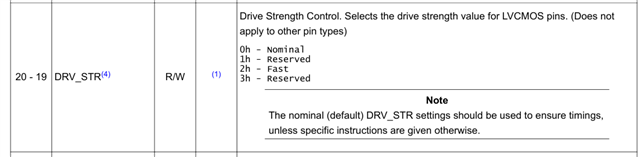

For one of our products we are using the DSS to output video. This causes some EMI interference in a specific bandwidth that we would like to lower. We are using BT.656 mode on a 10 bit data bus.
We wanted to try doing this by lowering the drive strength on the VOUT0_DATA0-9 and VOUT0_PCLK pins.
We have some questions regarding this:
  1. The drive strength parameter for the pinmux is set as 0 (default). The other values (1-3) are set as reserved. Is it possible/allowed to set these to 1-3, and what drive strength is then used?
  2. Is there another way to configure the DSS to output less energy on the output pins?
  3. Is it possible to use spread spectrum for clock and data lines? If so, how do I configure this? And is this compatible with bt.656 mode?
