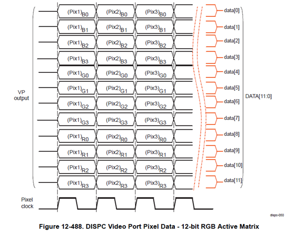

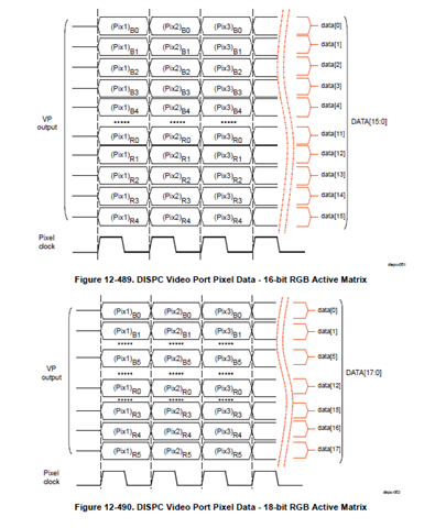

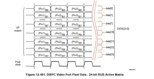

Hi TI Experts,
I have the below queries regarding the DPII interface
  1. We want to use an RGB Display with AM625 Processor. It seems MIPI-DPI Interface of the processor is similar to RGB Interface.
    Are there any Differences between the two interfaces or can we connect the RGB Display directly to the AM625?

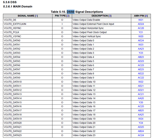

  2. Need guidance to map SoC parallel data to LCD RGB input
  3. Would the above queries be valid for other family of processors?
Let me know your thoughts.
