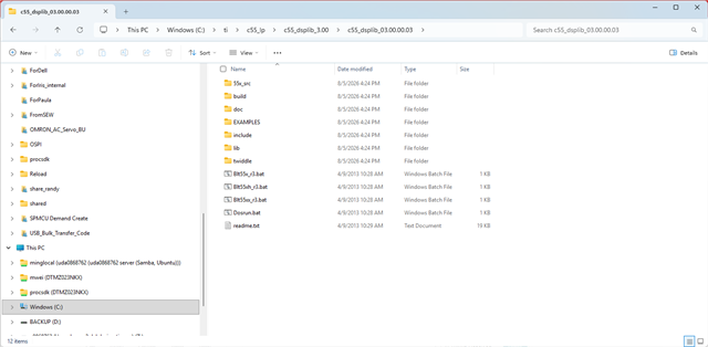

  • Hi Thierry,
    You are in the right place for download the C55x DSP libraries:  https://software-dl.ti.com/libs/c55_dsplib/latest/index_FDS.html.
    As KI mentioned in his post, all you need to do is download and install the SPRC100-C55_DSPLIB-03.00.00.03-Setup.exe. After install, there will be a zip file. Unzip the zip file, you will get the following directory:
    It just works like any other libraries (doc folder has the programmer guide, include folder has the header files, lib folder has the pre-built libraries, EXAMPLES folder has the DSPLIB examples). One thing different is that the 55x_src folder has all the DSPLIB functions' source code (in assembly though)

  • Thank you .
    In the properties of my project, under "C/C++ Build",
    - in "C5500 Compiler - Include Options", I have added "C:\c55_lp\c55_dsplib_3.00\include". (It seems on the previous -now crashed- computer the project also had a similar path to "${PROJECT_ROOT}/../../C55xxCSL/include").
    - in "C5500 Linker - File Search Path", I have added "C:\c55_lp\c55_dsplib_3.00\lib". Likewise.
    In some sense it solves the first issue, because "55xdspx.lib" is found. So I do not need to recompile it using the bat-file?
