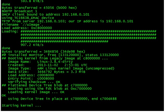

Hi,all:
My TCI6638EVM had 2G DDR3 memory.I designed to allocate memory like this:
DSP used the first 1G space address from 0x8000 0000 to 0xbffff ffff.
ARM used the second 1G space address from 0xc000 0000 to 0xdffff ffff
By default, TCI6638EVM ARM run kernel from physical address 0x8000 0000,also ARM occupiedAll 2G DDR space.So once DSP program load and run ,linux kernel could suspend or hung.
So I wanted to run linux kernel from a different physical address –0xc000 0000 and memsize was assigned to 1G .I followed the steps described in the ti wiki:
http://processors.wiki.ti.com/index.php/MCSDK_UG_Chapter_Exploring#How_to_run_Linux_kernel_from_a_different_physical_address_than_default_.280x80000000.29.C2.A0.3F
I modified these place including the kernel and uboot code below.
Kernel
  1. Makefile.boot
..\tci6638-linux-kernel\linux-keystone\arch\arm\mach-keystone\
zreladdr-y := 0xc0008000
  1. Memory.h
..\tci6638-linux-kernel\linux-keystone\arch\arm\mach-keystone\include\mach
#define KEYSTONE_LOW_PHYS_START             0xc0000000ULL
#define KEYSTONE_LOW_PHYS_SIZE                 0x40000000ULL /* 1G */
#define KEYSTONE_LOW_PHYS_END                 (KEYSTONE_LOW_PHYS_START + \
                                        KEYSTONE_LOW_PHYS_SIZE - 1)
  1. K2hk-evm.dts
..\tci6638-linux-kernel\linux-keystone\arch\arm\boot\dts
memory {
           reg = <0x00000000 0xC0000000 0x00000000 0x20000000>;
Uboot
  1. Tci6638_evm.h
\tci6638-uboot\u-boot-keystone\include\configs
#define CONFIG_SYS_SDRAM_BASE                 0xC0000000
#define CONFIG_MAX_RAM_BANK_SIZE        (1<< 30)   /* 1GB */
  1.
addr_fdt=0xc7000000
addr_kern=0xc8000000
After above modifies.I run uboot and kernel.But Kernel always stopped at “Start Kernel…..”
 why? where I didn't notice? Thx!
Please looked at attatched file.

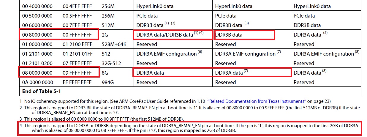

  • Hi, Garrett:
    Thank you,As you said,I tried to load dsp program from the start address 0xA000 0000 and the result was exciting.In other words, I could load dsp program successfully,But another questions remained.
    1.Why uboot just could recognize 1GB memory space other than 2GB ?
    I confirmed that EVM had 2GB DDR3 on board.why uboot just used the first 1GB?
    What about the second 1GB address from 0xC000 0000 to 0Xffff ffff?
    Whoever DSP or ARM couldn’t use the second 1GB memory space?DSP was not ,ARM was the same not?
    What was the second 1GB memory space used to?
    2.
    Other than you said,I tried load dsp program from the sart address 0xC000 0000.Unluckly,I failed and the error info “failed  load  error=-104” again.So I guessed that the second 1GB space from 0xC000 0000 to 0Xffff ffff wan not be used by DSP,Because the uboot recognized only 1GB memory space and the kernel ‘space was 1GB from 0x8000 0000 to 0xC000 0000.
    But I just wanted to know why? Where the second 1GB space from 0xC000 0000 to 0Xffff ffff?
    3
    Go back to the beginning question,If I wanted to allocate 2GB memory space like below,How could I do?
    DSP :   from 0x 8000 0000 to 0xC000 0000
    ARM   from 0xC000 0000 to 0Xffff ffff

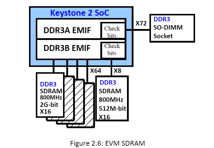

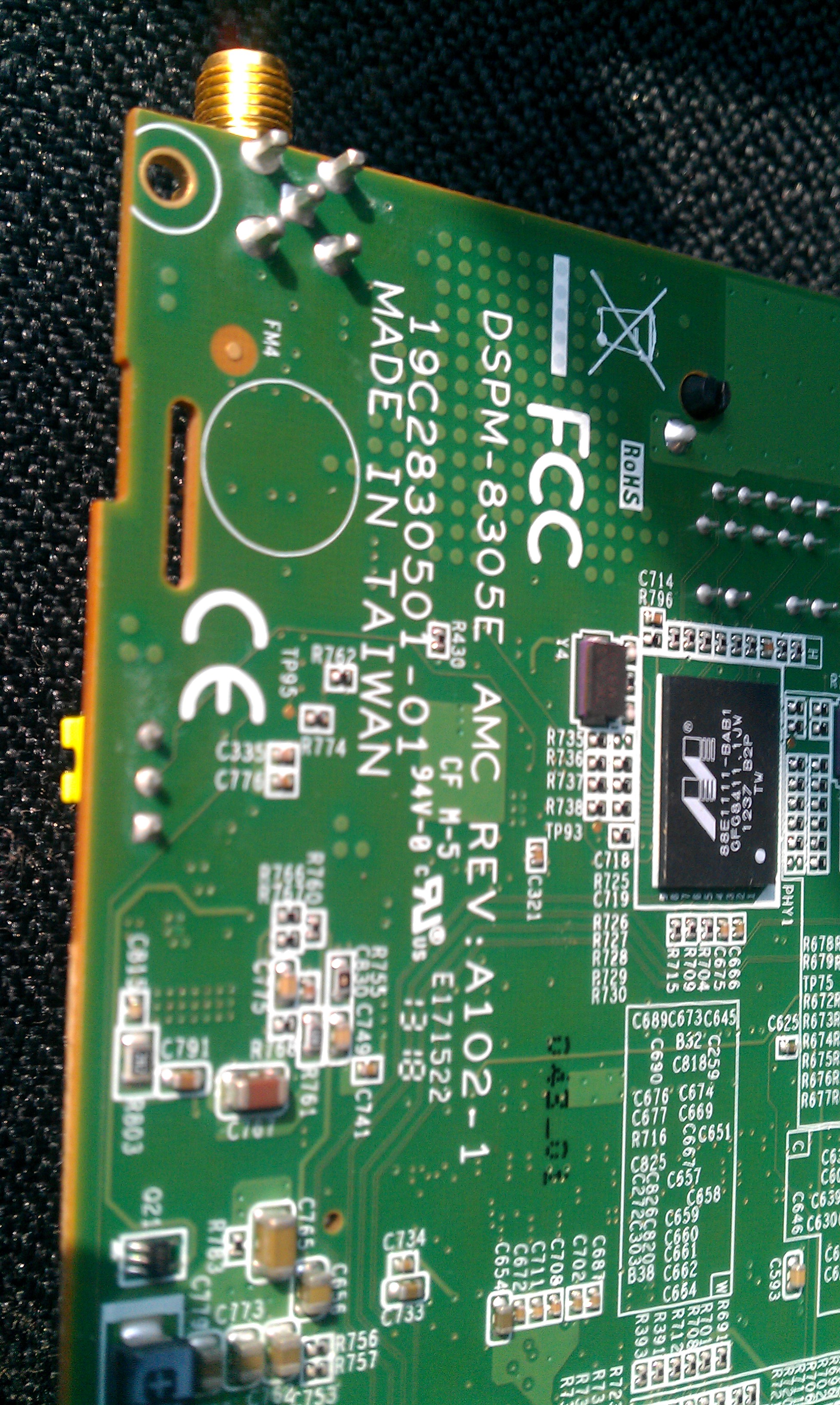

  • Hi, Steve,
    Are you using Rev 1.0 EVM? There is a DDR3 bus width issue which only allows half of the DDR3 memory be accessed. This issue was fixed in Rev 2.0 EVM. Becuase of that, a 2GB DDR3 DIMM only has 1GB space can be accessed.
    To have 2GB memory space, you will either need to have a Rev 2.0 EVM or a Rev 1.0 EVM but 4GB DIMM. Only half of the DIMM space can be used in Rev 1.0 EVM.
    Attached is a Application Notes for using MPM which we just wrote recently. You may already know it after spending so much time on MPM. The u-boot variable mem_reserve allocates the memory space for the DSP and it can be adjust according to the need.

    Another attached picture was the version of the K2EVM-HK .
    it's said made in TAIWAN and the other side of EVM worte "XTCIEVMK2X  REV11"
    From above infomation I guessed the EVM was REV1.0,but I was not sure.
    What's your opinion?
    Any help will be appreciated.
    Regards!
    Steve.
  • Hi, Steve,
    Did you set your mem_reserve to 768 or 768M?
    You have EVM Rev 1.1 which still uses the old silicon. Only Rev 2.0 has the newer silicon which fixed the 64-bit bus issue.

    As well know, K2HK EVM had  two DDR on board.on called DDR3A  which was DIMM.The other call DDR3B which was consist of 5 pieces K4B2G1646E.The size of DDR3A was 2GB ,but because of bus issue,Only 1GB memory space could be accessed.  The size of DDR3B was 256MB x 5=
    1GB + 256MB.
    As to my application,For DSP only  using DDR3A  was not enough.So I want to use the DDR3B.

    Rex:
    In the post Last week above,you said that ARM accesses DDR3A memory and DSP  mem_reserve on DDR3A and  DDR3B.But I felt it maybe not right when I looked into the tci6638k2k datasheet_SPRS836A.
    From pic1,we know that :
    This region is mapped to DDR3A or DDR3B depending on the state of DDR3A_REMAP_EN pin at boot time. If the pin is ‘1’, this region is mapped to the first 2GB of DDR3A
    which is aliased of 08 0000 0000 to 08 7FFF FFFF. If the pin is ‘0’, this region is mapped as 2GB of DDR3B.
    That means the region on ARM is mapped to DDR3A or DDR3B. it depends the DDR3A_REMAP_EN. Another also from the pic1,we see the region on DSP is definitely mapped to DDR3B.

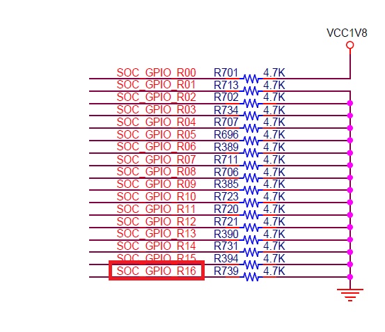

    About DDR3A_REMAP_EN, I looked into the K2H_K2EVM-HK_SCH_A102_Rev1_0.pdf from www.advantech.com .From pic2,I can see that DDR3A_REMAP_EN was pull down on boot up.So DDR3A_REMAP_EN = 0 on 6638 starting.So it means that the region 0x8000 0000 to 0xffff ffff is mapped to DDR3B.
    So,it is very different with what you said ARM accesses DDR3A memory .
    Another from pic3,We know that the size of DDR3A is 2GB DDR3 DIMM ,But only 1GB could be accessed by ARM as last week you said because of bus issue. And for DDR3B,There are five SAMSUNG_K4B2G1646E-BCK. Every chip is 256MB.Excluding the chip use for ECC.Only 4x256MB = 1GB can be accessed.
    So Rex, Do you think you view wright or wrong? On the earth ,DDR3A can be used for ARM or DSP?  Also DDR3B can be used for ARM or DSP? What’s your opinion?

  • Steve,
    You are right. Both DDR3A and DDR3B can be accessed from either ARM or DSP.

  • Hi, Steve,
     In the memory map table, there are ARM view and DSP view. From the DSP view column of the memory map table, the address of 0x8000 0000 to DSP is DDR3B only, but can be 3A or 3B on ARM (ARM view column) depending on REMAP_EN setting.
    Since on ARM, 3A can be 0x00 8000 0000 (2GB) and 0x08 0000 0000(8GB) (both are shown in memory map table),  the 2GB memory starting at 0x8000 0000 is mapped to the first 2GB of the 8GB at the physical address of 0x8 0000 0000. The difference of the first 2GB memory addressed using 32-bit and 36-bit is that the former does not have IO coherence but the latter do.
    Rex

  • I have tried the patch from http://processors.wiki.ti.com/index.php/MCSDK_UG_Chapter_Exploring#How_to_run_Linux_kernel_from_a_different_physical_address_than_default_.280x80000000.29.C2.A0.3F
    An similarly it did not work. But Kernel always stopped at “Start Kernel…..” . Please update the wiki for the latest release of linux kernel distribution.
