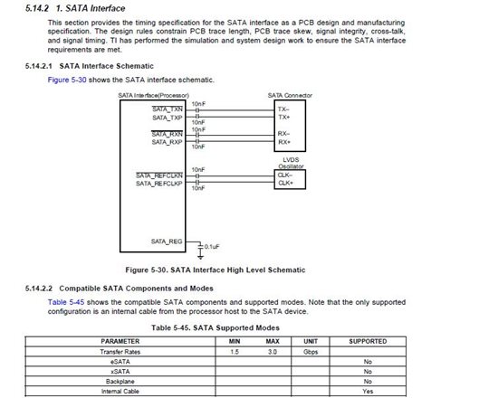

I am looking to use the SATA port of the L138 with an embedded mSATA SSD module. Due to space constraints, I would like to eliminate the SATA cable and route directly from the L138 to the mSATA module. According to the data sheet, the only SATA supported mode is to use a cable between the L138 and the module. Is this true, or with proper layout, could I route directly between the two devices?

TI provides PCB layout specifications in the device datasheets for the following interfaces, eliminating the need to perform electrical analysis:
Note:
Make sure to follow the Layout Specifications for the Critical Interfaces like SATA - Refer the datasheet.
The below wiki articles might be help for SATA design
http://processors.wiki.ti.com/index.php/TI_SATA_FAQ
http://processors.wiki.ti.com/index.php/OMAP-L138_Hardware_Design_Guide
http://processors.wiki.ti.com/index.php/OMAP-L13x_/_C674x_/_AM1x_Schematic_Review_Checklist
You can find the routing details in the section "Routing Specifications" at the datasheet of OMAP-L138.
