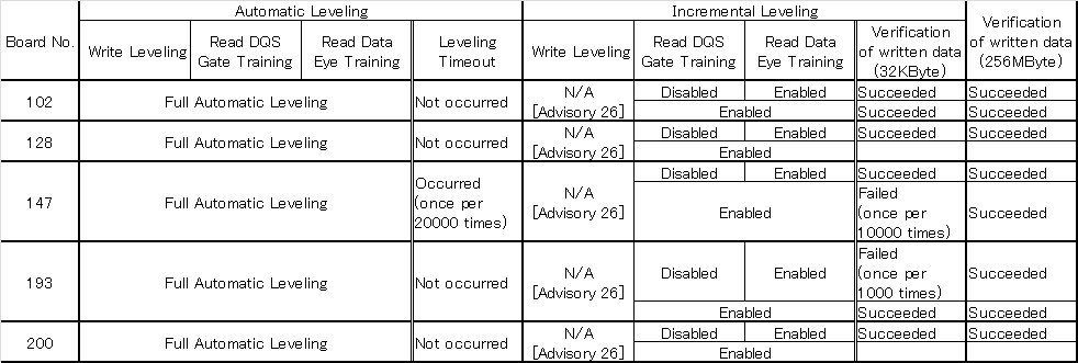

    I have some more questions.
    For Workaround 3 in Advisory 9, Incremental leveling is used only for the Read Data Eye Training.
    In the Application Note, Incremental leveling is used for both the Read DQS Gate Training and the Read Data Eye Training.
    For the more optimum leveling, should both the Read DQS Gate Training and the Read Data Eye Training be performed?
    For Workaround 3 in Advisory 9, if desired, the initialization routine can disable the Incremental leveling after it works.
    In the Application Note, it is highly recommended for long-term DDR3 operation stability at the higher operating rates that the Incremental leveling occurs periodically during normal operation.
    KeyStone DDR3 Initialization (Rev. A)
    http://www.ti.com/lit/an/sprabl2a/sprabl2a.pdf
    3 Leveling Execution
    For the more optimum leveling, should the Incremental leveling occur periodically during normal operation?
    Daisuke
    Some custom boards have the DDR3 issue. After initialization, the written data are verified. The following table shows those worst cases.
    For the more optimum leveling, after the Full Automatic Leveling, the Incremental Leveling with the Read DQS Gate Training and the Read Data Eye Training should be used. But this leveling mode may fail. Which of the leveling modes should be used?
    Please see DDR3Init() in the attached source file for the initialization sequence. Does it have any mistake?

    For our boards, the Full Automatic Leveling can reduce the frequency that an error occurs in comparison with the Partial Automatic Leveling. The Incremental Leveling is used for workaround associated with Advisory 9.
    Here is the latest test result for the Incremental Leveling after the Full Automatic Leveling.
    It can detect all errors to verify the written data of the 32K bytes after at least 64 times of the Incremental Leveling was performed at end of an initialization routine, and, in the case of an error, it can avoid this problem to perform an initialization routine again.
    However, because the continuous incremental leveling reduces bandwidth our customer does not want to use it.
    Please tell me the procedure to disable the Incremental Leveling after at least 64 times of it was performed.

    This problem seems to have been cleared. When only the Partial Automatic Leveling is used, any error have not occurred.
    We made many mistakes for our PHY_CALC. The fatal mistake is that the trace length of each byte lane was not input into the row corresponding to them. Our latest PHY_CALC is attached below.
    6471.DDR3 PHY Calc v10_20140106.xlsx
    If any problem occurs again I report it.
