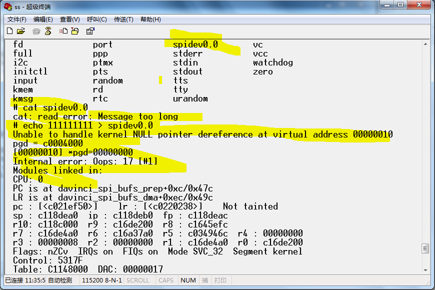

I want to use the spi0 for spidev, but when i modify /arch/arm//mach-da8xx. I can find /dev/spi0.0  ,it can not use
what i do is this ,but it is wrong ? who can help me and tell me why? thank you

  • I am sorry to trouble you, my problem is that:
    Also in the menuconfig he added support for SPI and Device Drivers ---> SPI support ---> User mode SPI device driver support
    but when i test it using linux+v2.6.32/Documentation/spi/spi_test.c
    "Unable to handle kernel NULL pointer dereference at virtual address 00000010 .... "
    Can you tell me why it become wrong?
    Have you modified the "spi_test.c" for spidev1.0 node ?
    Did you get "spidev.10." node or some thing like that ?
    Which SPI bus are you using ?
    As I told you, SPI0 bus use the SPI memory and try to use "SPI1" bus.
  •  Thank you for your reply.
    but spi1 is for uart2 for console (hypertrm) , so I can not use spi1. I modified the "spi_test.c" for spidev0.0 node , and get "spidev0.0." node in /dev. My kernel is 2.6.18, it's spi.c is below:
    I want to use spi0 , what can I do?
    [\quote]
    Share the log when you get "unable to handle" error.
    When you test this code (spi_test.c) you have to short the SPI0_MOSI and SPI0_MISO pins for loop back.
    Able to see any toggling (signal transition) on SPI0 bus say SPI0 CLK, SOMI and SIMO pins through CRO ?
  • Also please make sure that you have disabled "EQEP" support because it is muxed with SPI0.

    # cd ..
    # ls
    bin          g_serial.ko  linuxrc      proc         spidev_test  usr
    dev          init         lost+found   root         sys          var
    etc          lib          mnt          sbin         tmp
    # cd dev
    # ls
    MAKEDEV         loop            rtc0            usbdev1.1_ep00
    bus             mem             shm             usbdev1.1_ep81
    console         net             snd             usbdev2.1_ep00
    core            null            sndstat         usbdev2.1_ep81
    fd              port            spidev0.0       vc

    # cd ..
    # ls
    # ./spidee
    -sh: ./spidee: not found
    # ./spidev_test
    spi mode: 0
    bitpgd = c0004000
    s per word: 8
    m[00000010] *pgd=00000000ax speed: 500000
     Hz (500 KHz)
    Internal error: Oops: 17 [#1]
    Modules linked in:
    CPU: 0
    PC is at davinci_spi_bufs_prep+0xc/0x47c
    LR is at davinci_spi_bufs_dma+0xec/0x49c
    pc : [<c021ef70>]    lr : [<c0220258>]    Not tainted
    sp : c1187ea0  ip : c1187eb0  fp : c1187eac
    r10: c1186000  r9 : c16cb200  r8 : c1192260
    r7 : c16cb4a0  r6 : c16a4760  r5 : c03493a0  r4 : 00000000
    r3 : 00000008  r2 : 00000000  r1 : c16cb4a0  r0 : c16cb200
    Flags: nZCv  IRQs on  FIQs on  Mode SVC_32  Segment kernel
    Control: 5317F
    Table: C05F0000  DAC: 00000017
    Process dm_spi.0 (pid: 180, stack limit = 0xc1186258)
    Stack: (0xc1187ea0 to 0xc1188000)
    7ea0: c1187efc c1187eb0 c0220258 c021ef74 00000000 c1187f56 c16cb200 00000001
    7ec0: 00000001 ffffffff c1187f24 01c41000 c1187efc c1192260 00000000 c0521ecc
    7ee0: c021f5b0 c16cb4a0 c16cb200 c1186000 c1187f34 c1187f00 c021eb28 c022017c
    7f00: c16cb4d4 00000000 c1187f54 20000013 c16a4720 c1186000 c16cb4a4 00000000
    7f20: c021e9a4 c16cb4a0 c1187f6c c1187f38 c0063068 c021e9b4 c16a4738 c16a4728
    7f40: 00000002 00000000 c16a4728 c1186000 c16a4720 c16a4730 00000002 c1187f84
    7f60: c1187fcc c1187f70 c0063870 c0062f98 00000001 00000000 00000000 00010000
    7f80: 00000000 00000000 c15066c0 c004b468 00100100 00200200 ffffffff ffffffff
    7fa0: 00000000 c16a4720 c1186000 c0063768 c0443dd8 00000000 00000000 00000000
    7fc0: c1187ff4 c1187fd0 c0066858 c0063778 ffffffff ffffffff 00000000 00000000
    7fe0: 00000000 00000000 00000000 c1187ff8 c00531e0 c0066780 bc7f1dc5 6f3d9573
    Backtrace:
    [<c021ef64>] (davinci_spi_bufs_prep+0x0/0x47c) from [<c0220258>] (davinci_spi_bu
    fs_dma+0xec/0x49c)
    [<c022016c>] (davinci_spi_bufs_dma+0x0/0x49c) from [<c021eb28>] (bitbang_work+0x
    184/0x2d8)
    [<c021e9a4>] (bitbang_work+0x0/0x2d8) from [<c0063068>] (run_workqueue+0xe0/0x17
    0)
    [<c0062f88>] (run_workqueue+0x0/0x170) from [<c0063870>] (worker_thread+0x108/0x
    144)
    [<c0063768>] (worker_thread+0x0/0x144) from [<c0066858>] (kthread+0xe8/0x128)
    [<c0066770>] (kthread+0x0/0x128) from [<c00531e0>] (do_exit+0x0/0xa24)
     r7 = 00000000  r6 = 00000000  r5 = 00000000  r4 = 00000000
    Code: e89da800 e1a0c00d e92dd800 e24cb004 (e5923010)
    sorry to trouble you again.
    I had done it fellow you,but something maybe is also wrong.
    the question is also no answer.
    the boot up log and the Schematic Diagramis in below:
    thank you again.
