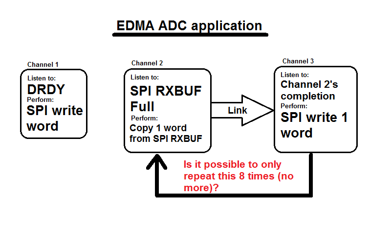

We have the following application: OMAP L132 reading ADC samples via SPI.
The ADC produces a single data ready (DRDY) interrupt and then the C6748 core starts to read 8x16bit words via SPI.
We are interested in changing this low level driver, which takes a lot of CPU time, to an EDMA application.
Is it possible to perform such transfer using EDMA? We couldn't find anythng suitable on the TRM.
Thank you in advance.
Yeho.

  • Hi Sivaraj,
    Thank you for your quick response.
    I've already went through the guides and examples you've posted, but still have something that I don't grasp:
    Our application has only 1 DRDY trigger after which 8 words must be read - but not at once:
    The 8 words must be read separately: a single word must be written to the SPI TX buffer, then
    we wait for the SPI_RXBUF_FULL event. so far everything is OK.
    But if we only have 2 EDMA channels - one triggered by the SPI_TXBUF_EMPTY and one triggered by SPI_RXBUF_FULL,
    then these EDMA transactions will be triggered endlessly (once the TXBUF is empty - a new word will be sent, and once the RXBUF is full a new word will be read from it) because even after 8 words were read, any new word on TXBUF will trigger an SPI transmission of dummy zeros but the SPI_RXBUF_FULL event will still be triggered.
    I still don't understand how to end this loop.
    Edit: It seems that this type of application requires a strong CPU intervention in the process - once a word was read from SPIBUF, a completion interrupt must signal the CPU, and the CPU must hold an internal counter to decide whether 8 words have already read or not, and then to break the loop by disabling these EDMA channels until another DRDY signal comes in. Am I right here?
