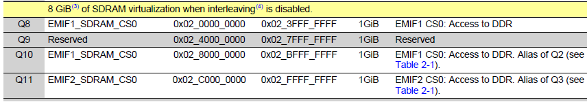

Customer want to connect 3GB memory to Jacinto6.
So, below configuration is able to use ?
EMIF1       8Gbit-DDR3 (x16) x 2 chips : 2GByte(32bit width)
EMIF2       4Gbit-DDR3 (x16) x 2 chips : 1GByte(32bit width)
We have following in Data Manual, so above configuration has no problem.

  • Hi Mitsui-san,
    I think it's possible. I couldn't find any restrictions indicating the above configuration is not possible. However, you should take into account the following:
    1. The DMM_LISA_MAP_i registers are configured to enable interleaving.
    2. The MA_LISA_MAP_i registers are configured with the same settings as DMM_LISA_MAP_i.
    3. The upper 1GB of EMIF1 will be accessible only by the MPU as 2GB is the maximum memory capacity shared among the system (in your case interleaved on EMIF1 and EMIF2).
    4. The high-order fixed interleaving of the MPU_MA must be disabled by keeping the MA_PRIORITY[8] HIMEM_INTERLEAVE_UN bit to its reset value of 0x0.
    5. The upper 1GB of EMIF1 will be accessible by the MPU at address range Q8.
    6. There is also the following statement in the TRM: "Heavy use in high memory space under noninterleaved configuration affects the balancing of the system access in lower-order memory."
    7. The MPU_MA Firewall (MA_MPU_NTTP_FW) must be properly configured. I mean, to not block the MPU accesses to Q8.
    In addition, I think different capacity for each EMIF is OK as the DMM TRM section shows an example of connecting 256MB to EMIF1 and 512MB to EMIF2 (512 MB interleaved and 256 MB noninterleaved). The exact section name is "15.2.4.2.2 Case 2: Use of Two Memory Controllers".

  • Agree with Dobrins comments above.
    One more datapoint re, un-equal memory capacity on EMIF1 and EMIF2 - The original J6 EVM had 0.5 GB on EMIF1 (2 pieces of 2 Gbit DDR3 arranged x16 wide plus another x8 device for ECC parity) and 1.0 GB on EMIF2 (4 pieces of 2 Gbit DDR3 arranged x8 wide) so this is not a problem.
    Be aware of the SW impact using more than 2GB since the OS needs to use LPAE modes for ARM core to access above 2 GB. Also, other chip resources (other cores and DMAs) cannot access the space above 2GB so the operating system must take this into account.
