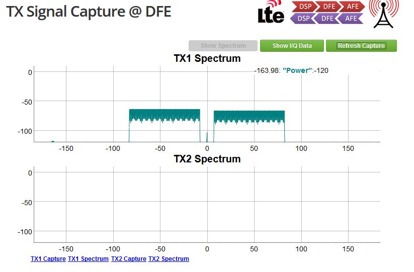

  3. When I’m using the JESDlpbk configuration I see that I managed to load the custom signal into the TX DSP but the TX DFE shows nothing. What might be the reason for that? How can I fix it?

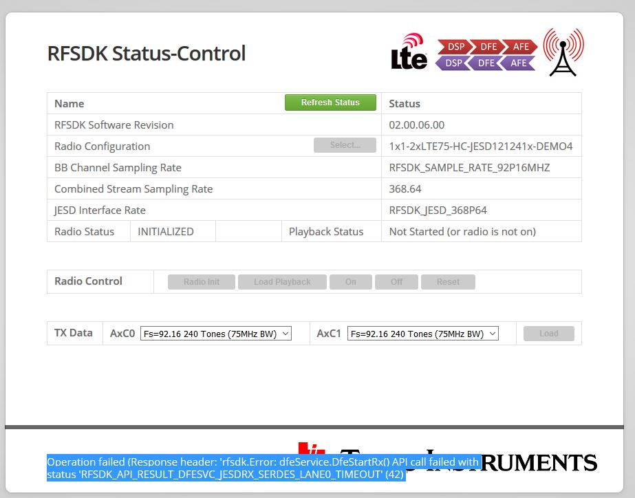

  4. When I’m using the normal demo4 configuration I receive this message in the command prompt:
root@k2l-evm:/usr/share/radio/tests# radio on 18300 300
Turn the AFE on, and check its JESD RX status. Then press RETURN.
Traceback (most recent call last):
  File "/usr/bin/radio", line 108, in <module>
    command.onecmd(' '.join(sys.argv[1:]))
  File "/usr/lib/python2.7/cmd.py", line 221, in onecmd
    return func(arg)
  File "/usr/lib/python2.7/rfsdk/command.py", line 1161, in do_on
    self.radio.radio_on(ul, dl)
  File "/usr/lib/python2.7/rfsdk/radio.py", line 466, in radio_on
    self.dfe.dfe_on_rx()
  File "/usr/lib/python2.7/rfsdk/platform/TCI6630K2L.py", line 195, in dfe_on_rx
    self.dfeS.DfeStartRx(0)
  File "/usr/lib/python2.7/dfe/service.py", line 478, in DfeStartRx
    raise rfsdk.Error('dfeService.DfeStartRx() API call failed with status %r (%d)' % (status, result,))
rfsdk.Error: dfeService.DfeStartRx() API call failed with status 'RFSDK_API_RESULT_DFESVC_JESDRX_SERDES_LANE0_TIMEOUT' (42).
I also receive this message (42) when trying to use the GUI option.

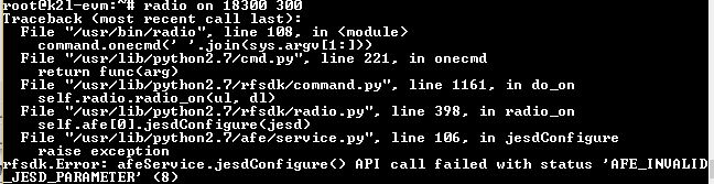

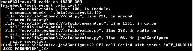

  • I managed to go forward and now I get this message:
    root@k2l-evm:~# radio on 18300 300
    return func(arg)
    File "/usr/lib/python2.7/rfsdk/radio.py", line 398, in radio_on
    self.afe[0].jesdConfigure(jesd)
    File "/usr/lib/python2.7/afe/service.py", line 106, in jesdConfigure
    raise exception
    rfsdk.Error: afeService.jesdConfigure() API call failed with status 'AFE_INVALID_JESD_PARAMETER' (8)

    3.When I’m using the JESDlpbk configuration I see that I managed to load our custom signal into the TX DSP but the TX DFE shows nothing. What might be the reason for that? How can I fix it?
     The webpage, captures for DFE@Tx, DFE@rx/Fdbk – random 4K samples from DFE.  (may not display TDD data properly).   The webpage, captures for DSP@BBTx, DSP@BBRx – the first 4K samples time synchronized to DL sync.  (your Tx and Rx data have to be within first 4K samples to show on web display)
     If you are using a TDD gated waveform, the capture for this display is random, works for FDD  not TDD.   You can capture the DSP @ BBRx, and see if that captures, or follow the scripts in the new email to capture the full 10ms BBRx data and analyze it.

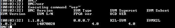

  • Nitin,

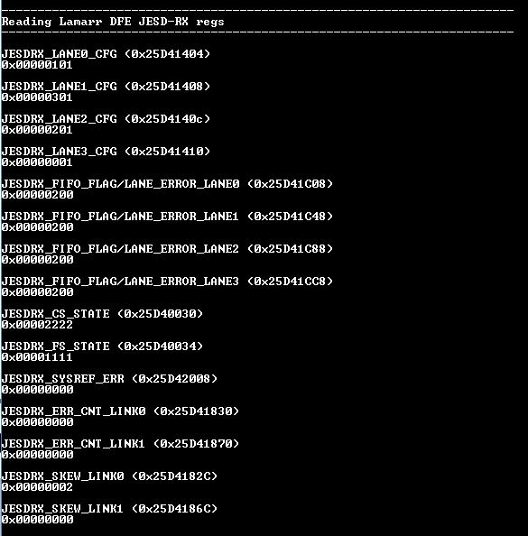

    Here are the version information of the Lamarr EVM:
    Here is the error that I'm getting with the DLC card (both in the CMD & GUI) while using normal RFSDK demo 4:

  • Hi Eran,
    As discussed earlier, the TX1 and TX2 JESD lanes are swapped on Rev 2.0 EVM. There are two ways to workaround this:
    (1) Hardware Mods to rewire the lanes on a rev 2 EVM or
    (2) Lane reassignment in the DAC configuration.
    Going with option 2, I have attached a modified DAC38J84 config to work with Rev 2.0 Lamarr EVM. Please use this for the DAC low level configuration (step 9 of section 3.1.3: DAC38J8x EVM GUI).
    Regarding your second question: We have tested the demo with the ADC32RF80 configuration files listed in the Getting Started Guide. Can you please try it out with the complete setup once the JESD errors go away with the attached DAC config? I'll check the LED settings from a working setup and let you know.

  • Nitin,
    Thank you for your help.
    I've used the new cfg but I'm still getting the same error:
    Could you please advise? -Please note that my EVM version is: 1.0.2.1.
    Eran.
  • Hi Eran,
    We're looking into this and will get back to you asap. Thanks for your patience.
    -Nitin

  • Hello Nitin,
    I reinstalled the MCSDK & RFSDK on the EVM as you suggested (please note that I chose: lamarr-evm-demo4-mcsdk3147 default as the Target Board Configuration).
    These are the files that the GUI creates when loaded after boot:
    After reinstalling the RFSDK I get this error when trying to turn radio on:
    What could be the problem now?
    Eran.
  • Hi Eran,
    The JESDRX_SERDES_LANE_TIMEOUT points towards a problem on the ADC side. You mentioned earlier that the values you read back after programming the ADC32RF45 EVM were not the same as given in the DDC configuration tab in the getting started guide, This should not be the case and indicates that the ADC is not being programmed correctly.

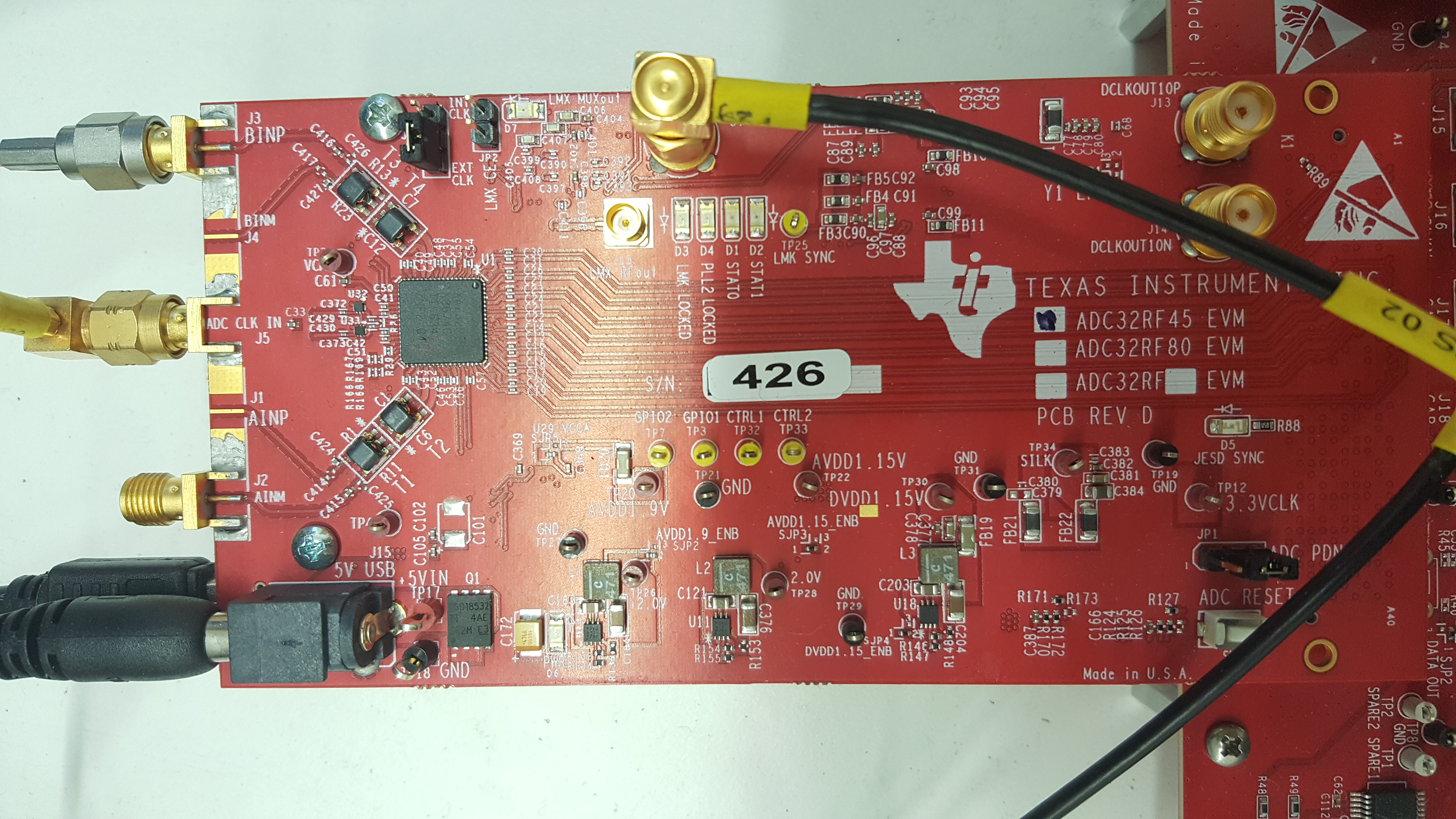

  • Eran,
    On my EVM, only power led was on. The LEDs for the clocks are not on either. But mine is working fine.
    What kind of EVM do you have? Mine is ADC32RF80 which has DDC enabled.
    Michelle
  • Eran,
    Also please send the rev number of the EVM.
    In terms of the clock connection, please follow the GSG and to make sure J5 and J7 on ADC EVM are connected with clock input:
    "Use two length-matching SMA cables, one to connect from J15 of the DLC to the LMK CLKIN (J7) of the ADC32RFxx EVM; one to connect from J16 of the DLC to the ADC CLK IN (J5) of the ADC32RFxxEVM"
    Before loading different configuratios to DLC, USB cable should be unplugged to do a full power cycle.
    Michelle

  • Hello Michelle,

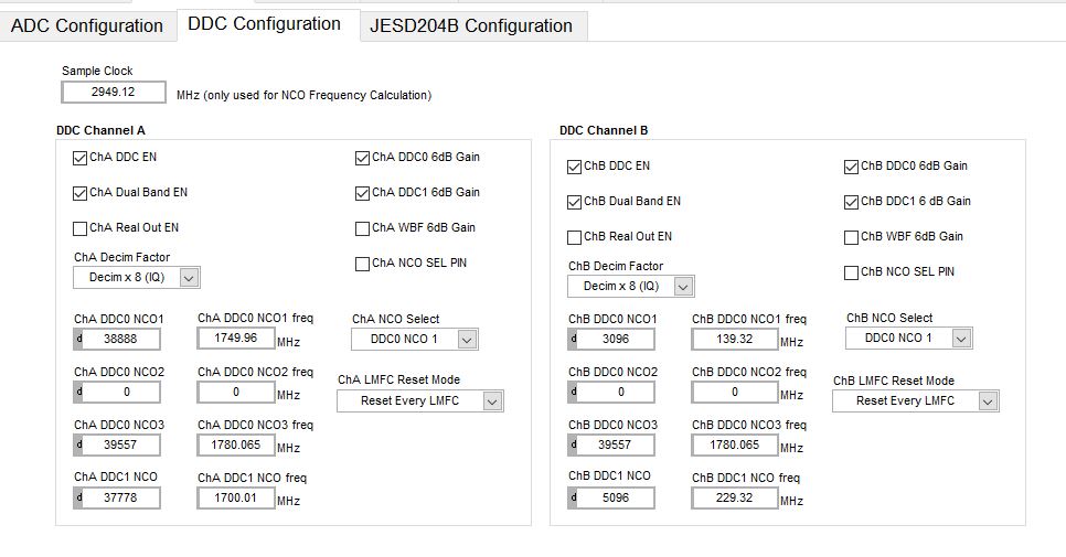

    I'm using the ADC32RF45 card (PCB REV D and 4 is written on the chip itself) and the clk cables are connected as you described. The DLC card has 2 green lock LEDs and the only LED on the ADC card that is on is the power LED.
    I followed your guide but after pressing the read all I never get CHA and CHB DCC EN selected no matter how many time I press it or reconfigure the card.
    Thank you for your assistance,
    Eran.
  • Eran,
    I know for sure that ADC32RF80 has DDC enabled. ADC32RF45 however can havd DDC by-passed. Where did you get the ADC EVM?

    Got feedback from ADC engineer and here are two things we need you to help check:
    1. For ADC32RF45, if it's pre-production, it's DDC by-pass mode only. However, the final silicon of ADC32RF45 supports both bypass and DDC modes. To determine what version.  The lot trace code marking on the top of the ADC right under the part number is what we would need to see to know if the device is preproduction silicon and if it is whether the device is bypass only mode or DDC only mode. Please take a snapshot and send to us.
    2. If the SPI programming of the ADC fails and they always read back zero from all the page registers, then likely the ADC is not seeing SYSREF or the sample clock.   The common mode voltage of SYSREF changed going to final silicon, and if that is wrong on the hardware then you will fail to configure the ADC. When you read back the register value, are they all zero?

  • Eran,
    We have got confirmation that the one you have is the final silicon. It's not clear why you have difficulty programming ADC. Nitin will contact you regarding replacing/sending new board.
    Here's a few things I can think of for you to double check:
    1. Make sure GUI is downloaded from TI.com (latest revD). Use config in the "DDC Mode" folder
    2. Make sure to push SW1 to reset ADC before loading ADC cfg
    3. May try setting clock from signal generator 6 dB higher
    4. Registers to read are under ADCxxx group and the values are listed in the 6th column of register map
    5. When registers are zero, ADC32RFxx -- DDC configuration Channel is not selected as well?
    6. Is the board being power cycled between tests?
    Sorry if none helps. We'll hope new board you'll receive work then.

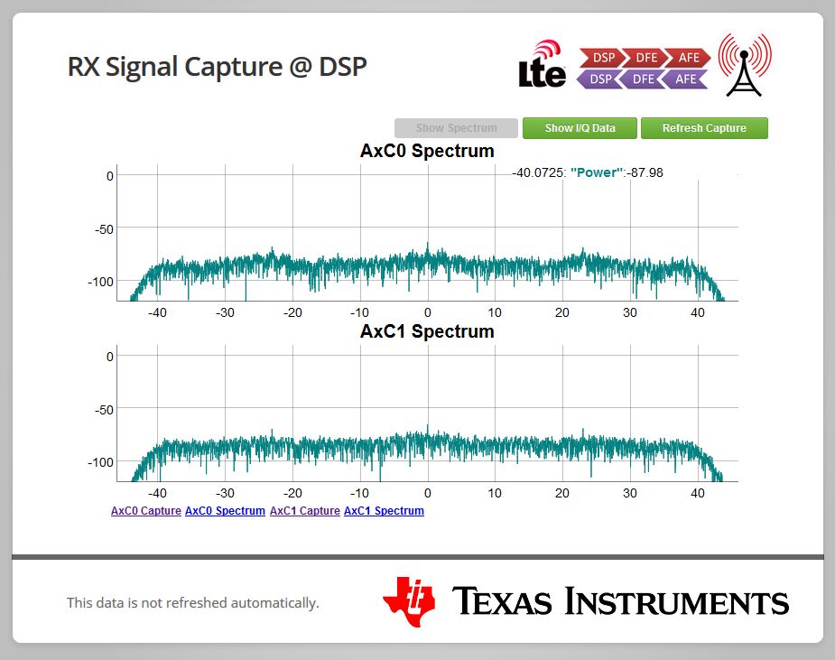

    I've received the ADC32RF80, I can now configure it and it seems that the demo is working properly with no errors.
    I've tried testing the custom signal according to your document. The loop-back is working well according to the document. But, the part that we're interested in is to test the custom signal after the entire RF loop as well (DAC-ADC RF loop). I'm unable to receive good results (I don't get any signal in the RX with the custom signal not being in loop-back mode) even though the normal demo4 of the RFSDK is working properly (I see RX results as expected with the RFSDK). Could you please give me some instructions on how to properly do that?

    a) when you run the standard Demo4 on the DAC, do you have
         you can look at the webpage Tx, this is the DPD input capture (1*)
          the spectrum analyzer Tx output plot, please capture (2*)
          when the DAC output -> filtered -> ADC input
          the ADC downconverts RF to IF, the Rx and Feedback DFE convert IF to 0IF, to the BBRx outputs.
          (note in FDD waveforms, you can see the BBRx on the webpage 3*)
          after capturing the BBRx 10ms data,  for each channel, ("playback capture" in RFSDK User Guide), you copy the files created to a host PC, and analyze the
          BBRx data, you can evaluate the spectrum and time series of the data 4*)
    b)   when you are doing the JESD loopback, there is no analog output.
          if this is an FDD signal you can use the webpage 1*
          if this is an FDD signal you can use the webpage 3*
          you can do a playback capture, and plot the 10ms data 4*
    c)  Custom waveform, this is a TDD waveform, the Tx out (1*) may not work do to when we collect the capture buffer,
          if the DAC configuration is correct, you should have with a 10ms period, and triggering the spectrum analyzer on envelope of the signal, you should capture
           a Tx output.   the web display of BBRx (3*) may not work becuase we are looking at 4K of data, possibly while Tx is not on.
          if you do the playback capture command, collect the files, (4*)  if you had a DAC output, and the cable and filter are still there for ADC, we expect to have a
          gated (TDD) Rx signal.

    5. Attached is the configuration for the ADC - so you can make sure I configurated the card correctly):
    6. Attached is an example of demo4 TX DFE output:
    Thank you for your help,
    Eran.

  • Hello Michelle & Joe,
    I tried programming the ADC after pressing the ADC reset on the GUI.
    Now I receive data from the ADC but it's noise:
    What do you make of this?
    Eran.
  • Hi Eran,
    What did you do differently this time? This can give us a clue of the problem.
    Can you use the shell script given during webex session to check JESD status?
    When nothing was captured, we saw JESD RX FIFO error. With some noise data, the JESD status could change, let us know.
    Another thing: remember you showed that the ADC GUI do not save the clock/NCO number after GUI is closed?
    Here's what I saw on my PC: after ADC is programmed and clock/NCO all set, GUI is closed. Then I re-open it. The default sample rate is 3000, so I need to re-type 2949.12, once this is typed, NCO values are automatically updated. This latter part, I don't remember seeing on your PC. Please confirm.
    I saved the cfg after I made sure everything is working. I attached the cfg here. Please also save your cfg after following user-guide ADC program procedure. You can compare to see if there's difference or send the cfg file to us.
    Thanks and Regards,
    Michelleadc32rfxx_save.cfg

    Another concern is the clock output from DLC board. Can you measure the power level from J15 and J16 respectively? For your reference, I got -4.2dBm from each port.
    Thanks and Regards,
    Michelle
  • GSG_Lamarr_ADC32RFxx.docxEran,
    In discussing with HSP team, the ADC32RF80 EVM has high power input requirement for clock source. Although -4dBm clock worked in our system, it's at a marginal level. To minimize the loss, the SMA cable used for clock should be short and thick.
    There's another way to eliminate DLC clock to ADC. It's using external signal generator to provide clocks to ADC. The whole system need to be synced so 10MHz from signal generator will be the input to Lamarr clock chip. I tested and put together a document describing how to run the test.
    Please follow the procedure in previous emails before starting this method.
    Michelle

    I measured on the DLC: J15 - (-3.9dBm), J16 - (-3.7dBm).
    As for your last recommendation, it will take me some time to acquire this splitter, in the mean time I would appreciate if you could check if this test will work on the LAMMAR EVM V2 or do I need to perform any change to it.
    Thank you and best regards,
    Eran.

    Attached is MY ADC cfg file.
    Best adc32rfxx_eran.cfgregards,
    Eran.

    After trying to configure the ADC & DAC. I think the problem is in the JESD configuration.
    If I follow the DEMO4 guide (I first configure the DAC and then the ADC) I get write stub error.
    If I configure the DAC again after the ADC I don't get that error but I don't see anything in the RX and the ADC JESD configuration is corrupted (all zero).
    I think the problem is me using the Lamarr V2 which has different layout to the JESD. This causes me to use a different configuration file for the DAC which the ADC JESD configuration doesn't support (perhaps an issue with the SysRef specifically).
    In this case I think we have 2 options: either using a different ADC configuration file (if you could supply one) which supports the Lamarr V2 or arrange for me to use the Lamarr V3.
    I would appreciate you looking into this theory.
    Eran.

    When you configure DAC, you will need to press the 3rd button on the front page, otherwise you'll have JESD TX error. We didn't have this problem, but I put that in the latest GSG attached. TIDUC58.pdf
    When the DAC is correctly programmed, you'll still have RX JESD error which you can run the jesd status check script to verify.
    The difference between rev2 and rev3 is on the tx lane mapping, that's why we need different configuration files for the DAC. However, RX side is mapped the same and therefore I don't think you'll need a different configuration file.

    After replacing the Lamarr to V3, I don't get the JESD errors.
    Reading Lamarr JESD SERDES status regs
    LANEx_CTL_STS regs - RX_OK=bit1, RX_LOSS=bit0
    JESD LANE0_CTL_STS (0x02325FE0)
    0xF2C0F2F2
    JESD LANE1_CTL_STS (0x02325FE4)
    0xF2C0F2F2
    JESD LANE2_CTL_STS (0x02327FE0)
    0xF2C0F2F2
    JESD LANE3_CTL_STS (0x02327FE4)
    0xF2C0F2F2
    JESD_SERDES PLL_CTRL regs - TX_PLL_OK=bit28, RX_LN_1_0_OK=bits9_8, RX_LN_1_0_SD_                                                                                                                                                             STATE=bits1_0
    JESD_SERDES_0 PLL_CTRL (0x02325FF4)
    0xF0000303
    JESD_SERDES_1 PLL_CTRL (0x02327FF4)
    0xF0000303
    Reading Lamarr DFE JESD-RX regs
    JESDRX_LANE0_CFG (0x25D41404)
    0x00000101
    JESDRX_LANE1_CFG (0x25D41408)
    0x00000301
    JESDRX_LANE2_CFG (0x25D4140c)
    0x00000201
    JESDRX_LANE3_CFG (0x25D41410)
    0x00000001
    JESDRX_FIFO_FLAG/LANE_ERROR_LANE0 (0x25D41C08)
    0x00000000
    JESDRX_FIFO_FLAG/LANE_ERROR_LANE1 (0x25D41C48)
    0x00000000
    JESDRX_FIFO_FLAG/LANE_ERROR_LANE2 (0x25D41C88)
    0x00000000
    JESDRX_FIFO_FLAG/LANE_ERROR_LANE3 (0x25D41CC8)
    0x00000000
    JESDRX_CS_STATE (0x25D40030)
    0x00002222
    JESDRX_FS_STATE (0x25D40034)
    0x00001111
    JESDRX_SYSREF_ERR (0x25D42008)
    0x00000000
    JESDRX_ERR_CNT_LINK0 (0x25D41830)
    0x00000000
    JESDRX_ERR_CNT_LINK1 (0x25D41870)
    0x00000000
    JESDRX_SKEW_LINK0 (0x25D4182C)
    0x00000001
    JESDRX_SKEW_LINK1 (0x25D4186C)
    0x00000000
    Reading Lamarr DFE JESD-TX regs
    JESDTX_LANE0_CFG (0x25D01404)
    0x00000001
    JESDTX_LANE1_CFG (0x25D01408)
    0x00000101
    JESDTX_LANE2_CFG (0x25D0140c)
    0x00000200
    JESDTX_LANE3_CFG (0x25D01410)
    0x00000300
    JESDTX_FIFO_FLAG_LANE0 (0x25D01C08)
    0x00000000
    JESDTX_FIFO_FLAG_LANE1 (0x25D01C48)
    0x00000000
    JESDTX_FIFO_FLAG_LANE2 (0x25D01C88)
    0x00000000
    JESDTX_FIFO_FLAG_LANE3 (0x25D01CC8)
    0x00000000
    JESDTX_SYNC_STATE (0x25D00030)
    0x00000022
    JESDTX_SYSREF_ERR (0x25D02008)
    0x00000000
    JESDTX_ERR_CNT_LINK0 (0x25D01828)
    0x00000000
    JESDTX_ERR_CNT_LINK1 (0x25D01868)
    0x00000000
    JESDTX_FIRST_SYNC_REQ (0x25D00034)
    0x00000011
    But, When trying to receive a signal, I get a strange result (and its consistence):
    Is this problem familiar to you?
    Eran.

  • Eran,
    Since the JESD is good and you have valid signal as input, the possible problem would be
    1. ADC NCO setting (make sure you set both input clock (2949.12) and NCO value to it)
    2. Web GUI display -- make sure GUI refresshes. Try removing cookie and also load different data pattern, check if tx/rx refreshes
    Another thing you can check is to see the dfe rx node capture. This is another way to see if NCO is correctly setup.
    Michelle
